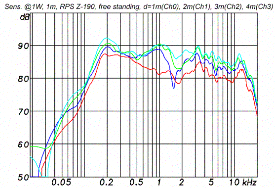

            Yup, here are measurements of the pro version of the RD75 from one of their white papers -- bottom to top, 1m to 4m. There's a huge null at 2m where mic distance equals line height and you really need to get out to 2x line height before things flatten out.

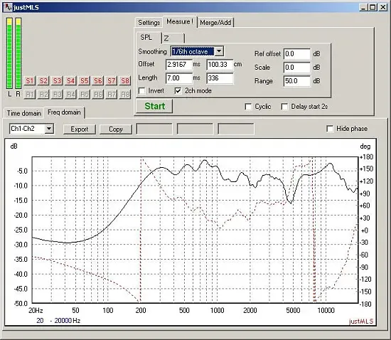

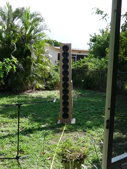

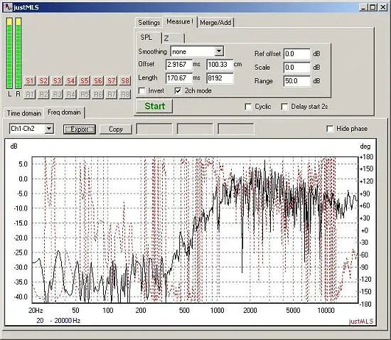

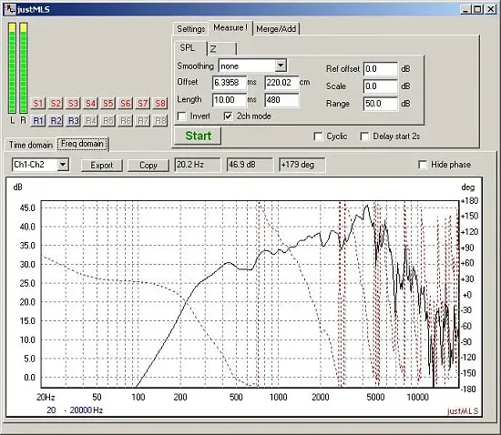

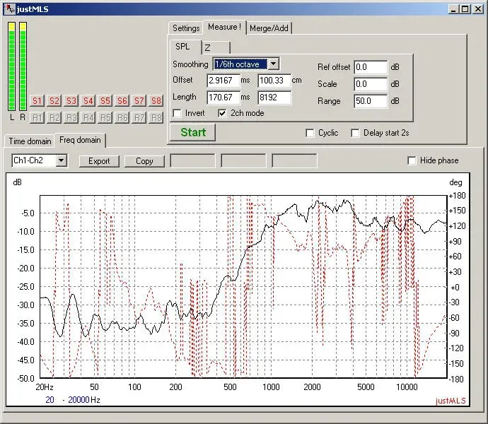

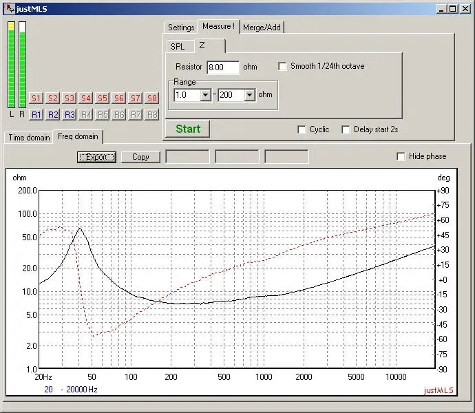

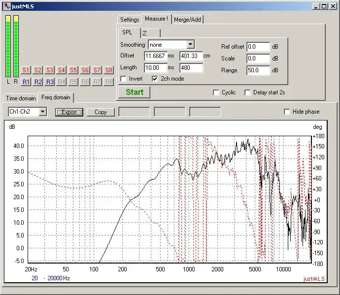

                  A new day, new measurements. After the morning lawnmowers and leaf blasters died down, I was able to get some 4 meter and 2 meter measurements. Here is what it looked like and an impedance sweep.

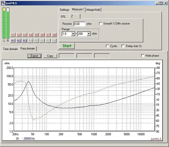

                  Impedance

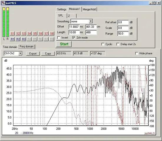

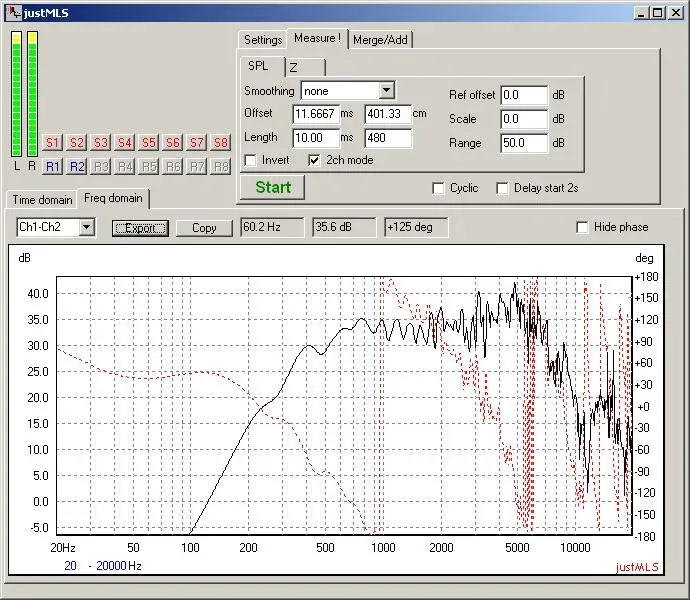

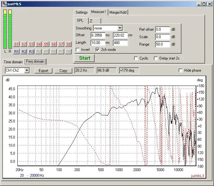

                    #234

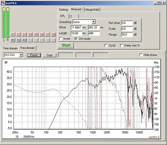

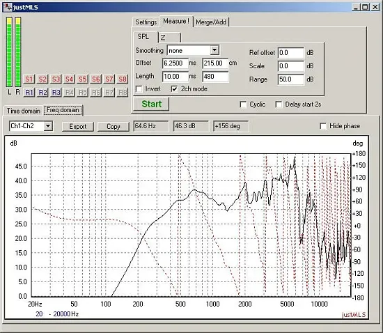

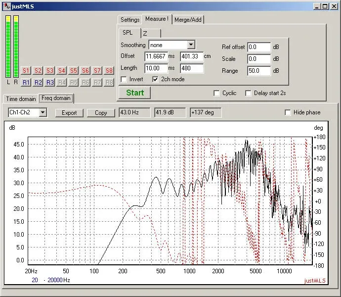

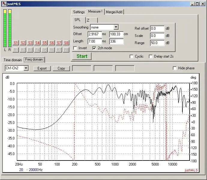

                    These are measurements taken at 4 meters distance, 90 dB SPL, 10 ms gate at heights of 30 inches, 44 inches, and 60 inches.
                    30 inch height.
                    44 inch height.
                    60 inch height

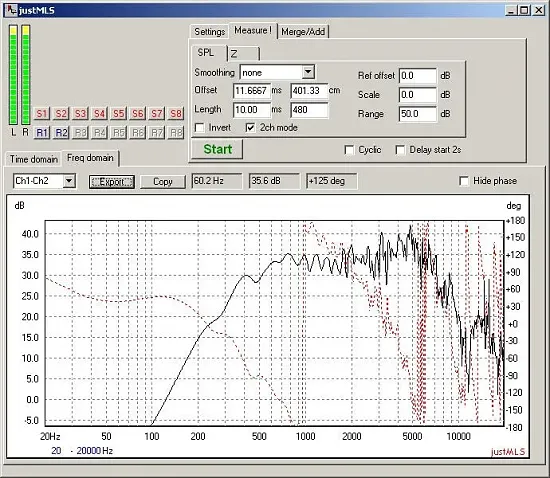

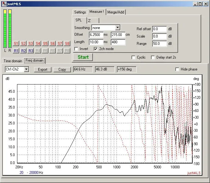

                      #235

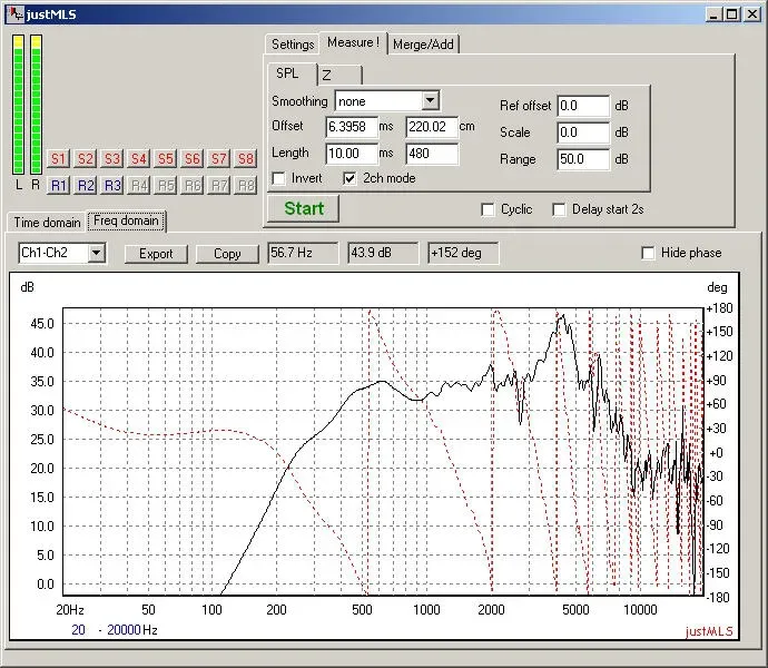

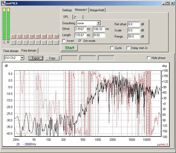

                      These are measurements taken at 2 meters distance, 90 dB SPL, 10 ms gate at heights of 30 inches, 44 inches, and 60 inches.
                      30 inch height.
                      44 inch height.
                      60 inch height.

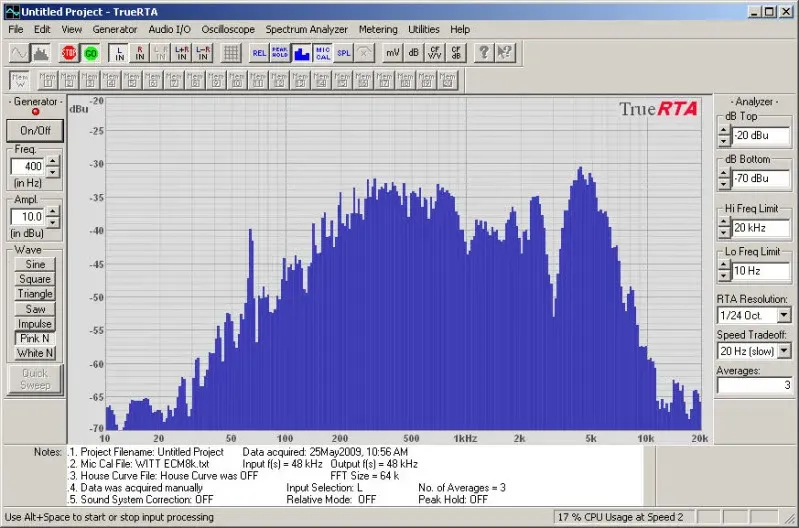

                        #236

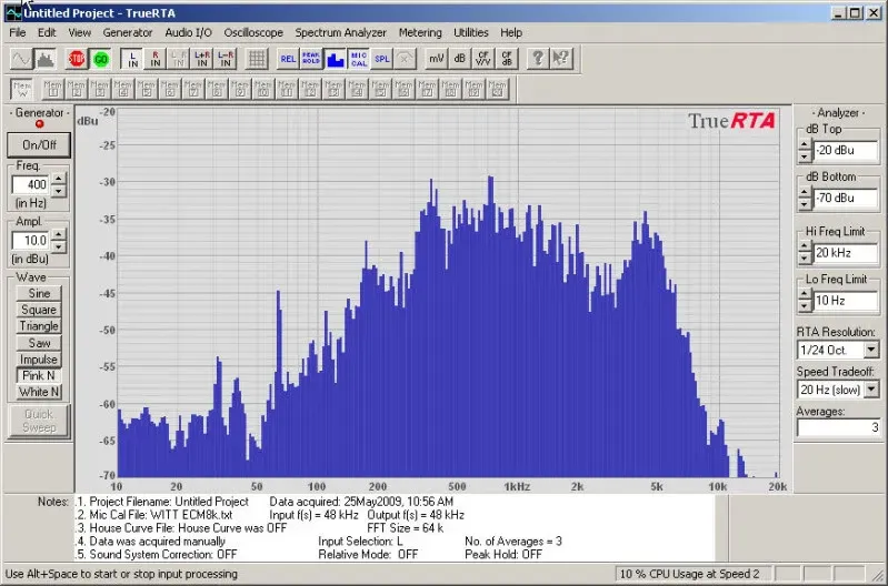

                        You're using the ECM-8000?
                        Just for comparison do a nearfield/farfield plot using TrueRTA
                        • chasw98
                          • 1360
                          #237
                          Yes, with Kim G calibration file.
                          Now you ask, I will set it up again in a little while! :B
                          • chasw98
                            • 1360

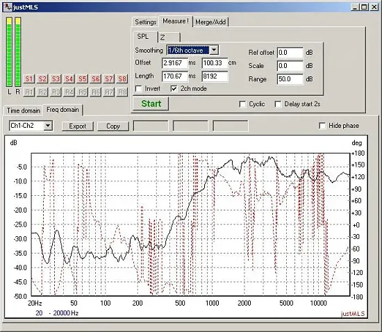

                            #238

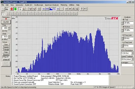

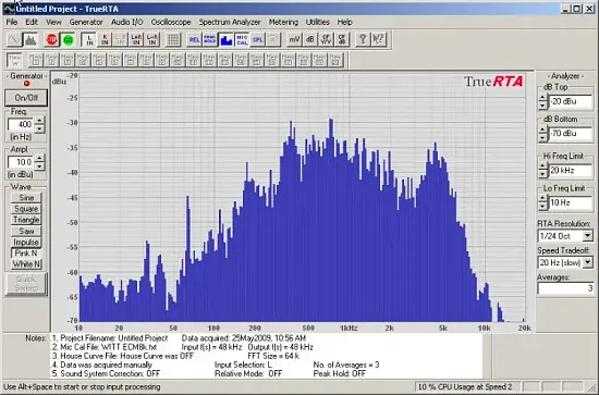

                            Here is TrueRTA at 4 meters and 40 centimeters.
                            4 meters.
                            40 centimeters.
                              #239
                              Ok shows similar stuff. Not an issue for what you're building given the intended 650Hz XO point.
                              If I get a chance later today I'll mount a single driver in a baffle and run some sweeps.
                                #240

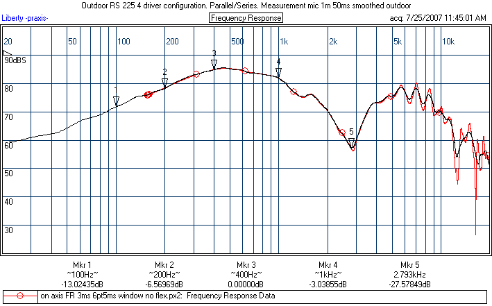

                                    I was thinking there was something inherently wrong with Chuck's plots until I ran across this one from Mark K's RS225 line array....

                                      Comb Filtering?

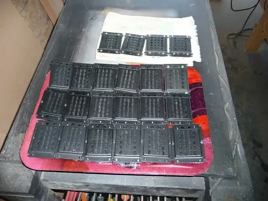

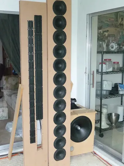

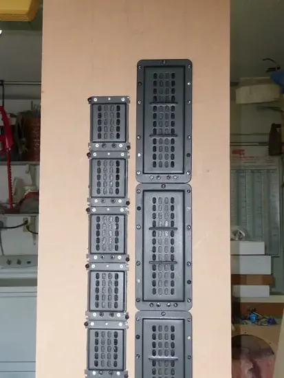

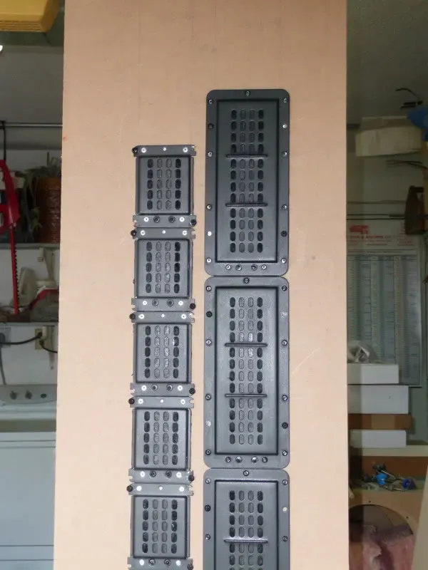

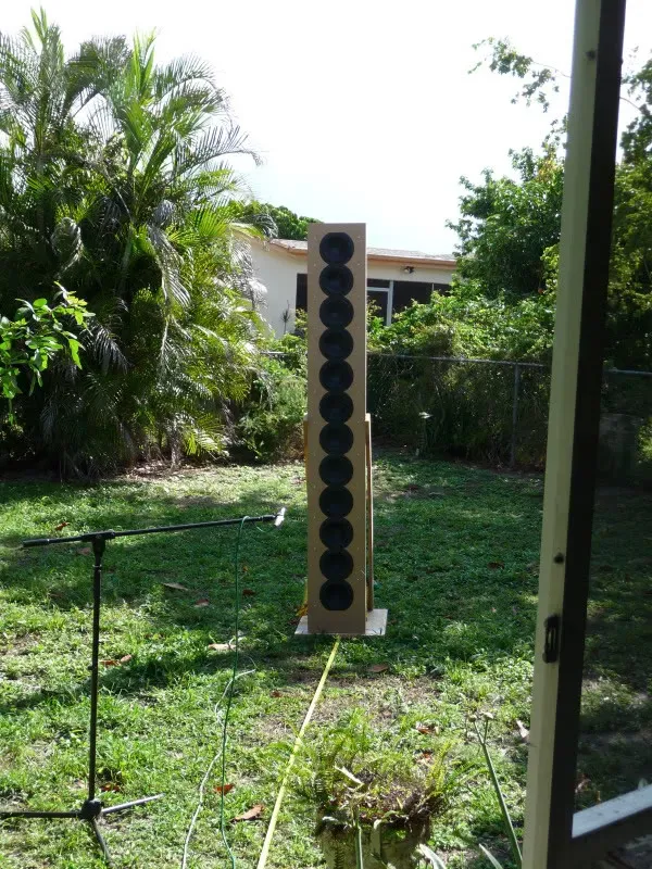

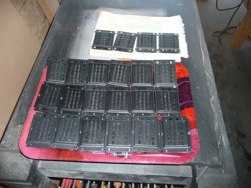

                                        It's the weekend and I'm back with more stuff..................

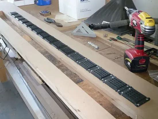

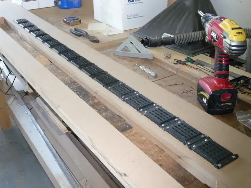

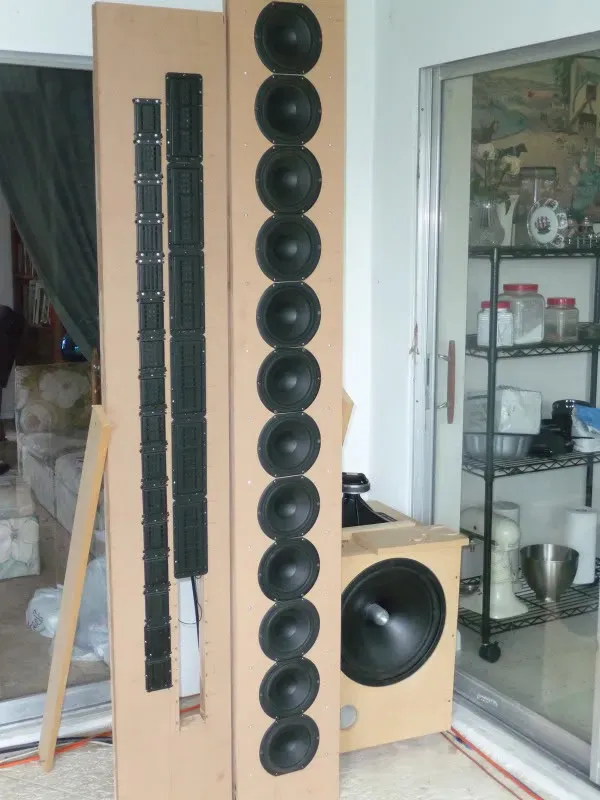

                                        I got 6 out of 8 Neo8's on Friday and also received 22 Neo3's. I cut up some 1 1/2" mdf this morning and just mounted them up spaced 1 inch apart on a 12 inch wide slab. Here are the pictures. I set them up with a DCX2496 and have played with some settings. They seem to be very happy with LR12 slopes.
                                        Coffee, tea, or Neo3's!
                                        Fitting the drivers into the slab.
                                        Drivers temporarily mounted.
                                        Standing up and wired on the porch.
                                        BTW, they sound really, really good for just a quick setup. Definitely worth pursuing further. No measurements yet. I should have some for tomorrow.

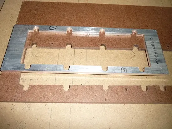

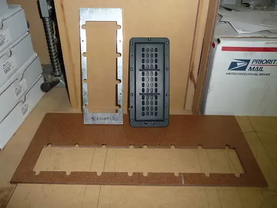

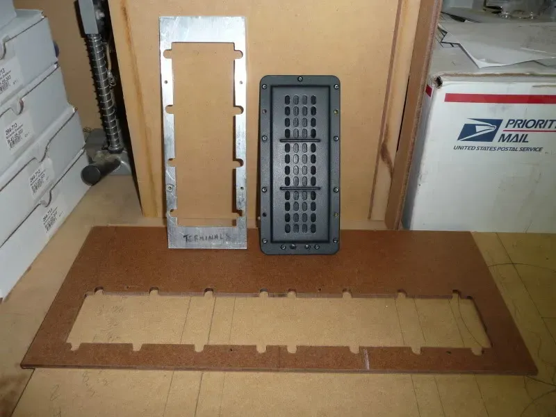

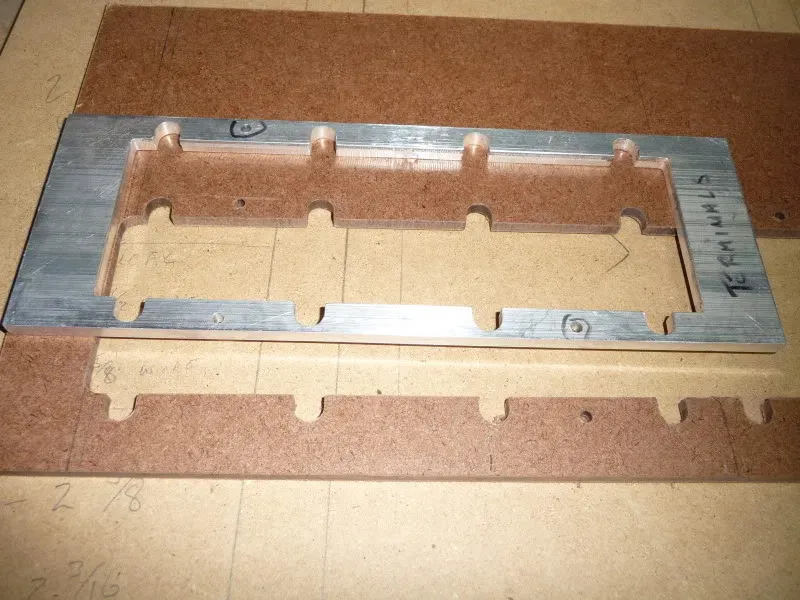

                                                I have a question.
                                                Since this is an open baffle loudspeaker, should the back side be as open as possible? I mounted the Neo8's and Neo3's in some MDF that was glued together to form a 1 1/2" baffle. The Neo's are not very thick. As a matter of fact they are maybe 1/4" thick or not much more. When the Neo's are mounted in a hole that is 1 1/2 inches deep, it certainly looks like the back side is not as open as maybe it should be. Even with roundovers or 45 degree angles on the back it still doesn't seem open enough or as open as it could be. I am thinking that it might help to mount the Neo's on 3/4" MDF rather than double thick 1 1/2" MDF. Actually I was thinking about using 1/4" black plexiglass and surface mounting that into the baffle with threaded mounting holes for the Neo's............but maybe not. Might look cool. Possibly $pendy.
                                                Does anyone have any facts or intelligent opinions about this or am I splitting hairs? :E
                                                Chuck
                                                  #249
                                                  I was going to mention the thick baffle but didn't since this is a test baffle.
                                                  Yes you want to avoid creating a 'cavity' behind the little planars.
                                                  • chasw98
                                                    • 1360
                                                    #250
                                                    You're right, it is a test baffle. I used what was convenient. And how would you define 'cavity'? Is 3/4" depth OK? (Obviously better than 1 1/2" but not as good as 1/4", right?). I am still thinking that 1/4" plexiglass inset into the face of a 3/4" baffle might work very well, both mechanically and acoustically. Then make the side with the woofers double layer (1 1/2") with aluminum struts for rigidity. Add a rear support and voila!
                                                      #251
                                                      Yes a plex or alu mounting plate sounds like a plan.
                                                      • penngray
                                                        • 341
                                                        #252
                                                        Chuck, I would love to see the look of that. I have 3 extra Neopro5is sitting around with zero projects.

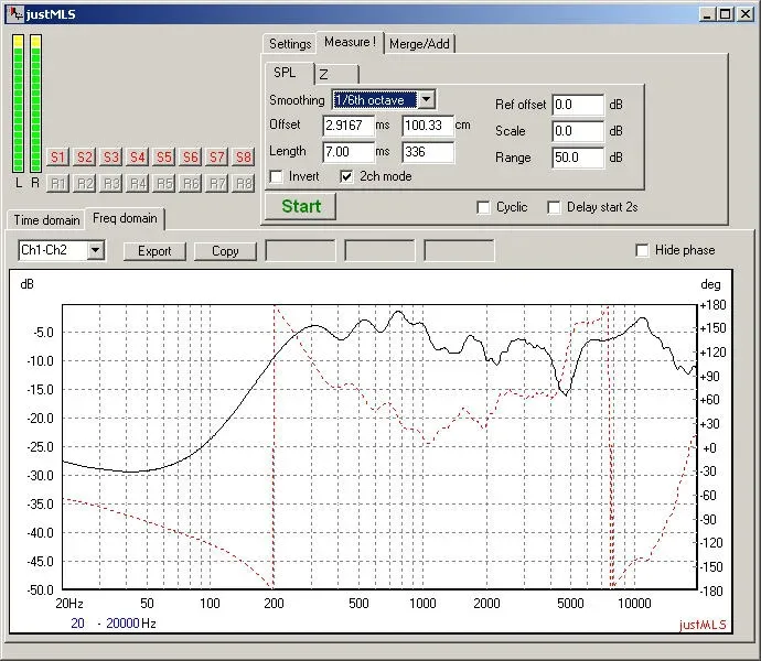

                                                          #253

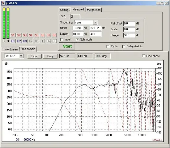

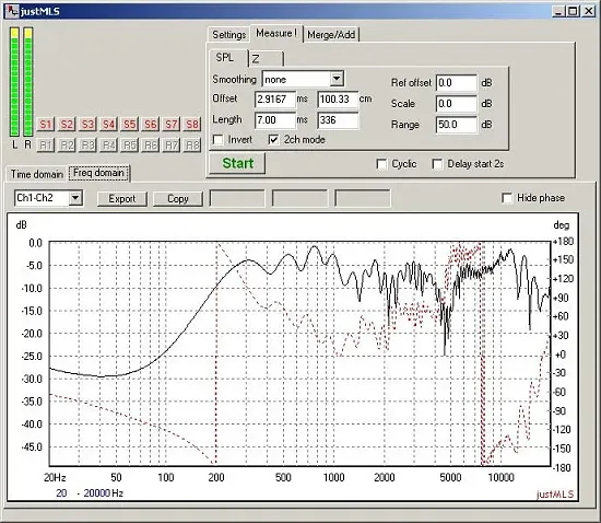

                                                          And here are this weekends measurements. These are of the Neo8's in the array.
                                                          Neo8 at 100 centimeters.
                                                          Neo8 at 100 centimeters 1/6th octave

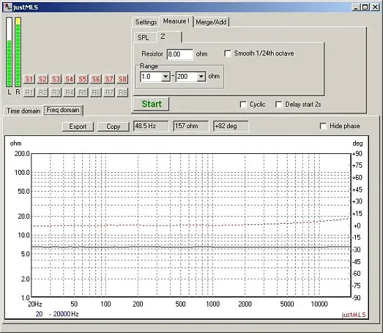

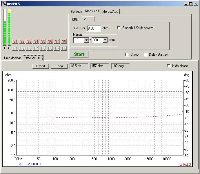

                                                          Neo8 impedance

                                                            #254

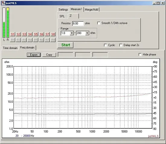

                                                            And here are this weekends measurements. These are of the Neo3's in the array.
                                                            Neo3 at 100 centimeters.
                                                            Neo3 at 100 centimeters 1/6th octave
                                                            Neo3 impedance

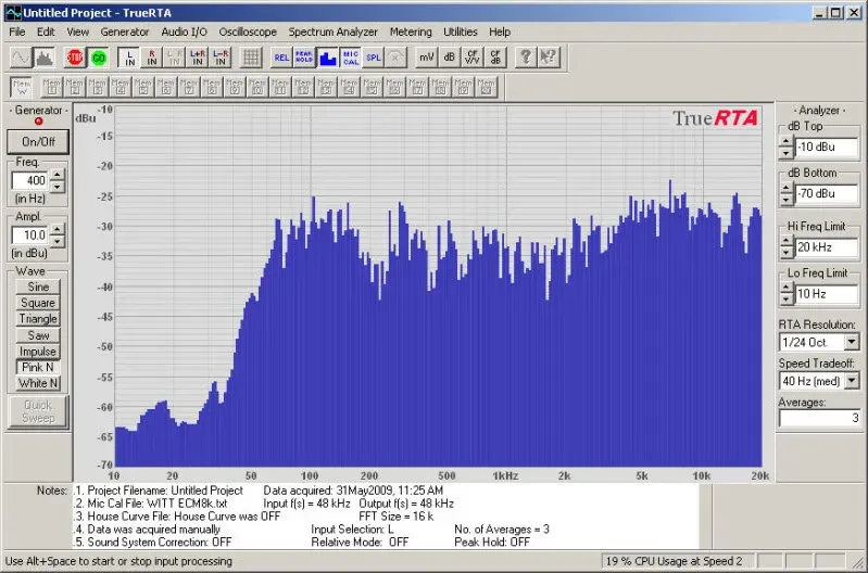

                                                              #255

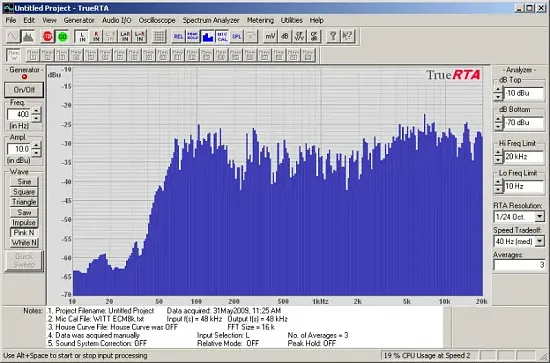

                                                              And just for grins here is a True RTA plot of the Peerless woofers, Neo8's, and Neo3's.

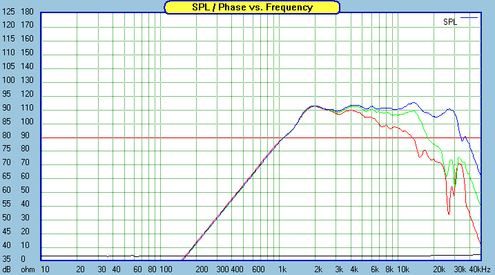

                                                                Chas, I hope this wasn't already addressed, but why use the Neo8's? What about a 2k XO between the Peerless and Neo3's?
                                                                  #257
                                                                  The idea here is to run each driver in it's sweet spot
                                                                  That means running the Neo3 with a 3.5kHz or higher XO point so they can handle some power and don't require brickwall filtering.
                                                                  Also we want to avoid any comb filtering issues associated with running a line array of 6.5" midwoofers up high.

                                                                      OK, the Neo8's are sounding so good that I am taking them to the next step and getting ready to build another baffle that will hold them and the Neo3's properly. That being said, I am tired of not having a jig to make the mounting holes and indents for these things so I built a jig. I am able to route out a hole for an 8 in seconds now.
                                                                      It is fast, accurate, and easy to use. Once I am done using the jig on my project I am willing to lend it out to anyone seriously building these. Just PM me as time goes on and we will work it out.
                                                                      Chuck
                                                                      PS - I will probably build a Neo3 jig as well to go with this one.
                                                                        • 16170
                                                                        #260
                                                                        Click image for larger version  Name:	P1000691.webp Views:	0 Size:	80.5 KB ID:	936960
                                                                        Click image for larger version  Name:	P1000690.webp Views:	0 Size:	39.7 KB ID:	936961
                                                                        Chuck
                                                                        Sweet- then you can "rent them out" to anyone going down the same path- sounds like you won't be needing any comparisons done with RD50's, eh? I've got a pair here that can be measured, but I've been might busy- as we sometimes say back in HQ, slow work takes time. :W

                                                                                  This is sort of a bump to get this thread back on the first page.
                                                                                  I have been on a trip to Washiongton, DC and visited a friend who I would call my mentor. He is an oceanographer who uses sonar line arrays to map the ocean floor. I was asking him about the dilemna of measuring an array and showed him the problems I am having. His suggestion was to dig a trench in your yard to lay the array on its back in and then fly a microphone 3 to 4 meters above the array for measurement. He also noted that even with that scenario you might never get valid measurements that are useful for building a crossover. He also suggested for measuring purposes to power taper the array.
                                                                                  I am not sure how well it will go over to dig a trench in the back yard, but maybe supporting the array on a pair of sawhorses and then measuring from above might be worth looking into. Just an idea....
                                                                                    • 16170
                                                                                    #266
                                                                                    I vote for option #2. :W I bet your wife will, too. :rofl:
                                                                                    In the end, your measurement distance should reflect the way you're going to listen to them- at least as regards measurement distance and height. That way the crossover tuning should be optimized as near as feasible for how you're going to be listening to them. With somewhat nearfield listening, power tapering may be a good idea- I don't recall what Jim Griffin's paper says, might be some nuggets in there for you.
                                                                                      #267
                                                                                      Originally posted by John Atkinson
                                                                                      "Measuring large dipole speakers is always problematic, because the underlying assumptions about the measurement techniques and their relationship with the device under test are no longer completely valid."
                                                                                      As Chuck knows John Whittaker's research into measuring dipole line arrays is a definitive resource.... http://ldsg.snippets.org/ALSR/index.php#HOME

                                                                                          What I found really interesting is that his DynaPleat speaker was crossed over 1st order, between the Dynas and RD75. Hmm... for an RD50 that would be a lot to ask of the driver in the low frequencies, but maybe a dual slope crossover at 500Hz. First-order for an octave.
                                                                                          John unk:
                                                                                            #270
                                                                                            The basis of John W's testing and use was based on B&G RD Series recommended 150Hz XO point. Thing is B&G themselves never used that low a XO point in their own designs. As as example their freestanding 520i has a 350Hz XO point.
                                                                                            Years ago when JonMarsh and I originally measured my RD75s, we found a XO point between 500-650Hz gave the best sound quality. Our experience was validated by other builders in subsequent years.
