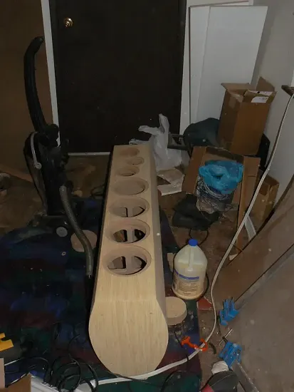

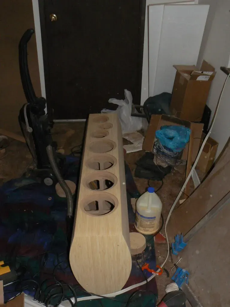

    Well I got the MTM portion cut out. Here are a few pictures. It's nearly midnight now so I should probably stop as the upstairs neighbors may complain about the router haha.
    Really starting to like the way this looks. The bamboo is really ticking me off though... Oh well at this point I don't even care. If it doesn't work out after the finishing then I'll redo the veneer later. Probably cherry or something that's easier to work with.

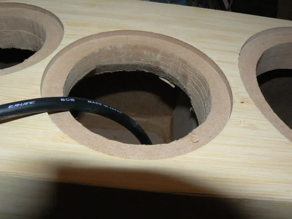

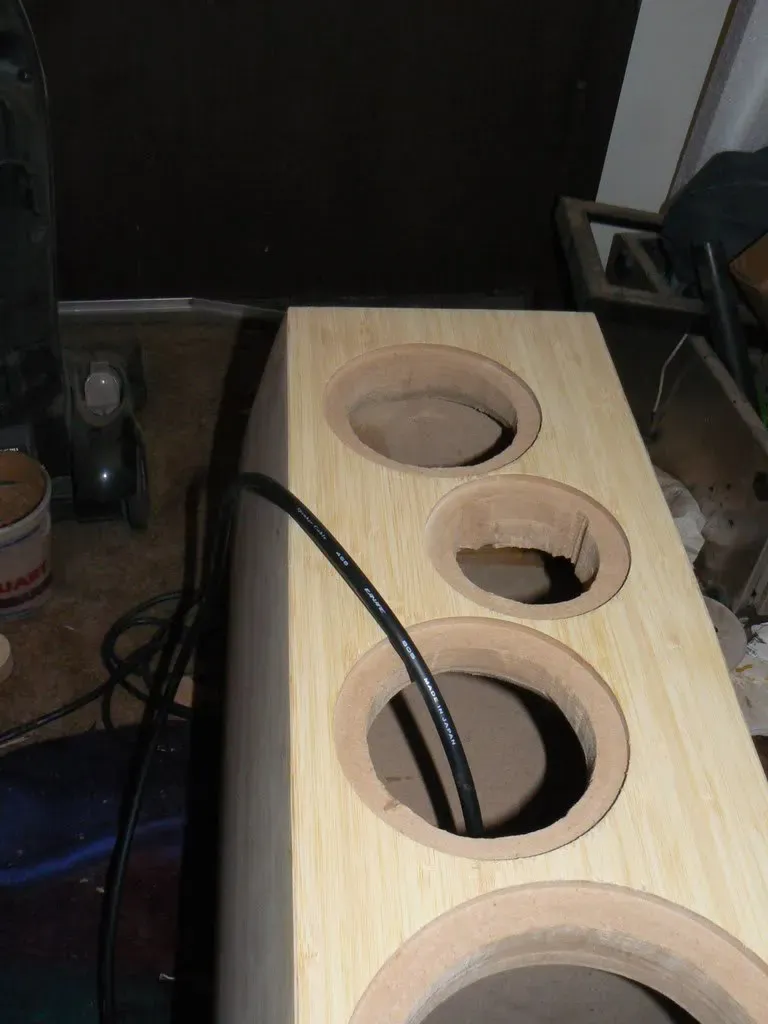

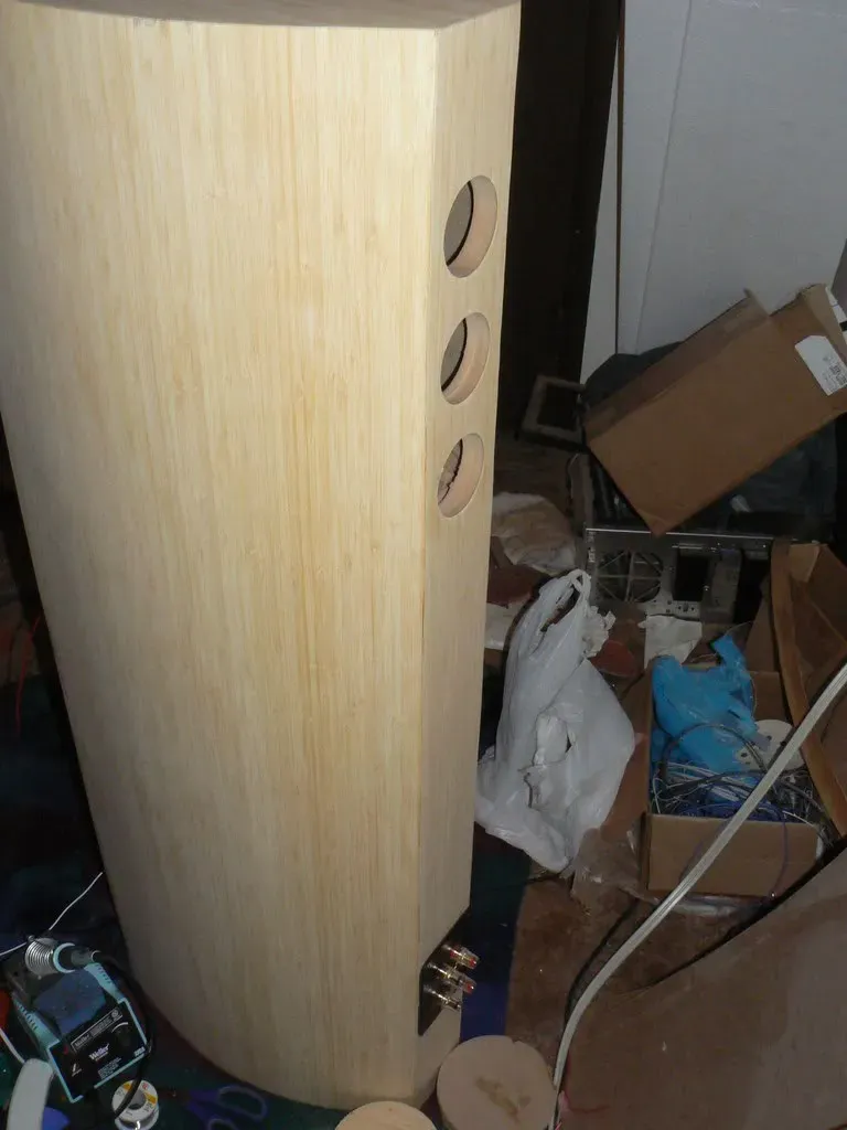

                Well got the rest of the holes cut. I cut a chamfer in behind the midranges with the jig saw. I have a bunch of saw dust left over so I mixed it with a bunch of glue to create some wood filler. I actually feel its better then the crap you get in the stores. So I sealed up the midrange chamber real good. Drilled a hole in the back of it for the wire. In the last pic here you can see the wood filler, also you can see the edges of the recesses where the wood just kind of splintered away. I would not recommend bamboo if anyone is considering it.
                Last edited by theSven; 27 June 2023, 19:31 Tuesday. Reason: Update image location

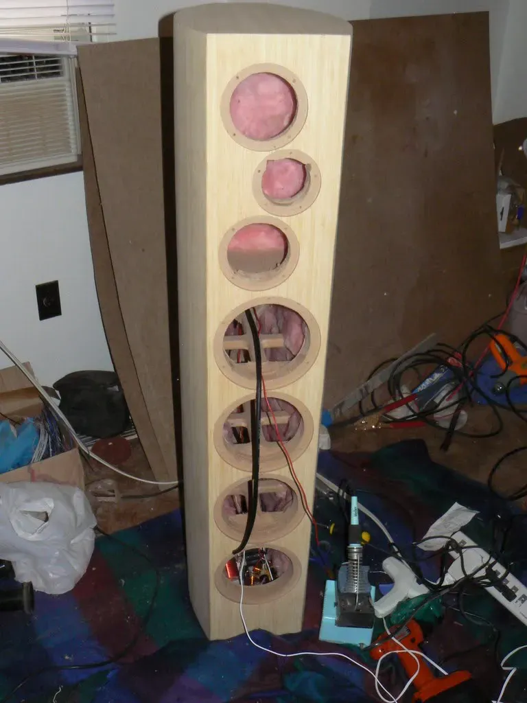

                  Well unfortunately I have to get ready for work now but I almost got done! Got the fiberglass in and started wiring everything up. I used the fast connects but I soldered them to the wire for a nice solid connection. But at least I can still pull them off when I need to now. Here are a few pictures
                  Last edited by theSven; 27 June 2023, 19:32 Tuesday. Reason: Update image location and remove broken image link
                  • Jed
                    • 3621
                    #99
                    You're going to need something on the walls of the mid chamber and the entire thing should be filled with poly/fiberglass or acousta stuff.
                    The woofer holes don't look like they are open enough- could just be the angle of the pic though.
                    Also, there is a pic of the woofers' wiring somewhere in the build on my website.
                      #100
                      Yeah I remember how to wire them. I just have to remember if the positive goes at the top or the bottom. I have to get some polyfill tonight. I'm not done with the midrange chamber either. The piece of fiberglass that's in there isn't even glued in yet. I should have this one all together tonight though and tomorrow it's not supposed to snow so I should be able to bondo the other speaker. I already have the whole can of bondo so figure I should use it. I didn't cut away from the back of the woofers because I though it would be opened up enough through the basket. I'll mess with it later tonight though.
                        #101
                        Yep that's what I thought.
                          #102

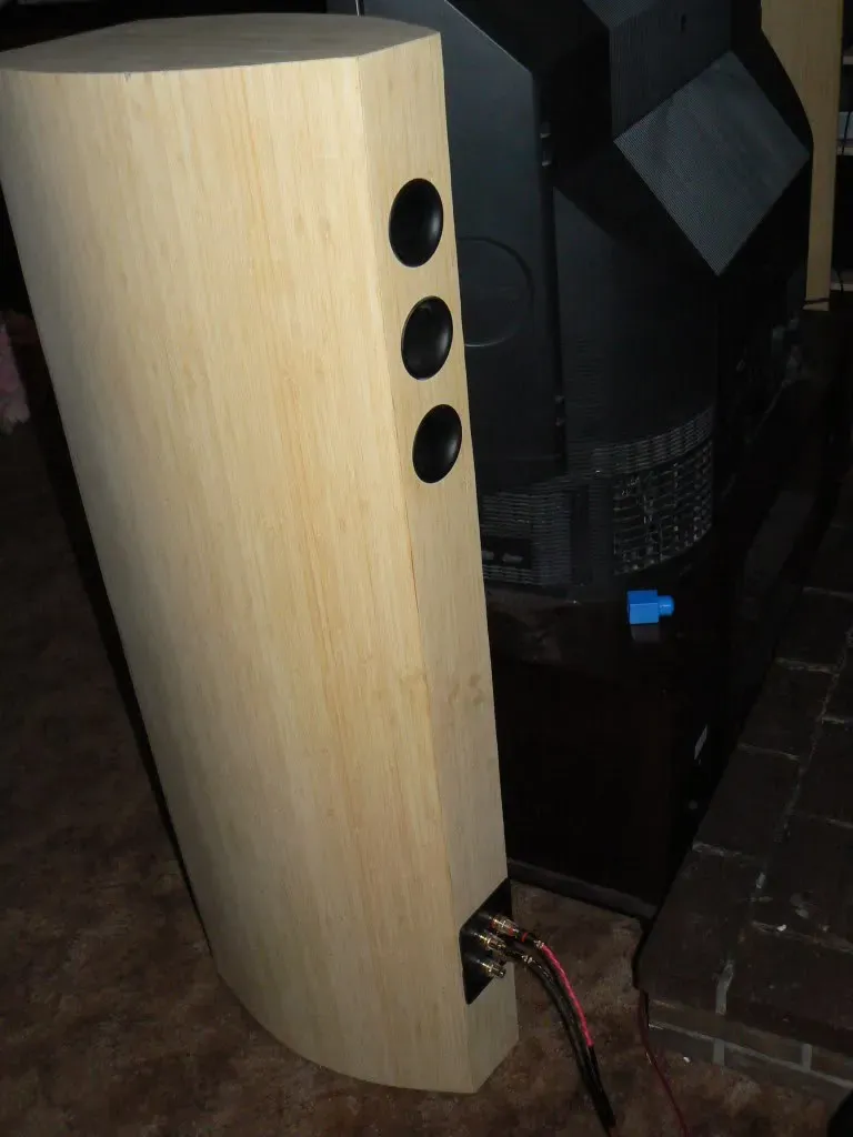

                          I put some wood filler in the hole that was too big for the 3rd port. So that's still drying. But other then that speaker one is done.
                          Last edited by theSven; 27 June 2023, 19:33 Tuesday. Reason: Update image location
                            • 3815
                            #103
                            friggin nice. are you going to stain them to match that stand or some other color?
                            -Chuck
                              #104
                              They will be stained with a blue aniline dye (Transtint). I'm not sure when though. I still have to finish the other one. I have to work this morning so hopefully there is still enough daylight when I get home to do the bondo.
                                #105
                                I will say one thing about the sound before having the other one. The woofers aren't even broken in mind you but even so the bottom end on these are rather amazing. I couldn't crank them to loud because it was like 1am and the neighbors would get upset but even at lower volumes there was a nice strong bottom end.
                                • TacoD
                                  • 1080

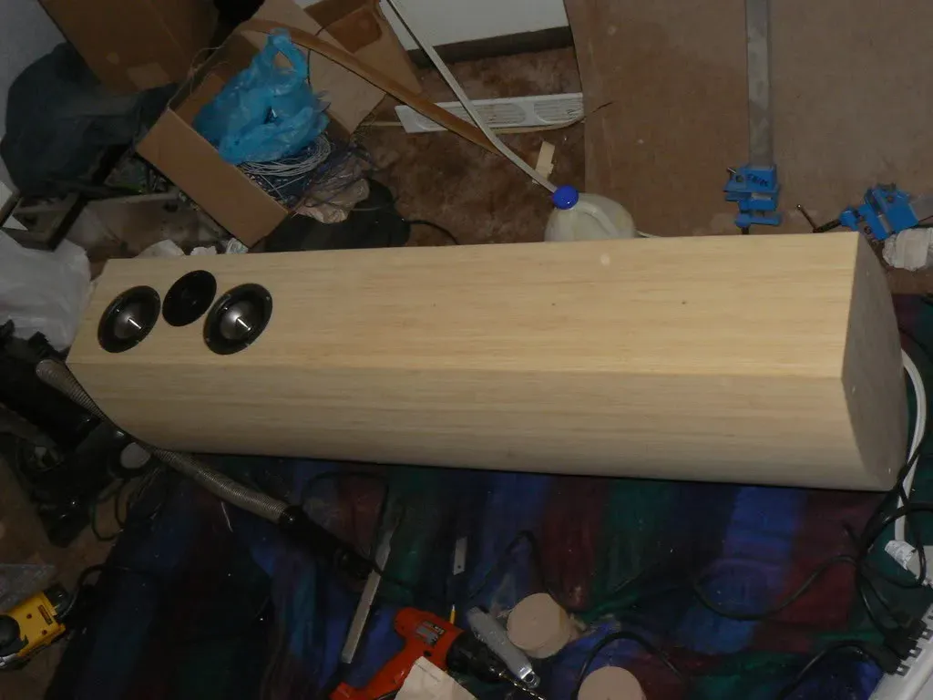

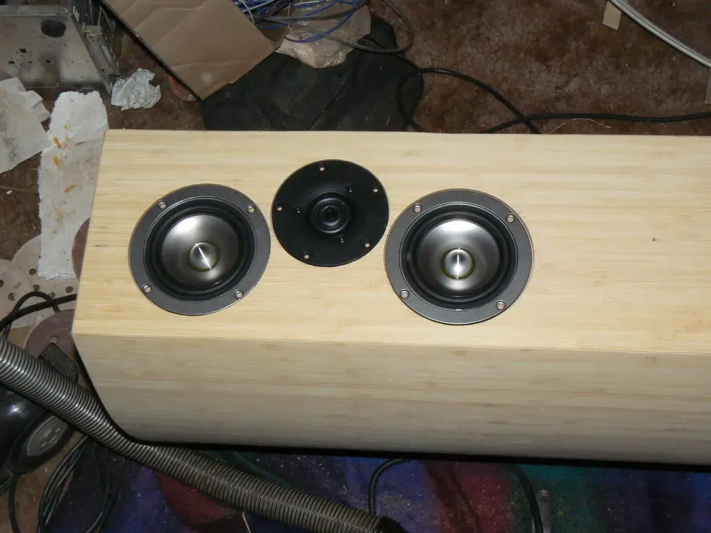

                                                                                      Well veneer is done holes are cut and everything was in the middle of wiring them up but I have to go to work now so I will do the last hour or so of work tonight when I get home. Tomorrow it will be time to crank them and see what they're all about.
                                                                                      • Jed
                                                                                        • 3621
                                                                                        #133
                                                                                        It's going to take some time for the drivers to break in. I wonder how different your speakers will sound from mine without the Sonic Barrier as well.
                                                                                          #134
                                                                                          Would bet less of a difference then you think. The fiberglass really seems to work well.

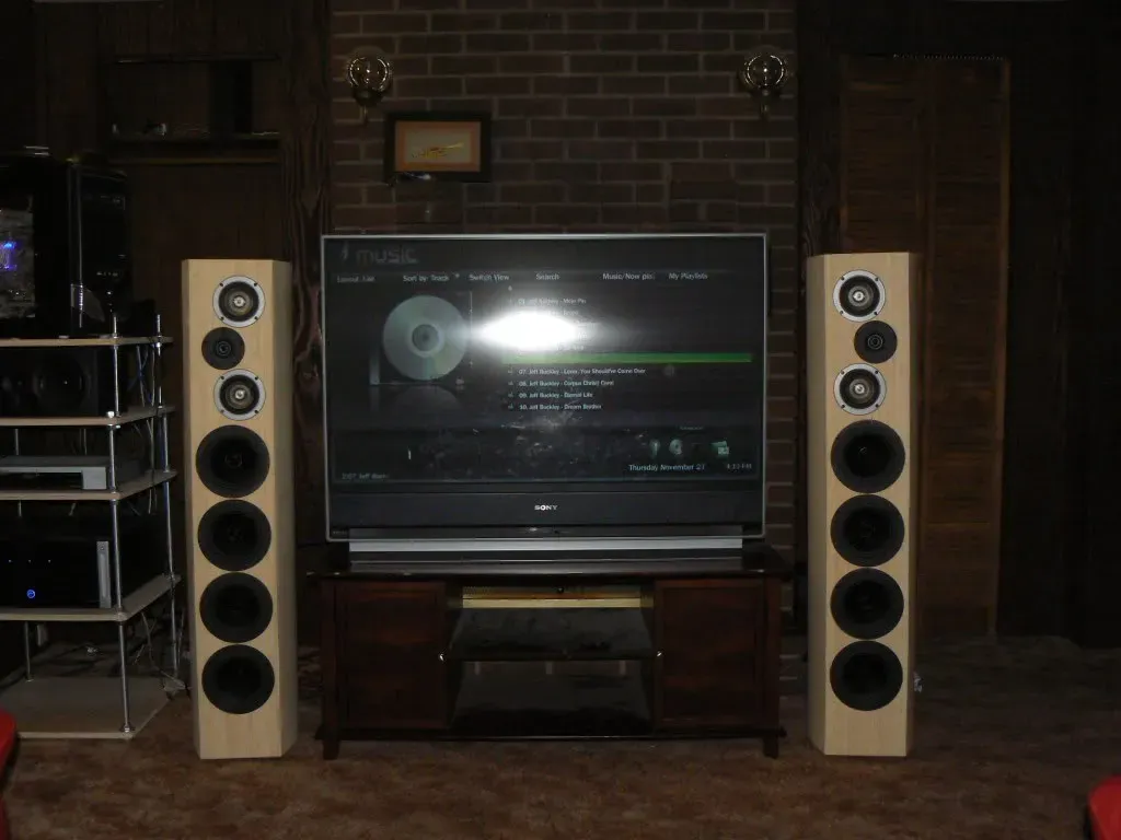

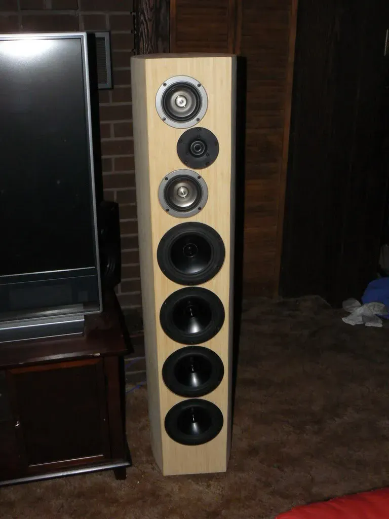

                                                                                            Alright! Well the day has finally arrived. Now to just get the center and surrounds haha.
                                                                                            Last edited by theSven; 27 June 2023, 19:34 Tuesday. Reason: Update image location
