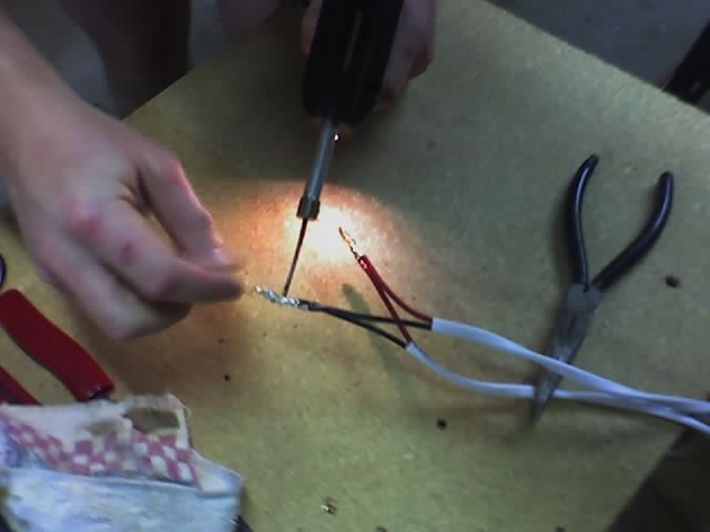

          Soldering Question
          Hey guys,
          I am in the process of soldering the speaker wire together to splice it for the split between the two woofer and the two midrange drivers...
          I have never soldered wires together before... Only copper pipe... :P
          So, I am practicing on some scrap wire...
          How does this splice look???
          This is what I did:
          1 - Stripped the wire back
          2 - Fanned out the individual strands
          3 - Twisted them together
          4 - Tinned the soldering iron (seemed I had to tin the soldering iron multiple times throughout the entire process - is this normal???)
          5 - Set the wire splice on top of the solder iron tip
          6 - Waited for the wire to get hot (the wire actually got really hot almost too hot to hold - is this normal???)
          7 - Applied solder to the wire on the opposite side of the wire in relation to the soldering iron
          8 - Let the solder be sucked into the wire strands
          If anybody is reading this at this time and has any knowledge on this subject matter I would really appreciate some tips/tricks or affirmation of what I am doing...
          Sorry the pictures are a bit blurry - it is the best my phone will do close up... :roll:
          Thanks!!!
          Mark

            #320
            Strip more and then wrap them tightly around each other. Lets see if I can find a picture...
            Ah found the nicest image
            This is how I've always done it.

              Dougie, thanks for the quick photo... I appreciate it...
              I am letting this go for tonight... I am getting way too frustrated and don't want to mess anything up...
              I understand what the photo is showing but that is really hard to do with two and three strands of 12-gauge wire...
              Some of my finger tips are bleeding... 8O

                #322
                Well you don't have to do it exactly like the picture. Obviously with larger guages it's going to be near impossible to do. Just try and get something close. You want a nice solid connection before you solder. Solder is just meant to hold it all in place.

                    The primary sequence for a good solder joint is to heat the joint and add the solder to it, i.e. , the hot joint melts the solder. You are on the right procedural track. Do not disturb the joint until it seizes (cools a little) or you will have a cold joint which will appear grainy. It is a very simple skill to acquire. Finally, only add enough solder to flow the joint; if you add too much the excess will roll up on the tip of the iron. I learned to solder when I was 10 years old working(piddeling) in the shop of one of my dad's furniture and appliance stores. Simple, very simple skill...

                      Just make sure you have a good physical connection. You should be able to lightly tug on it before you solder it.

                            Chuck makes a valid point on the connection; It does not need to be a "wire splice" but should stay in place on its on. As he said, it should withstand a slight tug. You will laugh when you find how simple it really is.

                              Awesome progress has been made Wednesday night and Thursday morning!!! Happy Turkey Day everybody!!!
                              As everyone said, soldering is a piece of cake... To quote Ray above, yes I did laugh out loud... :lol: My buddy's Dad came over Wednesday night and gave me a soldering 101 lesson and it was awesome... After a few test joints I was soldering like a champ... :B
                              The following pictures show the steps I took to solder the speaker wires together... I figured I would document this for other solder nubies such as myself...
                              Picture one shows the speaker wire ends coming out of the cabinets...
                              Picture two shows trimming back the cover and then I stripped about 3/4"-1" of insulation off the wires...
                              Picture three shows how I fanned out the individual braids of the wire...
                              Picture four shows the end result of laying the fanned out braids on top of each other and then twisting them all together... This was easy to do with my fingers for joining two wires... When I had to join three I used a pair of needle nose pliers to aid in the twisting...
                              Picture five shows a completed and successful solder connection... Their should be no copper wire showing and all the strands of wire should have a nice coating of solder on them... You should still be able to see the individual strands but all should have a nice coat on them...

                                #330
                                The first two pictures show me in action soldering...
                                When doing this, unwrap about 2 feet of solder from the spool and let it just hang over the side of your bench or table so you are not fighting to unwind it while soldering the joints...
                                I was using a 140w soldering gun and it took about 10-15 seconds for it to heat the twisted wire enough to start melting the solder... THIS WAS THE KEY... I was getting frustrated at my first attempts the other day primarily due to the fact that I was using a 45w soldering iron... The 140w soldering gun made all the difference in the world...
                                I took the approach of placing the tip of the soldering gun under the twisted wire and then touched the solder to the top of the twisted wire... When everything is hot enough the solder will literally be sucked into the strands of the wire... It is actually quite cool and amazing if this is your first time doing this... 8)
                                You will need about 1 1/2 feet of the solder to thoroughly saturate the twisted wire... Especially on the three wire bundles...
                                Let the connection cool and check the under side of it to be sure the solder flowed all the way through it... If not, just flip it over and repeat the process on the other side... Obviously you will not need as much solder this time around...
                                The last three pictures show the process I used to heat shrink and then tie wrap the connections...
                                My buddy's dad showed me the trick of taking the normal size heat shrink and covering the solder connection... Cut it long and then folder over the end and then place a short piece of the next size up of heat shrink over the fold... This produces a nice tidy package...
                                I then used three tie wraps to bundle everything together... This made the wire extremely stiff and there is no tension or tugging on the wire or connections...
                                Nice...

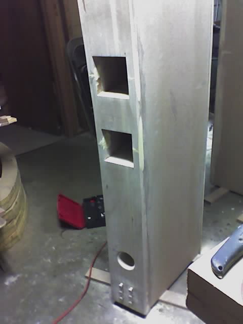

                                                    Since I am going to have a little while to work on the crossovers while I literally wait for paint to dry, I am going to work on the prep work of the speakers for finishing...
                                                    These pictures show the first completely glued up speaker... It turned out very very nice!!!
                                                    You can see the areas where I have applied Durham's wood putty on some of the areas that needed a little help...
                                                    Now I am literally waiting for paint AND wood putty to dry... Ha ha...
                                                    I should have painted the crossover board long ago... But, oh well... Live and learn, right...
                                                    The last pictures is a shot down the mid tunnel... It is so simple but also oh so gratifying to see the midrange cutout perfectly centered in the mid tunnel...

                                                                                      The only part that I really couldn't sand smooth was where I applied Durham's to the inside of the midrange chambers (you can see it in photo two)... I got it pretty darn smooth; but I figured the foam is going to cover that up anyway... :P
                                                                                      So, if I can get the other speaker sanded tomorrow night (it doesn't have nearly as much Durham's on it) and do a few little touch-ups on the first one, I think I will be bringing them up on Wednesday for a test listen... :B
                                                                                      More to come!!!
                                                                                      Mark
