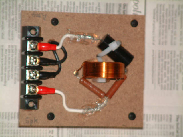

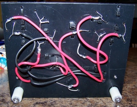

                                        If your crossovers will be visible, you may want to consider mounting the components on plexiglass or something similar. If you don't have a source for this, it is usually available at one of the home improvements stores.
                                        On my last set of crossovers, the components were glued to the topside of a piece of 3/16" thick plexiglass plate. All wires were routed underneath the plate. The plexiglass plate had standoffs mounted underneath and these were used to attach it to the speakers as well as provide clearance for the wiring underneath. This works out to a very clean installation and visual appeal.

                                                        That's awesome Mark - - - No holds barred!
                                                        FYI: You may want to consider mounting your x-over componants to a piece of Black ABS plastic. Its cheap and has a haircell finish on one side. Here's an example.
Name:	2008 03 06_0199.JPG
Name:	2008 03 06_0209.JPG
                                                        -David

                                                          #253
                                                          David, thank you SO much for posting those pictures!!! That is exactly what I am thinking of doing for mine... Awesome!!! :B
                                                          Just got into the office from being out of town and confirmed that my speaker wire and all the veneer and supplies were shipped... I must say Joe Woodworker really does a good job at packaging the materials and supplies...
                                                          I am in the home stretch now!!! :T
                                                          Thanks guys!!!
