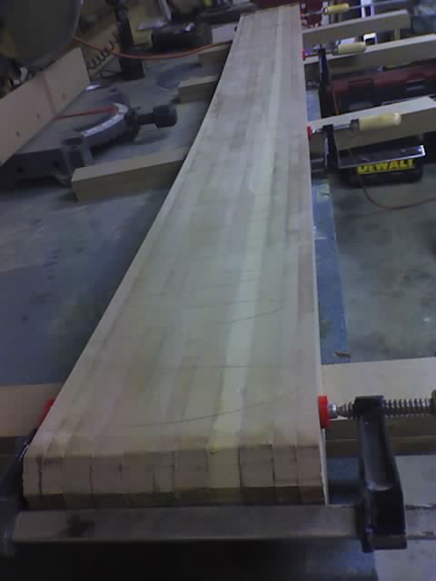

                                        Here are two more pictures of the curves being glues together...
                                        I only have enough clamps to do one side at a time...
                                        So, I am clamping two 1 inch strips together and one 5 inch strip together...
                                        Once the glue dries I will cut appropriately and then glue the three strips together to form the back of the speaker...
                                        The curves came out super smooth and should require minimal sanding to achieve a nice uniform surface...
                                        Thanks!!!

                                                                    I am VERY VERY happy right now!!!
                                                                    One of my big concerns was how good the curves were going to come out...
                                                                    Well, I just got finished sanding them and they turned out awesome!!!
                                                                    They are as smooth as a baby's butt...
                                                                    The first pictures shows all the pieces of both curves clamped together in order... Whenever I cut multiples of the same curve I like to clamp them together when sanding so that they all come out uniform...
                                                                    After I did a decent job sanding all the curves together, I then clamped just the curves for one speaker together and repeated the process... This is show in the second picture...
                                                                    The third picture shows a little trick I use where you scribble a pencil on the surface you are sanding... Sand just enough to erase the pencil and you will see where you have low and high spots where the pencil erases and doesn't erase... This also prevents you from over sanding and area... Works like a charm...
                                                                    The forth pictures shows all the curves lined up after the sanding process...
                                                                    The last photo didn't come out too well but is supposed to show how smooth the curves are...
                                                                    Now all I have to do is cut the holes out for the ports and the midrange chambers and trim the end of the curves...
                                                                    Once that is done I will glue the curve pieces together and then give it one more final light sanding...
                                                                    More soon!!!
