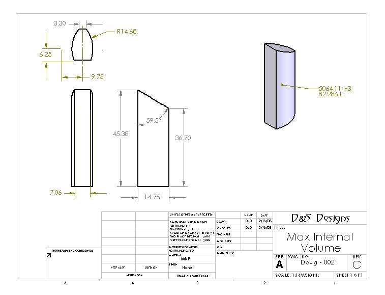

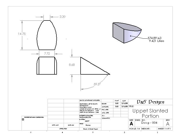

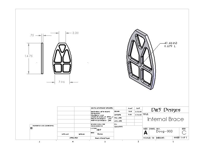

          Hi Doug,
          OK here's the latest & greatest. I think you will find every thing jives.
          Full Empty Volume:
          Volume = 5064.11 cubic inches
          82.986 Liters
          Brace Volume:
          Volume = 41.46 cubic inches
          0.679 Liters
          Slanted Top Volume
          Volume = 574.89 cubic inches
          9.421 Liters
          Cross sectional Area of straight portion:
          Area = 111.61 in2
          720.063 cm2
Name:	max internal volume revc.jpg
Name:	internal brace revc.jpg
Name:	upper slanted portion.jpg
          -David

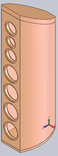

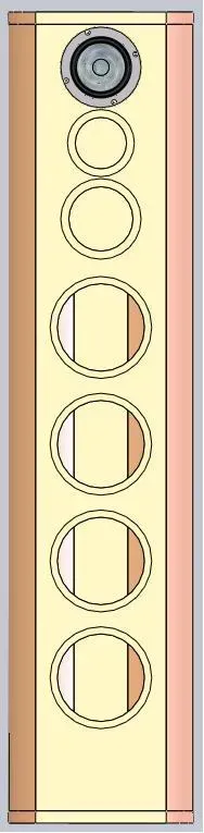

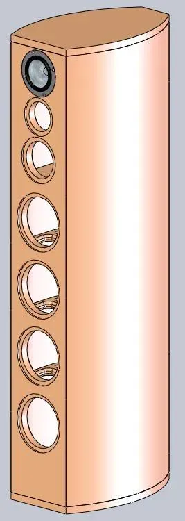

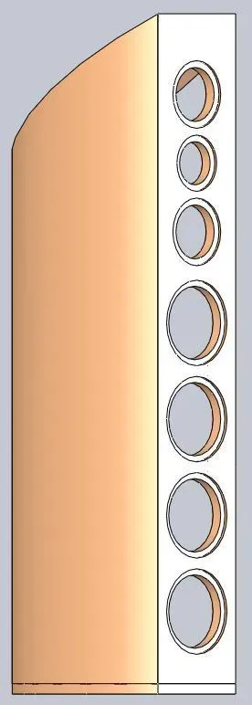

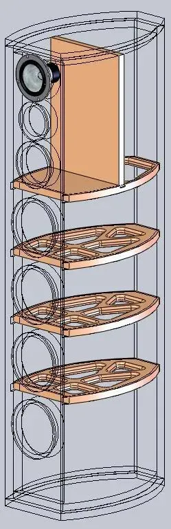

                Figured I'd post up these pics for you guys. David and I talked a bit and he quickly came up with this and it's excellent. I thank him very much for all the help This is going to change a bit as I decided I wanted to just have the braces and stuff CNC'd so now the baffle will go the length of the speaker in the front and back. The top bottom and braces will all lock into the baffles to create a skeleton.
ID:	943129 Click image for larger version
ID:	943130 Click image for larger version

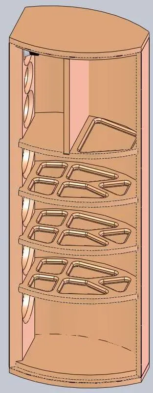

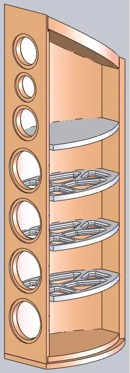

                        Ok well we were having issues with clearance of the angled top and the top mid so we had to get rid of the angle. Also added dado's for everything pretty much so it should all fit together completely perfectly and now its all getting CNC'd even the sides.
ID:	943134 Click image for larger version
ID:	943135 Click image for larger version
ID:	943136 Click image for larger version
ID:	943137 Click image for larger version
ID:	943138 Click image for larger version
ID:	943139 Click image for larger version
                        There is a little over 76 liters for the woofers now as well Which is just perfect!

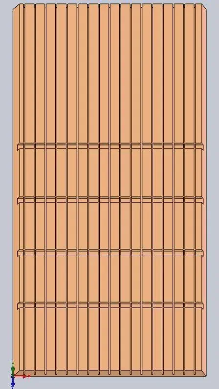

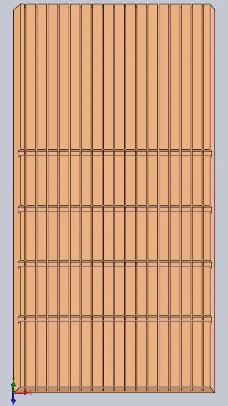

                            This is a picture of the sides of the cabinet. As you can see there are lots of slits through it they will give the wood enough relief to bend to the curve of the cabinet.
                            • Ezcl
                              • Jul 2008
                              • 61
                              Oh, interesting. I didn't realize you could do that and not have the wood break.
                              I'm guessing then that this 'slitting' doesn't affect the performance of the speaker at all?
                              "Measure twice, then measure again before even thinking about plugging the saw in."
                                • 16128
                                Nope shouldn't effect it at all. Lots of people have built curved cabinets this way. The only other way I would have done it is to use like 1/4" MDF and multiple layers. I like the idea I'm going with better though. If your anal about the rigidness of the sides you can try and fill them with something if you like. I think I may put a bunch of glue down the grooves right before I put them on and then when they dry they should hold their own shape quite well. Some people have put the ridges on the outside and then filled it with bondo/wood filler or something and sanded it down. I'm not sure I want to do all that because these are pretty large.

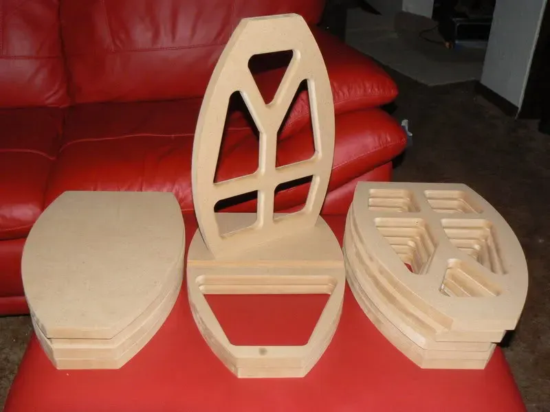

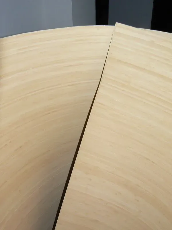

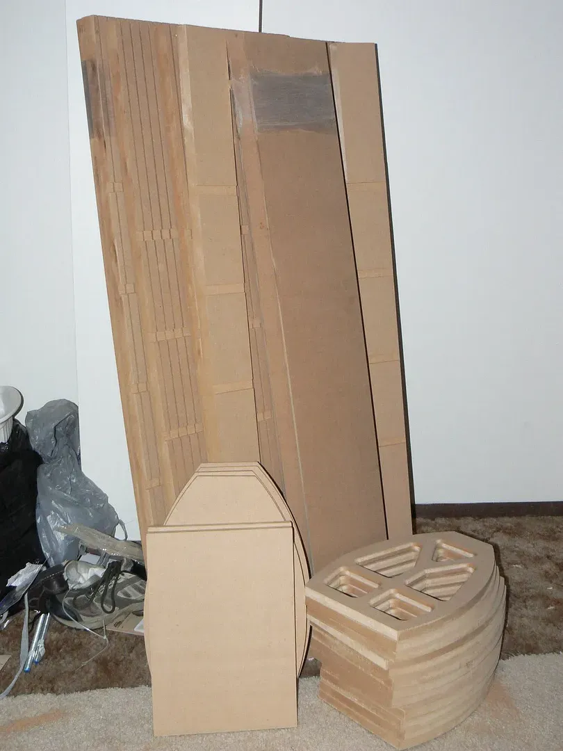

                                      In case anyone is still interested I received my bamboo veneer today..I'm not sure if I'm going to use this or not I've been thinking about quilted maple after I ordered the bamboo but now looking at the bamboo its very nice....although I still like quilted maple better. We'll see. I also received some of the cabinet parts and here are some pictures.
                                      Braces and what not
                                      Veneer

                                                                                  Well I got most of the parts in.
                                                                                  The rest of the cabinet parts are coming tomorrow. Then I just have to work out when my friend can come pick me up to move them all to his house. Been working on how I'm going to layout my living room as well.
                                                                                  Should work out good until we get a house :B
                                                                                  Last edited by theSven; 26 June 2023, 22:26 Monday. Reason: Update image location and remove broken image link
