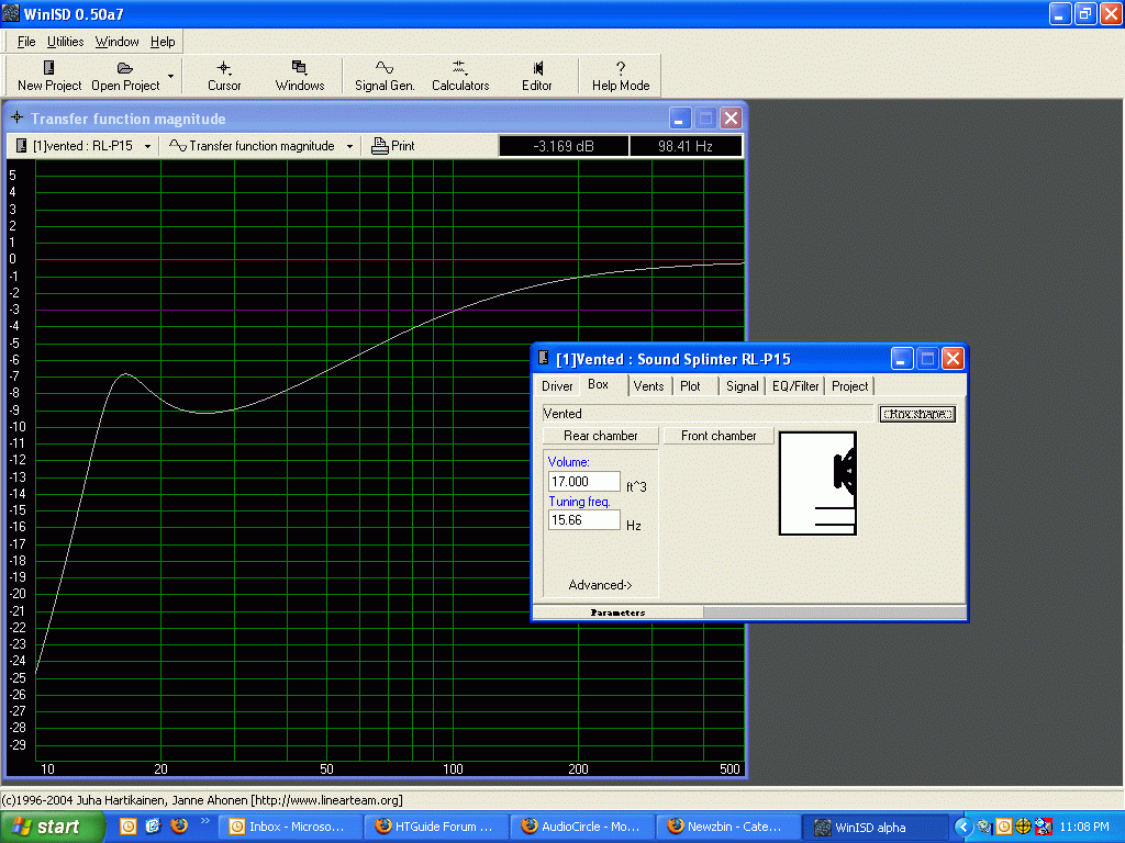

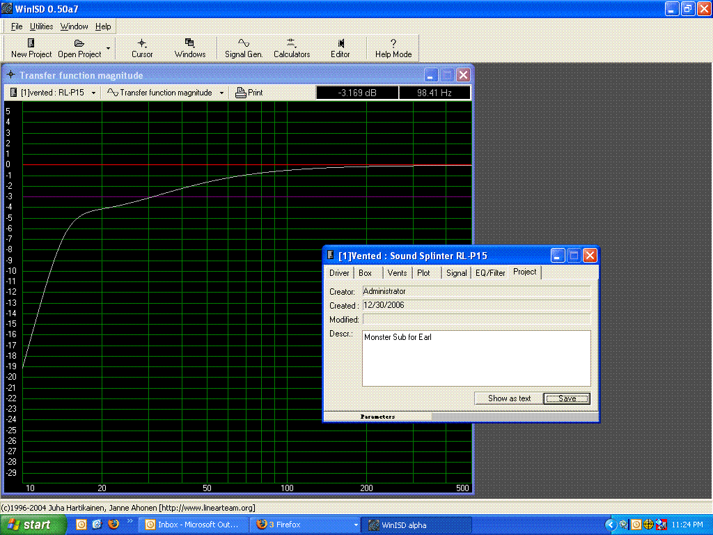

        Here's what I came up with using a 27" long and 8" diameter tube. I tried numerous combinations of various diameters and lengths but could do no better:
        If I change the series resistance to 4.0 I got this:
        That second graph looks pretty good to me. I suspect I still didn't do everything correctly. What do you guys think? Thanks

            Ryan: I have informed Earl I estimate a weight of at least 250-300 pounds and suggested I build two boxes and set them side by side. No go, he wants one box. He's a general contractor and has alot of young guys to move it around for him but getting it into his truck with just us may be a bit of a challenge. :E
            I'll print out the thread on your sub and read it again. Now that I'm getting to the nitty gritty part I need to think more about construction technique. I will use BB to help keep weight down. Then at least add one thickness of MDF on the baffle.
            I believe I'm going to have to get a crossover to make it easier to adjust volume and I don't know what kind of crossover is available in his Yamaha HT receiver. I will be at 8 ohms total impedance actually, not 4. It appears the 8 ohm curve is better:

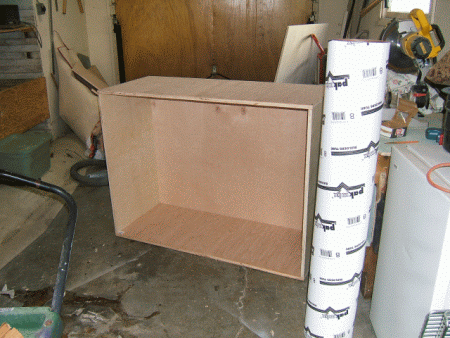

                                  Now I'd really appreciate some help. Here's the box and port
                                  Tube:
                                  Now I need to confirm port length and where would be the best place for it. Actual inside dimensions are 46.5"w x 34.5" h x 19"d. I thought I read WinISD Pro accounted for the box thickness but want to make sure as this leaves room for error depending on how you construct the box. If someone can tell me how much volume a tube 8" diameter and 27" long uses I"d appreciate it. Drivers are .42 total and the shelf braces will be .35 just guessing.
                                  I also read that you're supposed to keep the rear of the port it's diameter away from the walls and the rear of the drivers. Looks like I don't have that option.
                                  Before I put in the shelf braces I want to put in the holes for the port to help mount it. I hope I can go through the side but if I have to have the port facing upwards it will just get done that way. Any help is greatly appreciated.
                                  Last edited by theSven; 14 August 2023, 23:12 Monday. Reason: Update image location

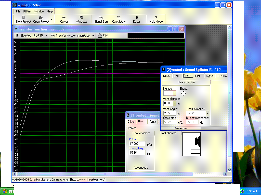

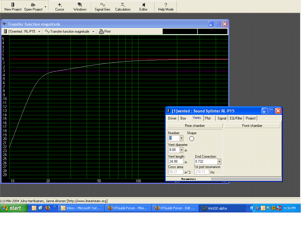

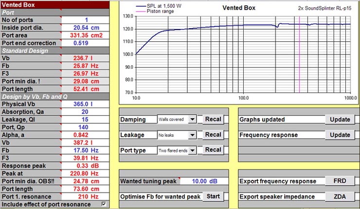

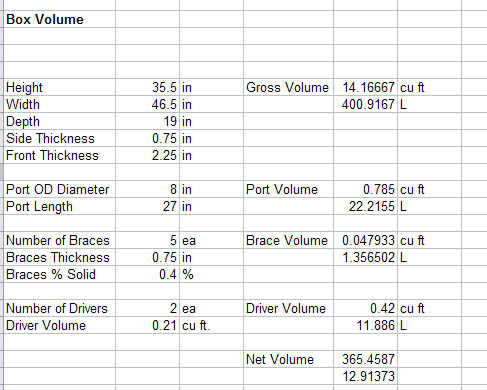

                                    I end up with a volume of 14.25 cubic feet. Port length of 24.99" for an 8" diameter tube here:
                                    Click image for larger version  Name:	Finalsubspecs.GIF Views:	253 Size:	56.1 KB ID:	847110
                                    Please let me know if this is correct. Volume of the port is 5,000 cubic inches or 2.9 cubic feet. This seems like alot but I double checked, still doesn't mean it's correct. It's tuned to 17.5hz.
                                    My plan is a double thickness for the baffle and three shelf braces. Any other recommendations let me know.
                                    As soon as someone confirms design and where to put the port I'll finish the box and Kyle said I will have drivers by Saturday or Monday.
                                    Last edited by theSven; 14 August 2023, 23:15 Monday. Reason: Update image location
                                      I don't think you subtracted the volume of the port from your total volume. I got the same 420cuft gross volume. When I subtract out the port, driver, and bracing I get 365L or 12.9cuft.
                                      Changing your volume looks like it gives up a very very little bit between tuning and 20hz. and it also lowers your first port resonance point down to like 200hz. So, I think you're fine.
                                      Though, Unibox is showing me for that volume and tuning of 17.5, the port should be 28.9" long.

                                        The actual internal volume measuring inside dimensions is 17.6 cubic feet. Subtract 2.9 for the port and .42 for the back of the drivers you get about 14.25. This is what I modeled in WinIsd. Tuning frequency is set to 17.5hz but Winisd shows 24.99. Outside of the box will measure 20.5"d x 36"h x 48" wide.
                                        I read that the TS parameters in WinIsd are incorrect. Could that have something to do with our different port lengths? Also did you use 2 drivers? Thank You for modeling it for me and double checking.
                                          Oops, you gave inside dims. give me a second.
                                          You should get the T/S correct.
                                          For the port:
                                          Lv = (23562.5*Dv^2*Np/(Fb^2*Vb))-(k*Dv)
                                          where,
                                          Dv = port diameter (cm)
                                          Fb = tuning frequency (Hz)
                                          Vb = net volume (litres)
                                          Lv = length of each port (cm)
                                          Np = number of ports
                                          k = end correction (normally 0.732)
                                          So it has more to do with the volume and slightly due to the absorption and end corrections.
                                            Okay, fixing the volume, I get the same 24.36".

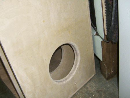

                                                      I will place the port at 6" from the outside edges of the rear corner. The other end will be at the center of the cabinet between the drivers and below them.
                                                      I"m wondering if I really need a flare for this port. It's so large I can't imagine any chuffing sounds but if it's a problem let me know and I'll learn how to use a round over bit.
                                                        If you already have a roundover bit, go ahead and use it on the front opening of the port

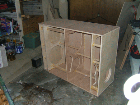

                                                          • warnerwh
                                                            • 261

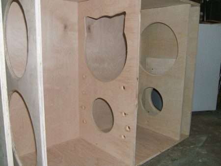

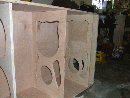

                                                            Here's where I'm at now. If you think I should add some mdf to the rear panel I will as I have to get some for the front baffle anyway. This thing seems pretty light right now. Any other suggestions please let me know.
                                                            For the flare I used a 1/2" round over bit. I also rounded some of the interior bracing. The quality consistency of my flare is far from perfect but should work better than sharp edges.
                                                            Thank You
                                                            Last edited by theSven; 14 August 2023, 23:13 Monday. Reason: Update image location
                                                              The spacing of the braces is a bit odd. If they're not fixed in place move the front and rear brace further toward the middle
                                                              Also I'd remove more material from the middle and rear braces.
                                                              • warnerwh
                                                                • 261
                                                                Thomas: The spacing of the braces from the center is 18". I figured I needed to leave room so the brace and fiberglass wasn't near the drivers. The drivers will be facing forward on the large panel not yet installed. If I should still place them closer please let me know. They're not permanent yet. Thank You.
                                                                I'll remove more meat from the middle and rear brace.
                                                                  If the drivers go on the open side there should be a horizontal brace between the drivers to support that large section. It would be best if that brace tied in with the other braces
                                                                  Fiberglass doesn't hurt the drivers. The interior surface of all the walls should be covered with glass.
                                                                  • warnerwh
                                                                    • 261
                                                                    Thomas: The box will be sitting on the 4' width. The braces will be vertical to the floor. Are you saying I need to run braces going the other direction also? If so can I use cross bracing like closet dowel? I guess I could put mdf shelf bracing going the other way too.
                                                                    The drivers will be 1" more toward the middle of the cabinet than perfectly centered. The front baffle will have two large pieces of mdf mounted to the back of the plywood. Then I will cut out holes in mdf large enough to fit around the outer frame of the drivers so the driver is set back from the front so in effect the front baffle will be 3 layers or 2.25".
                                                                    Thank You

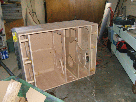

                                                                    Here's the braces with more meat removed, not pretty but I think structurally it's ok:
                                                                      That's fine for those braces, But you need shelf bracing that's perpendicular to those.

                                                                          • warnerwh
                                                                            • 261

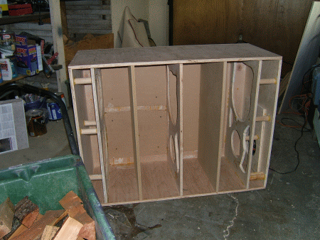

                                                                            Hopefully the cross bracing here is adequate. They all fit tightly and all braces are tied to each other. Everything has been glued with Titebond II then an hour later I went and put hot glue around the edges. I can pick up the cabinet with any of the braces. :
                                                                            I will sand things down to fit perfectly unless you think I should do more. Being as I've read that this ply is adequate with one thickness I'll not worry about the rear panel. It seems like I should glue mdf to the large sections that are 18"x34.5" though. Edit: I went ahead and glued mdf to the rear panel, now I feel better.

                                                                              I will be glueing mdf to the top and bottom and cross braces from the top to the bottom as well as from one side to the other. Please let me know if that's enough. This thing is starting to get pretty heavy. With drivers I'm estimating well over 200 pounds. I've decided I will go three layers of the 13 ply for the baffle rather than sandwiching the ply with mdf to help keep weight down. Otherwise it will take 4 guys to move it. Any help is appreciated. Thanks
                                                                                3/4" ply needs to be properly braced. The "rear" panel in particular needs some kind of reinforcement between the existing braces. That's too large an area to go unsupported.

                                                                                • warnerwh
                                                                                  • 261
                                                                                  Thanks Thomas. I'm on my way to Home depot. I will go up and see if I can figure out how to build shelf braces that will fit. If I have to I can remove the cross braces in the large areas.
                                                                                  It says on the SS website mounting depth is 21cm. This is 8.3" if I'm correct. My concern is position of the shelf braces. I can go above and below on the left side as you face it but the other side has the port. Would it do any good to put a shelf brace below the port tube? Thanks
                                                                                  • warnerwh
                                                                                    • 261
                                                                                    How about if I add two more braces facing the same way as the others and then adding braces going the other way? I can put them closer toward the center but the distance between the center brace to the side brace I'm unsure of.
                                                                                    If I places both drivers say 4" outside edge to outside edge how much distance is safe for the extra side braces to be?
                                                                                    I'll go up and make two more braces like the existing now but won't put them in until I get your recommendation on distance Thomas. Thank You

                                                                                      • 261
                                                                                      I have braces just set in there now:
                                                                                      I'm wondering if I could center them like that and just cut out around the drivers. Or should I move them out away from the center. I have plenty of mdf to do anything necessary. I think it should still make it under 300 when done. Please let me know.
                                                                                      Then we'll figure out how to put the shelf bracing going the other way. I just figured being as I have the mdf I may as well add two more shelf braces going the same way as the others, especially after you posted that pic. Thank You
                                                                                      Last edited by theSven; 14 August 2023, 23:14 Monday. Reason: Update image location
                                                                                        As long as the new braces don't obstruct the vent holes on the back of the magnet you're good to go..
                                                                                        • warnerwh
                                                                                          • 261
                                                                                          Thank You very much Thomas. I'll have the drivers so I can see exactly what I'm dealing with tomorrow.
                                                                                          With the extra braces do we still need braces going the other direction from brace to brace?
                                                                                          • warnerwh
                                                                                            • 261
                                                                                            Here's the cabinet with one of the two extra braces installed. I rounded all the cutouts. There will be a good 3" behind the heat vent.
                                                                                            Do you recommend I add any more bracing anywhere? Your help is greatly appreciated Thomas. I probably appear not too bright sometimes I'm sure but still want to do a good job. Thank You
