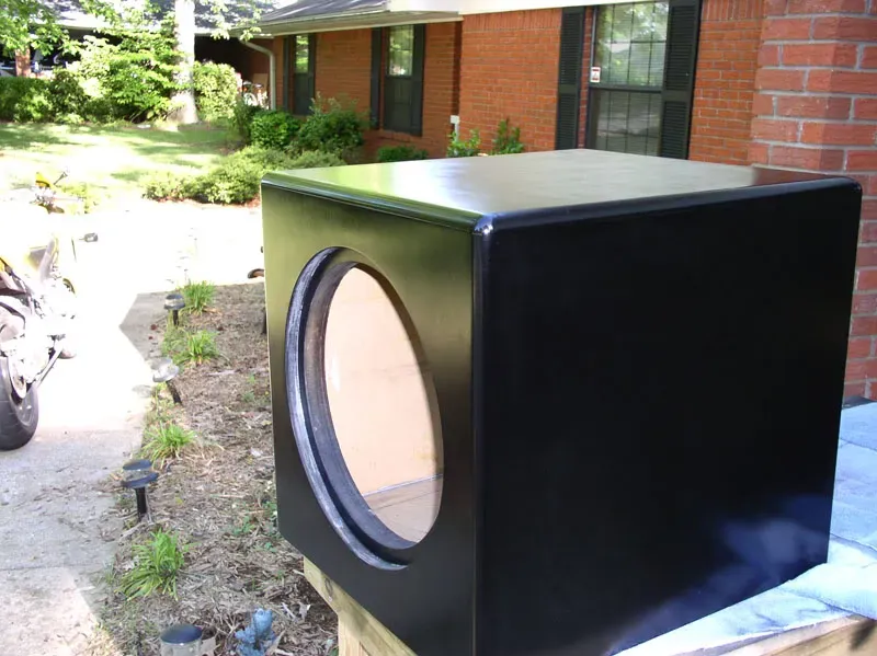

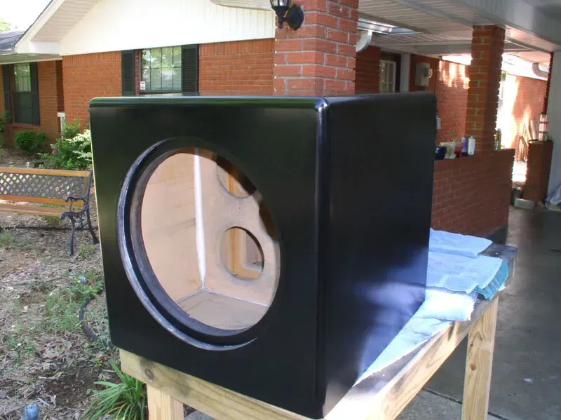

    Here are a couple of the "final" pics. I think it looked better before I put the clearcoat on it.
    Nearly had a disaster as well :M I was turning the box to polish the side and I let it tumble off the edge. I managed to somehow snag the 110lb falling object by the driver hole and got away with a small dent in the back corner, whew!

              One last pic before the driver goes in (don't know when that will be)... it was fun to carry in the house by myself.

                Don't know if it's worth anything at this point, and it doesn't look like you would benefit much from it anyway because your finish already looks very good and even, but, this weekend while painting some end caps, I found that putting a layer of clearcoat inbetween a few layers of paint works very well with MDF. It seals off the MDF so it can't absorb the paint, especially on cut edges. You get much more consistent color coverage and a smoother, even coating. Again, doesn't look like yours needs it though.
                • dyazdani
                  • 7032
                  #98
                  That is a good idea. I had a couple coats of sanding sealer on the raw MDF, then 3-4 coats of primer. I think that built up a good surface before I hit it with the black.

                                        This it the type of gloss black I've dreamd of for my own sub, Nice Job. Question, how did you keep outside dust away from your project? Did you build a booth of some sort to let it dry in? Sorry if these questions have already been answered.
                                        • dyazdani
                                          • 7032

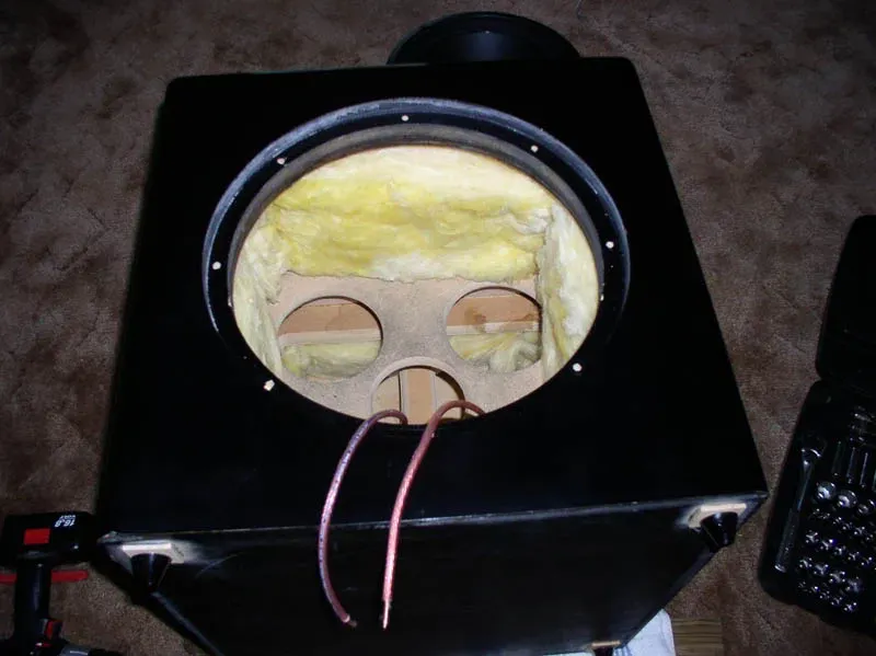

                                          #110
                                          I did not build a booth - it just sat out in the open (under the carport). I didn't really notice a dust problem and didn't see any specs of junk in the paint.
                                          I'm sure a booth would be optimum, but I just don't have the resources to set something like that up.
                                          Danish
                                          • dyazdani
                                            • 7032
                                            #111

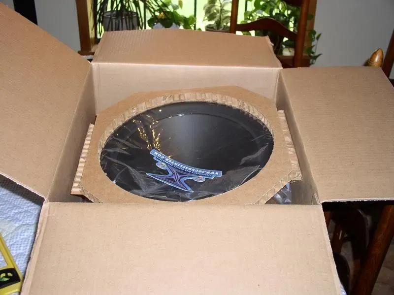

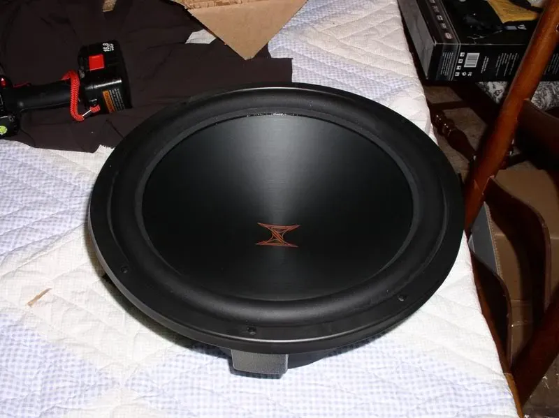

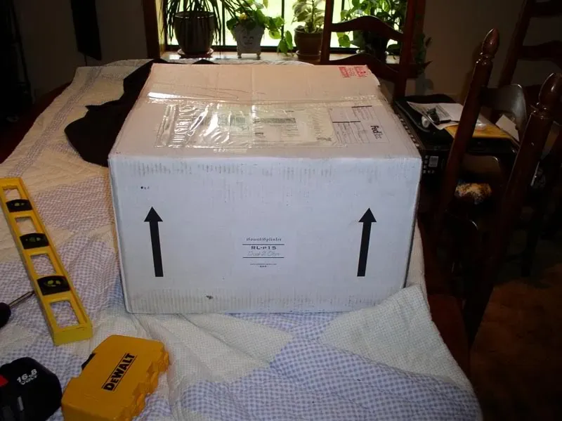

                                            What could be in here?
                                            Woo-hoo :T
                                            Just set it in the box, it doesn't seem like that rubber gasket thing is a good fit, so I may go without it.
                                            Last edited by theSven; 02 August 2023, 19:43 Wednesday. Reason: Update image location
                                            Danish

                                                      I don't think getting it in there will be too bad, but once it goes in; if the holes don't line up then it's tough to make minor moves in position - especially with the rubber.
                                                      Danish

                                                          Use nails just sitting in the woofer holes to align the driver with the holes in the cab. I've done this on occasion and it works well.
                                                          • dyazdani
                                                            • 7032
                                                            #119
                                                            Originally posted by swithey
                                                            That thing looks massive. I cannot wait to pick up some for myself. I've already been in communication with Mike over at SS about an order.
                                                            I guess you are using "pick up" in the figurative sense - my sub weighs 150lbs, tough for one person, hehe. 8O
                                                            Good tip on the alignment, Thomas - I'll see what I can do. I don't know what I'll use for stuffing yet, don't really want to buy a whole bundle of insulation. Maybe I can find someone that has some lying around.
                                                            Danish

                                                                  I had to take my dremmel/sand paper around the rim of my hole to enlarge it enough for the driver to fit in. Not a big deal.
                                                                  So, do you have it all hooked up yet?

                                                                    dyazdani, is the sub a metallic finish or is it matte type finish on the cone? I've been waiting for the metallic finished ones to come in in the d2.
                                                                      #124
                                                                      The cones are black anodized alu..

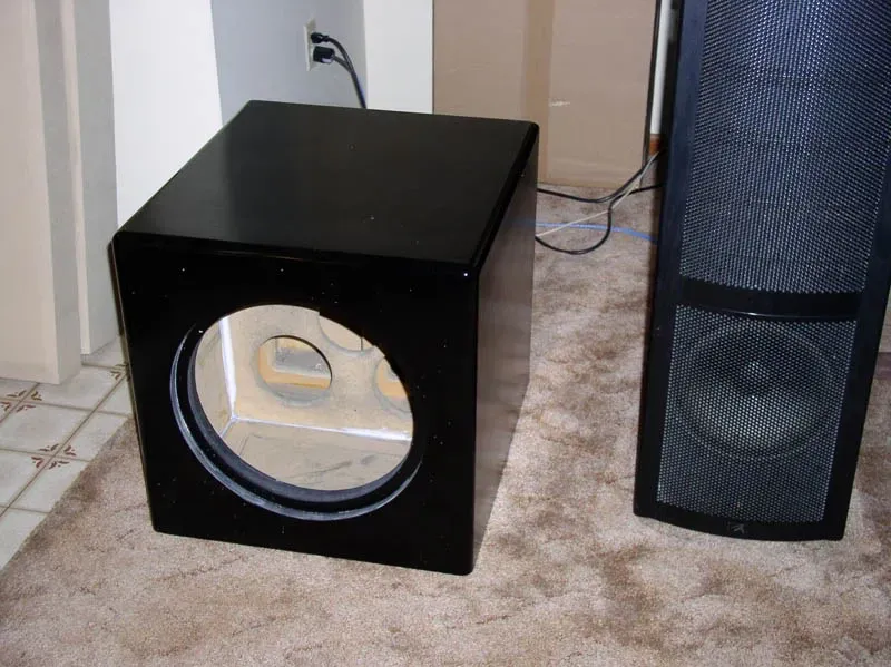

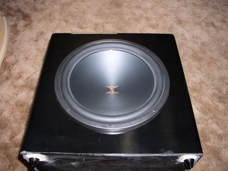

                                                                          #126

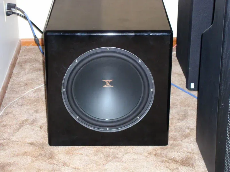

                                                                          Here are two "final" pictures...
                                                                          Last edited by theSven; 02 August 2023, 19:44 Wednesday. Reason: Update image location
                                                                          Danish

                                                                            Yes, but they had a "mishap" with their cone manufacturer... they received a batch of cones that had a matte-like finish rather than the usual finish which is lighter and shinier.
                                                                            See below...
                                                                            matte (like mine)

                                                                              #128
                                                                              I ended up discarding the rubber gasket. I think it would have fit, but it was being a real PITA and I was just doing damage to the enclosure by trying to stuff it in there.
                                                                              The thing sounds nice - not as nice as my Infra18 (yet) - I guess it needs to break in and of course, I haven't set the EQ up in the BFD. I'll get there this weekend hopefully!
                                                                              Danish
