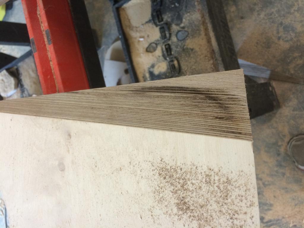

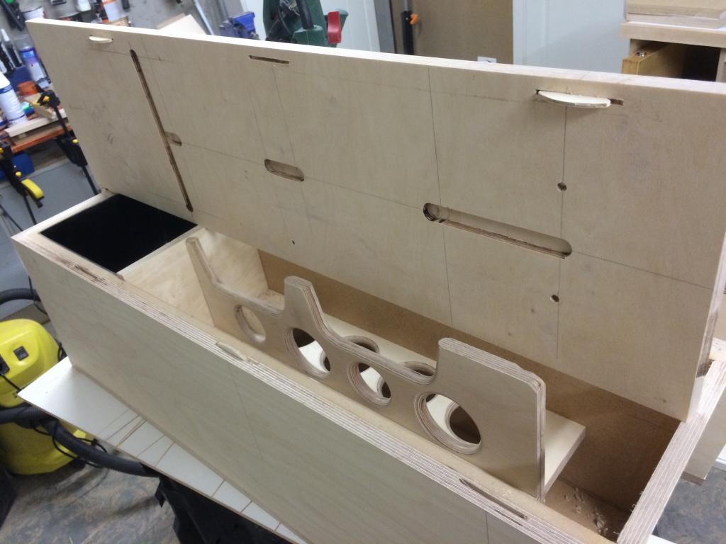

      I oversized the vaffel a bit as described in the drawings.
      I have been wondering about how to adjust the width of the baffel to exactly matc the cabinet widt.
      The baffel is 4x18mm = 72mm. I have neither router bits or saw blade that may cut that size.
      To handle this I installed some biscuits on one side of the cabinet. This caused the baffel (just the inner layer) to fit very firm onto the cabinet.
      The 4 layers of the baffel itself is fit together using wood plugs in drilled holes.
      Using this technic I can assemble and disassamble the baffel as needed.
      I put the first baffel layer on the cabinet and used a flush trim bit to fit it to the cabinet.
      Then I stacked other panels on top of the first and flush trimmed each layer to fit.

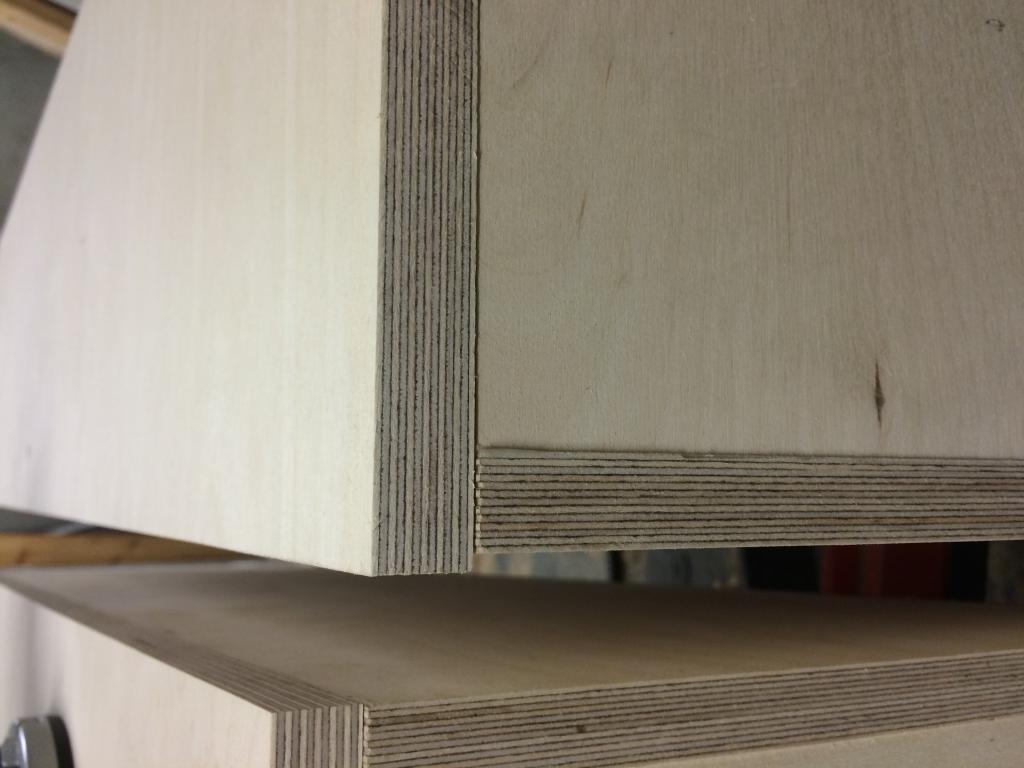

        It seems like I have some masochist tendencies, as I'm going for raw burl veneer as veneer for these... :banghead:
        The plan is to use contact cement (gel type) when applying the veneer.
        On top of the veneer there will be several layers of shiny clear coat and at last some layer of satin clear coat
        The question to you more experience builders is:
        - what kind of surface preparation (except sanding flat) is needed to ensure a good result in many years to come? :duh:
        - especially, how can I ensure no telegraphing on the side and top of the baffel? :duh:
        Edit:
        Hmm, just noticed that joethewoodworker states that "Contact cement is only suitable for backed veneers" and "Heat Lock and other iron-on glues can not be used with a veneering project that has seams.", meaning that using pressure is the only viable option.
        I could build a vacum press, but I'm not sure if that is possible to use for a prebuild speaker box - any toughts on that are welcome.
        The most realistic choice seems to be to use regular clamp pressure...
        (the original questions are still in the open)

            I think that the pressure part is doable as long as I have the pation to do one panel of the time.
            I'm mostly worried about two issues:
            - telegraphing, especially on the top and sides of the baffel where we have the vertical sides of the ply meeting the flat laid ply panels
            - that I don't do the right groundwork for the clear coating and that "something bad" will happend after some time, for example that the clear coat will crack

              Just add 1/8" hard board to the sides and top to stop telegraphing. Ben's showing epoxy skim coat over cab with 1/8" hard board sides and top.

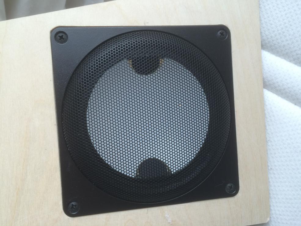

              Best I found for grills was some 3/8" HDF (hard version of MDF). Made some grills on another build out of it and they where strong and straight.

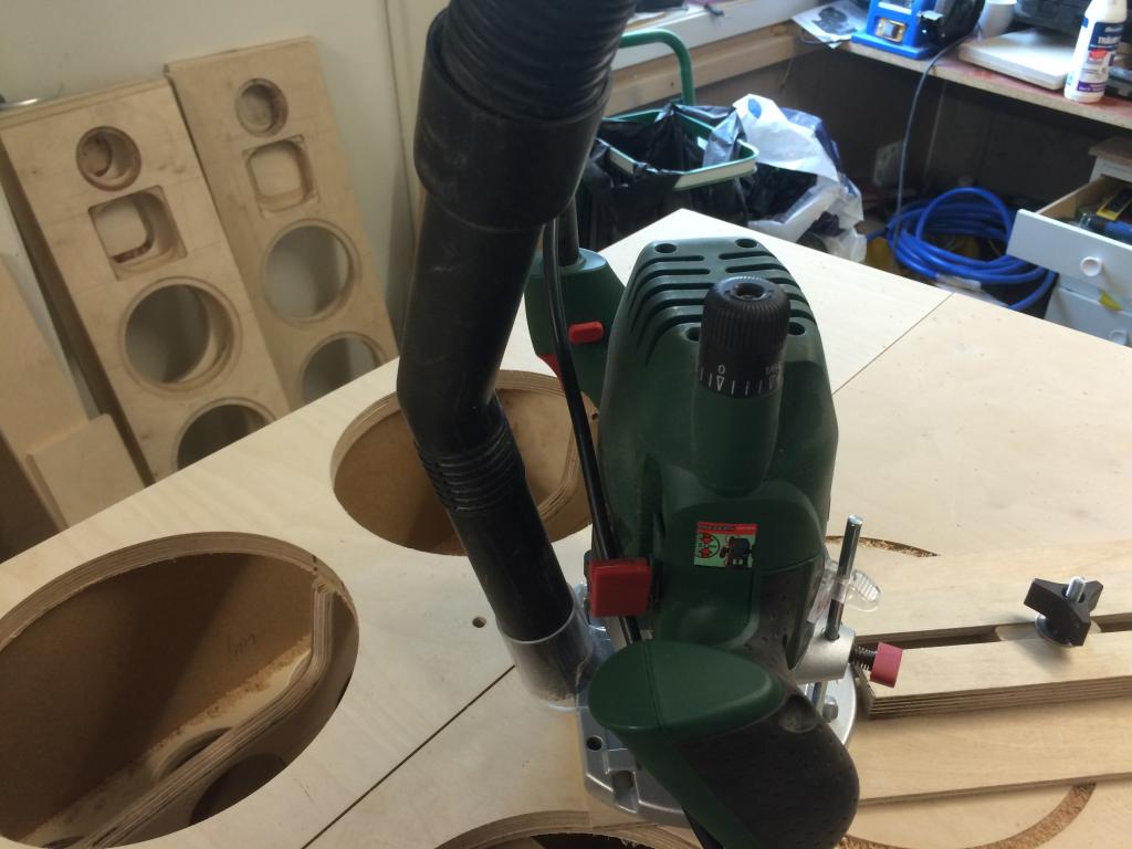

                                                    As mentioned earlier on I have not glued my baffle together. Instead I have used "guide pins" to hold the 4 BB plates in position when I'm working with them, as shown on this picture:
                                                    I did this to be able to be user that I would reach all layers to cut out the cutout for the drivers. But I also did it for one more reason. In case I did a wrong cut i would not have to throw away the whole baffle - but would be able to just replace one piece of the baffle.
                                                    And guess what - I found out the hard way that the half of 224 mm is not 122mm... No idea what went on in my head - but I adjusted my circle jig to half of 224mm and got that to be 122mm and just cut away. Talk about disappointment when I should testfit the driver and found that the size of the cutout was WAY off :E
                                                    At that time I was very happy that I had not glued up the baffle yet. Including wondering how to solve it I guess it took me a small hour to get back on track by replacing the piece of the baffle that I had missed on :T
                                                    Talking about circle jig. I made me a circle jig that I must say worked really great. It can cut circles from 3cm radius and up, and it is really easy to measure exact cut size as shown on the last picture.

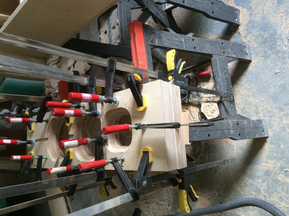

                                                      I'm now done with the cutout for the drivers.
                                                      Took some time - but I think I got a good result.
                                                      I used the following methods:
                                                      - For the Wavecor drivers and the tweeter I used my circle jig. First a test cut (yes, I do learn from my mistakes :roll, check that the driver fits, then cut the speaker. All drivers of the same size in one go. First one "layer", then removed that layer of the baffle and did another layer until all 4 layers was done.
                                                      - For the mid-tone (the Accuton) I used the templates I made earlier on. The driver recess I did from the top with the plunge router. The driver hole I did with the table router and the template. After the first two layers that I had a template for I did the last two layers on freehand using the plunge router and a thin bit. That worked nicely.
                                                      I also used the table router to roundover the edge between the different sized driver cutouts (the inner two BB layer has larger holes than the outer two to allow the drivers to breath)

                                                      Oh, one last thing. As my template bit is to larger (16,7mm) for the corners of the accuton mid I had to figure out a way of making the corner radius a bit smaller after using the template.
                                                      On the test piece I used a knife and sandpaper. A lot of work and just a half good result.
                                                      Now I changed to a bit that was right sized (12mm), lovered the plunge router to the right depth and adjusted the corners using that on freehand. That gave a nice result with little effort.

                                                        Last bit of experience gained - dough I kindof knew this from before.
                                                        When cutting the 3rd layer of the baffel I noticed that it was a little bit skewed. I went back to check what the reason might be and I found it.
                                                        With a baffel as deep as this you should use something to help you drill the guide holes in a 90 degree angel. I did not have that and and the 3rd layer that shows, ref. picture 2 below. The effect of this is shown on picture 1 below (there is a edge between layer 2 and 3 - might be a bit hard to see on the picture)
                                                        Not a problem, but I would of course preferred it to be perfect...

                                                                            Gluing the baffels...
ID:	859785Click image for larger version

                                                                                            The problem with the endgrain is telegraphing where the sides and top of the cabinet meet the endgrain. I plan on adding a layer of 3mm mdf on the sides and the top to avoid the problem.
