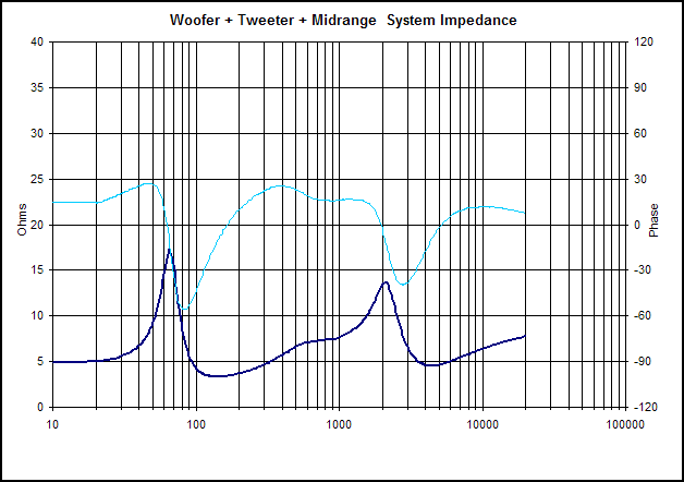

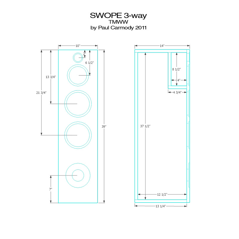

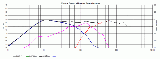

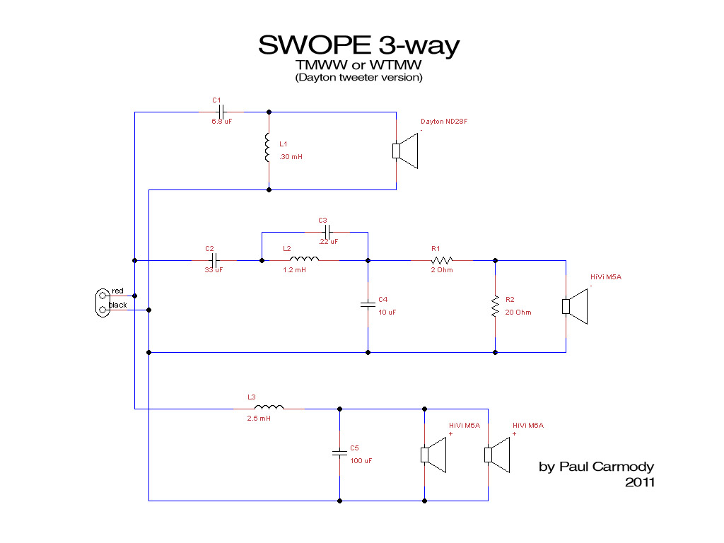

    Wow, guys, I can't believe the time has finally come! Thanks to a very generous DIYer who built and shipped me some cabinets, I was able to measure, sim, and tweak a crossover for a full-fledged 3-way using the HiVi M-series woofers and Dayton ND28F (and SB 29RDCN) tweeters.
    The crossover shares a similar topology to the Swope Center Channel, but the values are very different. I adjusted the BSC as well as changed the overall voicing of the speaker.
    The cabinets provided to me were sealed, so obviously I know they integrate well with a sub. But I also know that most people would want to build this speaker vented. So that's the model I'm providing. The cabinet design I'm showing here uses 3/4" stock. The chamber for the M5A is about 4.5 Liters, and the chamber for the woofers is somewhere around 58 Liters, give or take bracing. And yes, it's a big cabinet and it WILL need bracing. If it were me, I'd probably just rip some 3" strips and screw those into the walls, tying them together. A more patient/competent builder would probably use full-length "windowpane" braces. The woofer cabinet is tuned to around 40 Hz. I think it would look coolest with a 3" Precision Port, so I plugged the values into their calculator and it said the flared port would need to be 4.75" long. The inside cabinet walls should be lined with some sort of damping foam (eg: eggcrate), and the mid chamber should be stuffed full of polyfil.
Name:	Swope TMWW XO (Dayton tweeter).jpg
Name:	Swope TMWW tower drawing.jpg
Name:	Swope TMWW FR.gif
Name:	Swope TMWW Imp.gif
    Last edited by theSven; 02 August 2023, 16:04 Wednesday. Reason: Update image quote

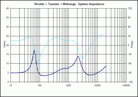

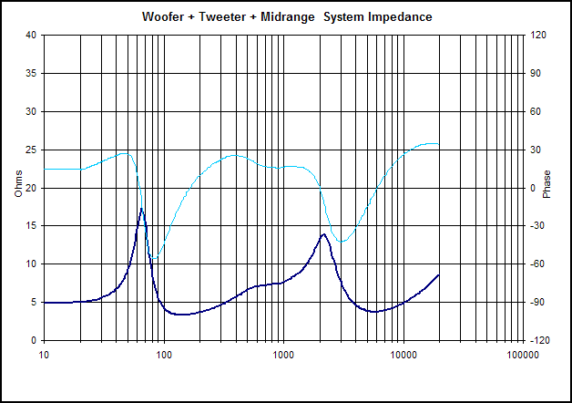

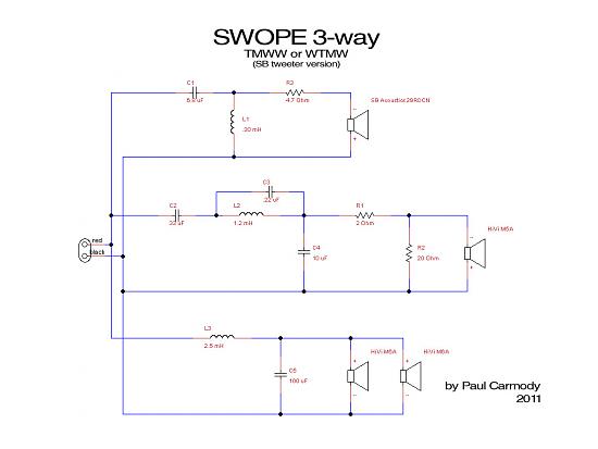

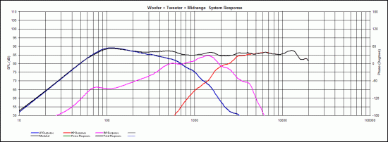

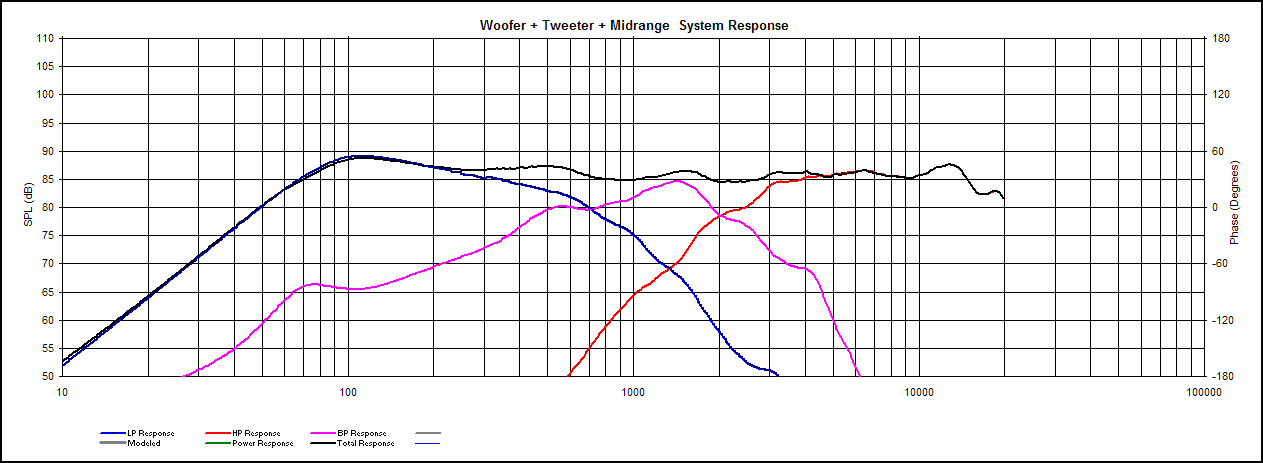

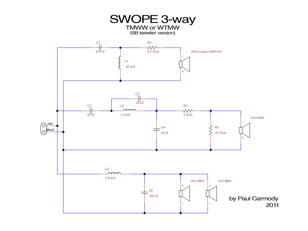

    And here is the crossover, Frequency Response, and Impedance of the same speaker using the SB Acoustics 29RCDN. It's a really excellent tweeter, and does indeed sound very similar to the Vifa XT25.
Name:	Swope TMWW XO (SB tweeter).jpg
Name:	Swope TMWW (SB) FR.gif
Name:	Swope TMWW (SB) Imp.gif
    Last edited by theSven; 02 August 2023, 16:05 Wednesday. Reason: Update image location
      Nice looking stuff! How's that ND28 hold up?
        • 1913
        So, Paul, these are just sims to this point for the crossover? Haven't played any music as of yet is that right?
        John unk:
        • Undefinition
          • 577
          No, no, this is the real deal. i've been listening to them all week. Guess I should have included some listening impressions.
          First, the HiVi M series have quite a pleasing midrange... not as "cold" as the Dayton RS drivers. The overall presentation is very "spacious." Imaging is quite good, and voices and instruments place themselves easily in the soundstage.
          The Dayton ND28 has been one of my faves since the first time I used it. It's easy to work with in a crossover, and it is very easy to listen to (unlike the DC28 ). It's being pushed to its limits in this design. It can keep up with the dual M6A--but nothing more. If you notice, there is no padding whatsoever in the tweeter filter on the ND28 version. (I believe cjd ran into a similar scenario on his massive MTMWW design)
          The choice between the Dayton and SB tweeter is probably dependent on the type of music one listens to. The SB is crystal-clear. Well-recorded stuff is immaculate on them. Poorly-recorded stuff (and mp3s) have all their flaws shown. The Dayton actually does a better job of "washing out" the flawed recordings, but on the other hand, they cannot bring you every little detail the way the SB 29RDCN does in the great recordings.

                      Can I use the SB tweeter in my present Swope CC? Changing just the tweeter crossover perhaps?
                      One thing I noticed about this speaker is how sensitive it is to different damping materials and the amounts of it. Maybe its something to do with the HIVi drivers as I started playing around with the damping after building the Overnight Sensations.
                      What did you use in your Swope CC? Did you stuff it tight?

                        Swope/SB CC crossover
                        According to the email Paul sent me after working up the crossover for the center speaker with the SB tweeter, the crossover is exactly the same whether you use the Dayton or the SB tweeter. I know. I was surprised by that also.
                        • Undefinition
                          • 577
                          Sort of. The coils and caps are the same. The resistor is a different value. And you're right, that it's very rare that changing a driver requires so little change in the crossover. I think it's mostly coincidence.
                          • Undefinition
                            • 577
                            Yes. I measured that, and tweaked the XO. It's a very slight change in the XO, and you can swap in the SB tweeter. PM me if you want the crossover for the SB tweeter.
                            FYI: the SB tweeter has a slightly larger flange than the Dayton
                            When I do sealed speakers, I tend to stuff them pretty densely. Vented, I try to use the least amount of stuffing (and/or lining) that is needed.

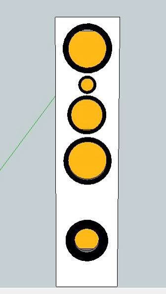

                                                I'm interested in a smaller cabinet. Any chance you have a drawing of the sealed version?
                                                • tashspop
                                                  • 15
                                                  Originally posted by Undefinition
                                                  It's two factors. One, the ND28 is a mellow tweeter. It's one of the un-hissiest tweeters I've ever used, and that's why I like it so much. Second, if you'd like more top end, I believe we can probably tweak the crossover a bit to your liking. You're free to try the SB tweeter, but I think we can get you where you want to go by changing a few components in the filter for the ND28.
                                                  i guess the absolute only time i notice this is when i'm watching HD concerts and i play with surround settings vs. stereo settings. i get alot more detail (upper range instruments) that come out of my L and R. those instruments arent there (as much) when i allow the stereo to go digital surround because the center handles most of the sound at that point. i am unsure if making the speaker brighter will be an upgrade for me for regular tv watching. i think for now since i am in love with this speaker on movies i will leave it be as is. after all i have alot more swope building to do for all the other channels.
                                                  has anybody built or started to build these new TMWW's yet? i would love to see some pic's and impressions. :T
                                                  • Undefinition
                                                    • 577
                                                    Do you mean TMWW sealed? Bookshelf or floorstander? (I suppose if you did bookshelf, it'd have to be WTMW or something) No I don't have drawings of that, but I can try to get something together, or help you create them if you want.
                                                    • kiteflyer
                                                      • Jan 2012
                                                      • 4
                                                      Bookshelf in the front of a living room. I'm thinking WTMW.
                                                      Cabinets that they would sit on are 33" tall and 24" deep.
                                                      I'd like to keep them around 24"-28" if possible.
                                                      Thank you for the email the other day--I'm the one who was looking for speaker advice.
                                                      • heapatrouble
                                                        • Feb 2009
                                                        • 48
                                                        I actually built the system as a wmtw (top to bottom) and that's what I shopped out to Paul for the crossover design. I'm afraid I hold all the designs for my speakers in my head, but if you're interested, I could see if I could sketch something out. My speakers are 24.5" tall, deliberately designed to use half the width of a 49" x 97" piece of MDF.
                                                        • Undefinition
                                                          • 577
                                                          Yeah, even if you could just give us the rough dimensions, I could draw up something more "formal" after that, if people want. I regret not taking measurements down while the speakers were in my house.
                                                          • kiteflyer
                                                            • Jan 2012
                                                            • 4
                                                            24.5" Tall is exactly the right height. WMTW would work great on my cabinets. How deep are they?
                                                            Have you put them in service yet? What kind of subs have you paired them with?
                                                            Paul, it would be awesome if you could draw a quick sketch.
                                                            I was also thinking that a slot port might look great on these.
                                                            Would a cabinet 25 tall, 9.5 wide, and 16 deep get close enough to 62.5 L??

                                                                              • djkest
                                                                                • Oct 2011
                                                                                • 23
                                                                                Awesome project. We may end up making 3 of these (L/C/R) w/ SB29RDCN tweeter. Will provide tons of info/pics if we do (if people want it)
                                                                                Couple questions if you don't mind.
                                                                                1) I like air cores. Would a 14 AWG Perfect Layer Air Core (DCR 0.36 ohm) be suffiecient for the woofer section, or would you go 12 AWG? Also thinking 14 gauge for the midrange (DCR 0.26 ohm), and 18 gauge (DCR 0.10 ohm) for the tweeter section. WWPCD?
                                                                                2) Electrolytic vs. poly in the woofer section- will it make a difference? Electrolytic is $2, Poly is $28-30
                                                                                3) If I use the SWOPE MT for surrounds, can I use the Dayton ND28F-6 tweeter (in combination with the SB29RDCN front speakers)? I'm thinking it would be fine.
                                                                                last but not least:
                                                                                4) If integrating this with multiple subs, should I build it sealed or ported- and does it matter if the subwoofers are also sealed or ported? I know there's something about phase alignments sealed vs/ ported. The center will of course be sealed.
                                                                                • witchdr
                                                                                  • Jan 2012
                                                                                  • 7
                                                                                  Paul, can I lay out the baffle like this?
                                                                                  Last edited by theSven; 02 August 2023, 16:06 Wednesday. Reason: Update image location
                                                                                  • Undefinition
                                                                                    • 577
                                                                                    That DCR is plenty low. Basically, compare it at the DCR of an iron-core coil of the equivalent inductance, and see if it's in the ballpark. As long as we're not talking about values over 1 Ohm, I don't think there will be much of a problem.
                                                                                    I'm not ashamed to use electrolytics. You don't need to be either. :B
                                                                                    Yes, that'll be fine. The overall voicing is going to be very similar. The SB tweeter can extract more detail from a recording, but with a surround channel, I don't that's going to be an issue.
                                                                                    last but not least:
                                                                                    The way I look at it is if you have a ported cabinet, you can always seal it, but if you build a small sealed cabinet, you can never get that volume back. My personal preference is to listen to stuff on 2-channels whenever possible. I do have a sub hooked up to the receiver, so if I'm ever in the mood, I just hit the switch, and the mains switch to "small mode" (which uses a HP filter at 80 Hz... essentially, acting like sealed speakers) But this is all personal preference; I also like my coffee with cream and sugar, while others like it black, you know what I mean? If one were a "subs always on" kind of guy, then I suppose the vented cabs might be considered a waste.
                                                                                    • speeddemon
                                                                                      • Feb 2012
                                                                                      • 16
                                                                                      Hello I am looking to build the Swope TMWW as well as the CC and TM's but I wanted to use the SB 29RDCN in all the boxes. Is there a crossover schematic for the CC and TM's using the SB 29RDCN tweeter?
                                                                                      • Undefinition
                                                                                        • 577
                                                                                        Hi speeddemon,
                                                                                        The SB version of the Center Channel has the same crossover as the 3-ways (see post 2 in this thread).
                                                                                        Unfortunately, I don't have a version of the TM that uses the SB tweeter at this time. I hadn't really planned on it (and don't have the drivers on-hand, either). Honestly, I think you'd be safe with the Dayton tweeter in that design. it's a great tweeter, and I was really happy with the sound of that speaker.
