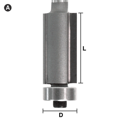

                                                                                        I was thinking about using this construction technique. One thing I can't figure out is, how do you flush-trim the edges? With a square speaker box, it's easy to use a flush-trim bit. I don't know that it would work on this shape though. Very cool. I found a place that sells bending ply, it's 3/8" thick. I was thinking 2 layers of that and 1 layer of HDF. I don't have a bunch of bags of salt to weigh mine down though- do you think you could still use straps ? Also what do you think of the structural integrity of bending ply- is it pretty solid? Obviously it's not baltic birch...

                                                                                          Originally posted by djkest
                                                                                          These look fantastic!
                                                                                          I can't find the website you got your walnut veneer from. The website you listed isn't right.
                                                                                          djkest,
                                                                                          In this case, rather than using a flush trim bit like below...
                                                                                          you'd use a normal straight bit, as you would for doing flush mount counter sinks - like this.
                                                                                          The router wuold be placed on the baffle, rather than running down the "side" to trim the side to the baffle. As you point out, the angle/slope would not allow this to work. By setting the router on the baffle with spacers under one side, you can then adjust the height of the straight bit down so that it is flush with the baffle surface. This allows you to run the bit across the surface of the baffle and into the protruding side panels... and in the process, trimming them flush with the baffle.
                                                                                          A visual can be seen in this DIYaudio post, here.
