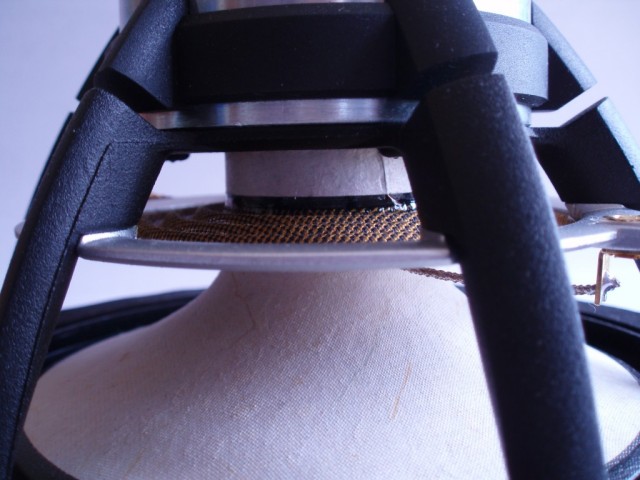

      The SATORI MW16R appears to be the final release version of the "ScAR" woofer I've tested a while back, or at least based on it. It was one of the best drive motors I have tested, but at the time, the cone was not final and I guess still being worked on. It used to be white and had a few breakup issues.
      You can't go wrong with the SB15, nice woofer.
      Zaph|Audio
      • Undefinition
        • 577
        If they release that SATORI driver to the public--and it's reasonably priced--I'll jump on board right away to work with it. The Thiele/Small parameters model amazingly well. Plus, look at that pretty, flat Frequency Response!

          I just checked with local dealer and he said that this model is not released to public yet but he'll try to get the item without any packaging, only driver. But it's not an issue for me I'm just waiting for the price, if I can get it less than $200 per pair, I should go with it rite
          anyway, why do I think that SB acoustic release the driver that a kind of ScanSpeak wannabe ? Existing woofer series look like the relevator, and this Satori just like Illuminator killer with reasonable price and fantastic T/S parameter.
