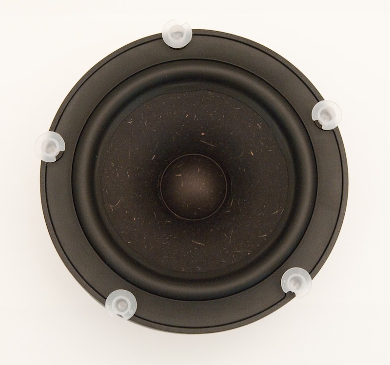

                                                                        Vifa NE180W 6.5" Midrange? Pretty pictures...

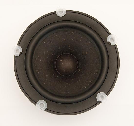

                                                                        Of course, everyone is going to have their own take on these NE180W. I'm thinking in a couple of projects as using them more like a midrange. No more disclosure than that for now other than what's otherwise been posted.
                                                                        Most of you guys are probably fond of full frontals, so here's one to start:

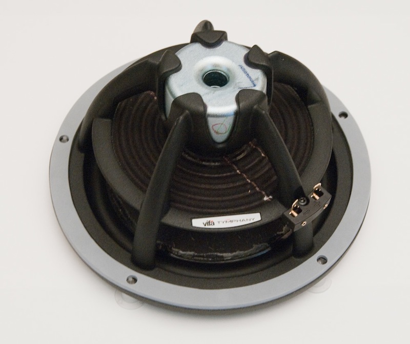

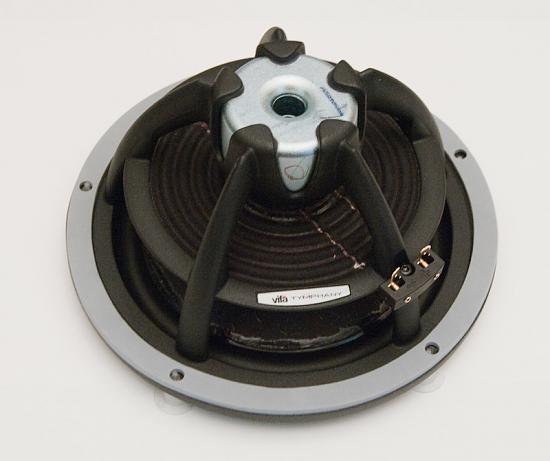

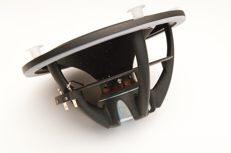

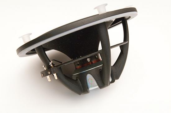

                                                                        For those more fond of the backside, well, you'll have your day, too.
                                                                        Looks like there's been some selective cost down in the final product versus prototype pictures- no fancy finning on the magnet assemblies.

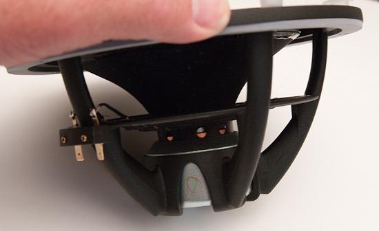

                                                                        The profile view is illustrative of the open construction and here we see the titanium VC former and coil out of the gap- unlike some Neodymium drivers, this is a compact magnetic system not using an underhung voice coil approach- undoubtedly a factor in hitting this price target.

                                                                        Though the small magnet and unusual frame design look fairly open, if you want to avoid the masking effects of the spider, some significant baffle bevel will still be required, I think. Still, it's going to be interesting to see how this design performs at this price point in the midrange.

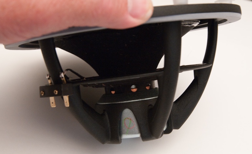

                                                                        Last, putting a little deflection on the cone, we can see that there's a pretty serious amount of copper in the total gap area... undoubtedly a big factor in the flat impedance curve, and one which hopefully will results in some nice midrange distortion numbers. Given what Tymphany achieved in the Peerless Exclusive 6-1/2" drivers, I'm expecting some great things... but will they go higher than 2 kHz before running into trouble?

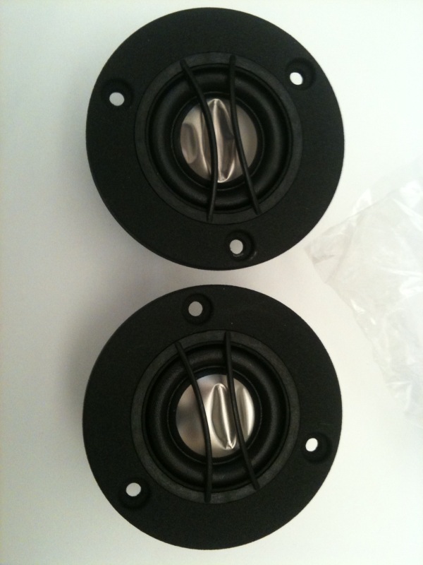

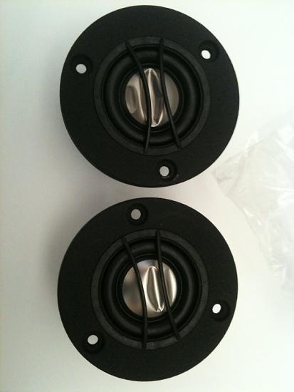

                                                                                      PE not having a good week...
                                                                                      Well, they shipped 1" AL instead of TI tweeters, AND all the tweeters received were messed up because of the packing- the boxes were fine, but the tweeters were wrapped in bubble wrap face to face. So the plastic grille loops easily slip through and mangle the dome.
                                                                                      Hope they can get the hang of dealing with bulk product from Vifa and shipping them properly.

                                                                                        what a bummer, like getting a toy for xmas and not having any batteries for it, and you cant get any for 2 weeks :M
                                                                                        guess thats part of being the first guy on the block with a new toy
                                                                                          Click image for larger version  Name:	Vifa-TT.jpg Views:	5647 Size:	83.9 KB ID:	854403
                                                                                          Those are nice.....
                                                                                          I've seen this with Madisound and PE. They buy the things with OEM packaging (in lots of 50-100) and they kludge together some crude method of shipping them that results in a lot of damaged product.
                                                                                          They should have ordered them with a retail package where the tweeters are individually packaged in a way to prevent damage. I bet a high proportion of this first order is literally wasted because they didn't square away the shipping details. You would think a company like PE would have this figured out.
