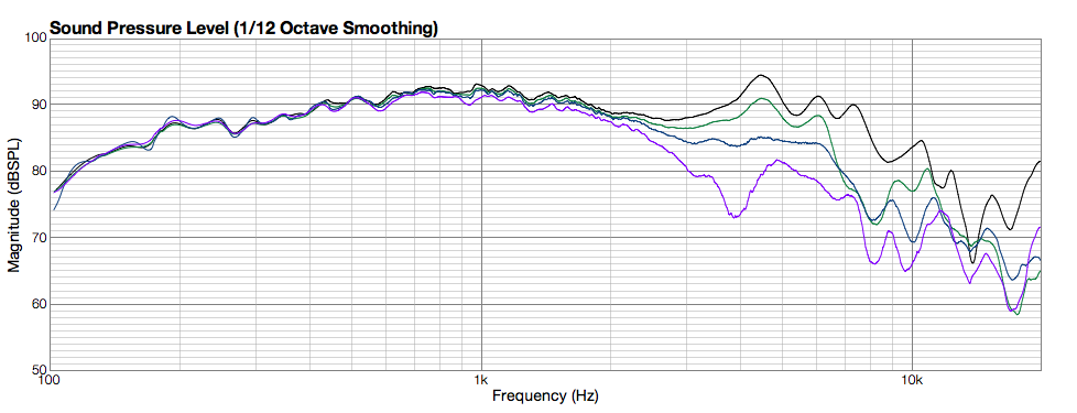

                          I'm not Jed, so perhaps I shouldn't intrude- I'd remind you though, that the nominal crossover point will depend a lot on the kind of target function you choose; the wider the driver overlap (lower order), then the more restricted the bandpass range.
                          Considering the driver performance, and limited Xmax,
                          This is measured with a nominal baffle width of 9", at 0 degrees, 15 degrees, 30 degrees, and 45 degrees.
                          A working range of 250 to perhaps as high as 2500 Hz might be reasonable; presuming you want consistent off axis performance. Let's remember that the much smaller C79 is usually crossed at about 3500 Hz max. A lot comes down to what sort of tweeter you match to it, and how steep a slope you think it needs, and whether you want to control the group delay of the overall system response. A target transfer function I'm looking at for this driver in a three way system would have a nominal 2 kHz upper crossover point, and a lower point at -6 dB of about 350 Hz, perhaps a little lower. Perhaps not.
                          I'm curious what Jed chose in his speaker pictured in this thread. :W

                          • Jed
                            • 3621
                            About 360hz and 2.2k.
