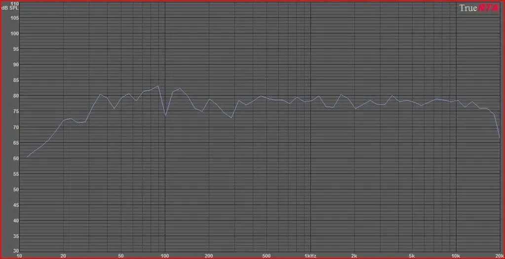

          Hi Paul,
          Out of curiosity, have you ever measured the in-room response of your vented system? It will of course vary per mic position.
          Here is a 1/6th octave shot at about where my head is, seated in my listening chair, showing the extension of the non-vented system you heard at Lexington (undoctored ).

          cheers,
          AJ

                      That's an amazing in room response... are you using room treatments? :E
                        I have a velvet elvis on the right wall.
                        I don't believe in room treatments. The design of the loudspeaker must make the room behave, not vice versa.

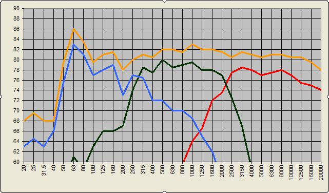

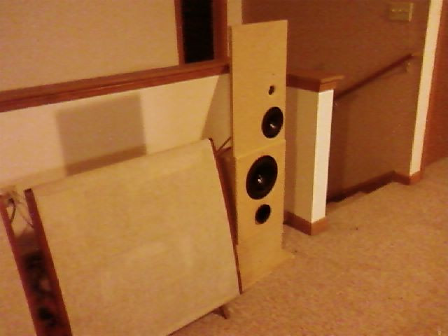

                                      Paul, I'm interested and I'm already one step ahead of you. I started my project over a year ago and it includes a single RS225S-8, a single RS150S-8 and a horn loaded Seas 27TBFC_GTV. This is where I'm at:

                                      That's my old DQ10's next to it.
                                      So far it's sounding pretty good. Here's the in room FR from about 10 feet:
                                      Notice that the divisions are 2 db, so it's getting very close to flat. I'll start a thread on them soon, but first I want to finalize the crossover and get a coat of paint on them.

                                      The PEDS 2.1 mini system
