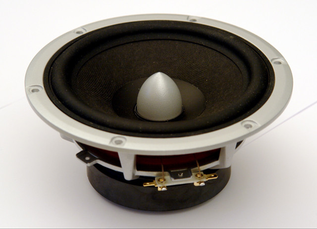

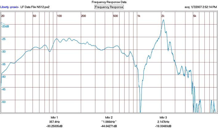

          The flat baffle for the Isiris with it's current driver positioning worked out as simulated; don't be surprised if you measure somewhat near field (1 meter) at the typical listening distance by the null in the upper midrange due to path length differences between the woofers. It's of no consequence anyway, as you shouldn't be using them up to 1 kHz.
          All the usual things still have to be dealt with in the crossovers if you use metal cone drivers- see the last posts on the Arvo Heavy Metal testing thread in Missions accomplished for some alternative ideas about crossover and EQ.

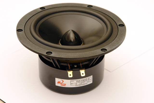

          Rear wave masking for drivers is an important aspect for any system design, it becomes more obvioius in the case of dipoles, as does pole piece venting and freedome from chuffing noise at higher driver excursions. Unfortunately some of the better drivers with regards to rear masking are also some of the more expensive ones, but not in all cases. Contrast the RS180 and Peerless 830883.

                      I got a pair of Peerless Exclusive 8" drivers before I realised they had a 900 Hz dip, so they were unusable for a nice two way design. So now I've scratched that project.

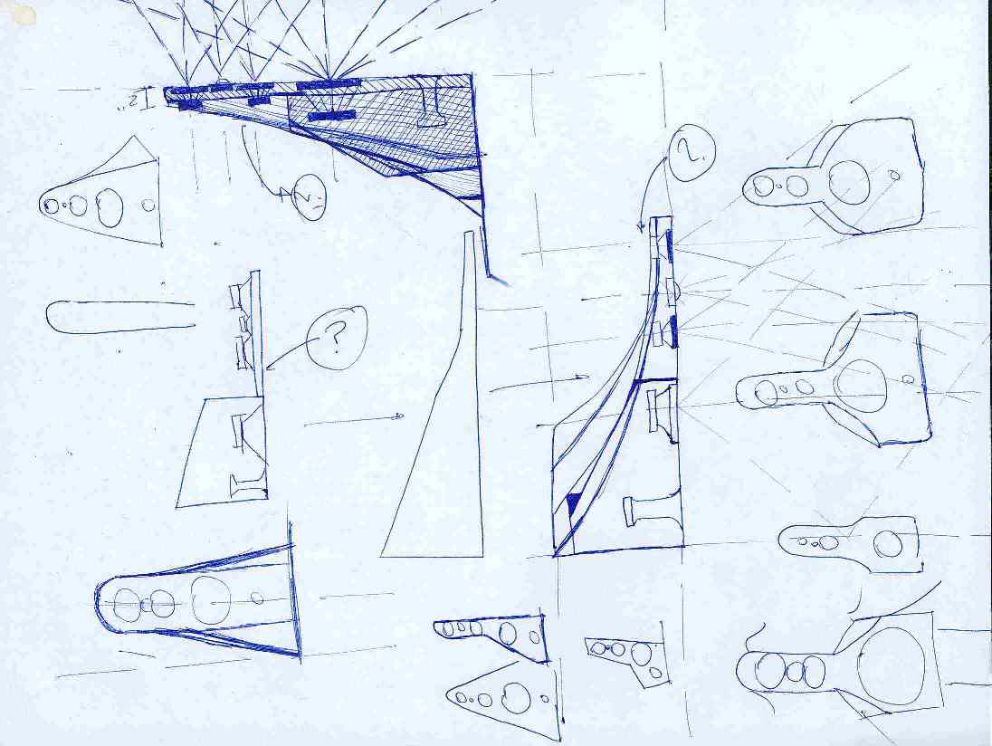

                      I've been sketching a couple of ideas I had. Mostly, they either look like a MartinLogan or like Linkwitz' Orion. Coincidence? I think not
                      My concern is getting enough efficiency from the RS125's. I suppose I won't be getting more than 80db/W from a pair of those drivers on a dipole panel.
                      Javier Huerta
                        When you make it that narrow at the top, you bet you'll have trouble getting output from small drivers.
                        You might also be surprised.
                        Mock. Measure. Test. Put together a simple baffle, play with shape using cardboard or taped on chunks or whatever. Just experiment. You'll learn ten times, and then have specific "what causes this behavior I noticed" questions and stuff.
                          The Peerless Exclusive 5.5" doesn't have the dip and the sensitivity is about 88 dB for a single driver. Crossed high enough, you shouldn't lose much of that on an open baffle. A pair of the 12" SLS look like a natural for the woofers; two in parallel rolled off at 6 dB for the open baffle should match the sensitivity of of the single 5.5. Cross them at the 'knee' of the dipole roll-off to minimize components and ease the crossover design. Cross to a sub at 80 Hz or so and you've got plenty of SPL. Of course, that's just bench racing.

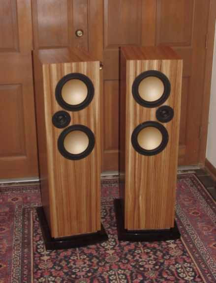

                                            Well, I think he means more like the HiVi M8a MTM like we did for a few folks, including Tibor in Denver.
