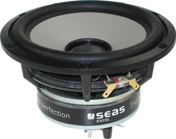

    Just saw that Seas is releasing a new Excel-line coax. Seems pretty interesting, hopefully it will be followed by a W22 variant. :B
    They're also hinting about an upcoming subwoofer! :P
    http://www.seas.no/index.php?option=com_frontpage&Itemid=1&limit=1&li mitstart=0
    http://www.seas.no/index.php?option=com_content&task=view&id=234&Item id=221
    Last edited by theSven; 18 August 2023, 08:45 Friday. Reason: Update image location

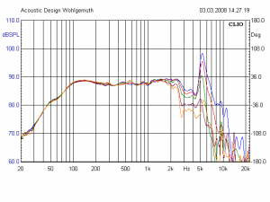

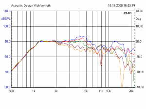

                                                Well, there's off axis responses provided in the link from Irwin AR.
ID:	948386Click image for larger version
                                                Last edited by theSven; 18 August 2023, 08:49 Friday. Reason: Update image location

                                                  Dave,
                                                  There isn't any claim from Seas that the woofer cone is a waveguide for the tweeter. Even if they were to attempt it the diameter is far too small. The claim is simply that the "tweeter is integrated with the woofer to form a 'point-source'." Also, Seas has included all their normal off-axis measurements. Look more closely at the data sheet.
                                                  Anyways, on-axis measurements are going to be deceiving, to say the least. I've done quite a bit of fiddling with the T18 coax driver. As soon as the microphone is moved even a few degrees off-axis things look much better.
                                                  Cheers,
                                                  Dave.
                                                    Hmmmm..... They aren't labeled but, if we assume blue is on axis and red is 15 degrees off, 15 is where we see that big null at 8K.

                                                      I haven't gone back to the Seas site recently, I didn't recall there being off-axis data. Looking at the graphs in Jonasz post, I could live with the woofer, but that tweeter response is all over the place, just as it is with the Insignia I experimented with. The tweeter is so badly loaded by any standard driver, small or large, if it's not a true waveguide, evidence in those graphs above. A so-called "point source" is not an optimal situation if the "waveguide" formed by the midwoofer has the impact it does in these and most coaxials. It's contaminated with diffraction effects that are very audible. The only real reason I can see to use one of these would be if space limitations dictated it (maybe a ceiling unit found in stores?).
                                                      The only reason that the Insignia is worth anything is as a bang-for-the-buck system. It can be improved at low cost keeping the total cost low. It can't be made to sound as good as most decent 2-ways with separate drivers, despite the coaxial (not coincident, there's still some offset) configuration. There is no single axis on which one can create a reasonably flat response. The overall power response around the crossover and above fluctuates too much, even if some single axis could be made flat. I just see it as too much money for too limited results. I would have expected better from a new driver. Just my opinion.
