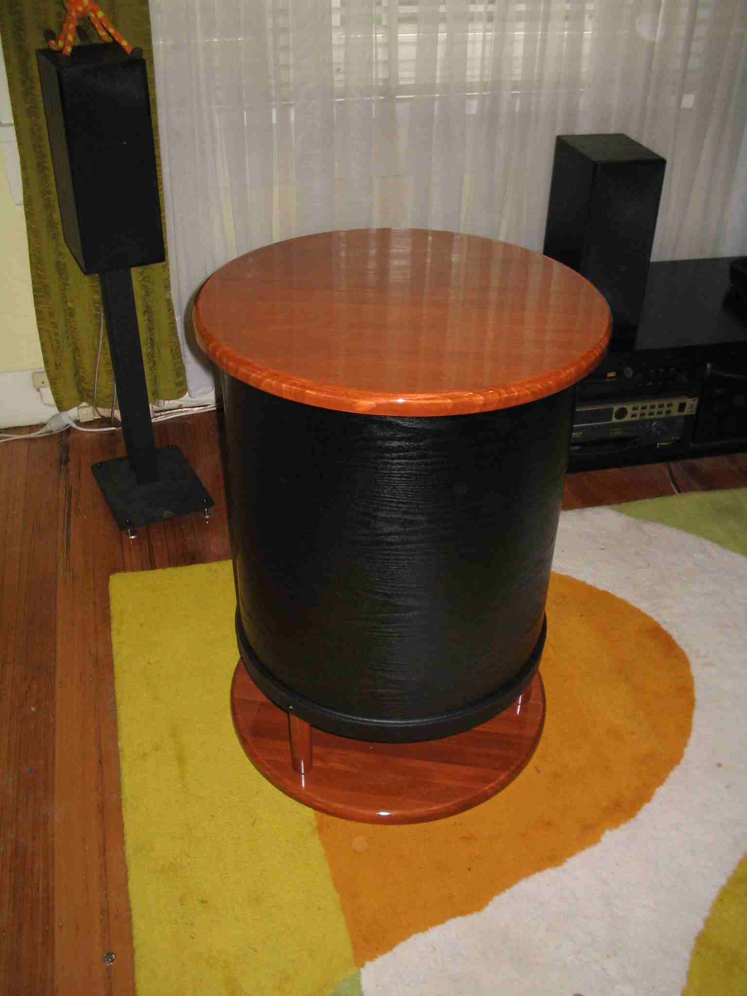

                      • rnoble
                        • 54
                        Hi guys,
                        Sure sub's can be used as furniture, here's mine which have a very high SAF. I plan to make a twin for my new HT room. The coffee table idea is even better IMO as mine is more like a side table.
                        Mine is also a tempest but sealed.
                        Cheers
                        Rod
