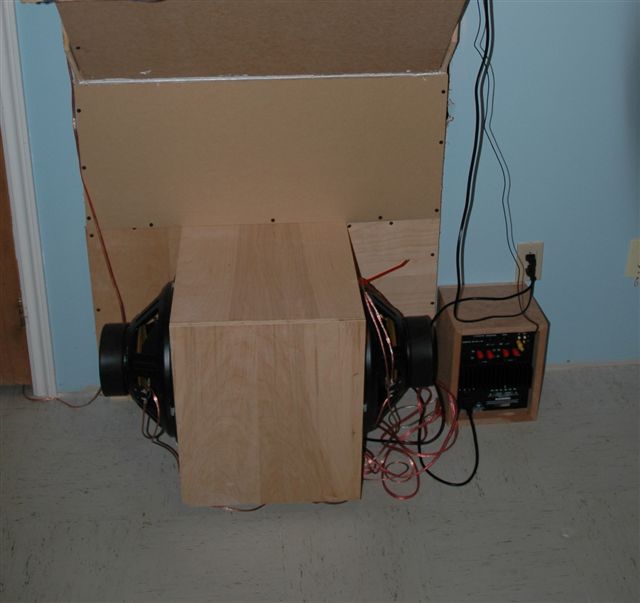

                                            • taz13
                                              • 930
                                              And if you have an adjoining room Tempests give a reasonable cost way of experimenting with IB subs.
