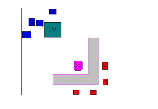

    Hello all,my first post
    I am in setting up a 7.1 system. My room has 4 walls with a door on every wall. I'm restricted onwhere I can put my rear speakers. Please look at my picture of the room dont laugh).I will be using paradigm speakers to match my front setup. What paradigm speakers do you suggest.
    My thoughts were to use adp-370 on positions 1&4 and mini moniters on position 2&3(with wall brackets) All speakers must go on wall.
    The purple box with a x on it is the sweetspot where i want the best sound to be.

        Well I want to future proof my setup,but not knowing were I will be moving to
        I can't.So what would be good for a 5.1 setup? adp-370 at positions 1&4 ?
        I have had a 5.1 setup for a while now,but the speakers did not timber match the fronts. They were also directional in sound image.
        80% movies 20% music dvd's

                I dont think it will work with my seating with direct radiating type speakers.
                I think i got myself talked into the adp's.

                      THats how I had my setup last year when i moved into the house, very similar with my 2 ch setup.

                        My setup is very similar to the diagram that Jason posted and it works pretty well. I actually have my surrounds in the top shelf of bookshelves to the left and right but other than that everything is the same. The only thing I would be careful about is the sub placement. I have mine behind the TV like in the diagram and it has two advantages 1) out of sight and 2) good integration with my main speakers. The main drawback is that I also have a nasty null at 57Hz. If you are able to move the sub around a bit you might find a better location, that really just depends on your room dimensions and the choices you have in locating it.

                                My only thought on the picture is not the sub but the rears. I believe they would need to be set at an angle to the wall so as to poit toward the back of the listener. The pic shows them at 90 degrees to each other.
                                Just make some wedges or get some mounts

                                  I would not recommend the adps in your situation go with 4 mini monitors. The adps are designed to be directly to the left and right of your listening position. I would also recomend these mounts http://www.jr.com/JRProductPage.process?Product=17529 they might seem a bit pricey but they are worth every penny. The mini monitors are quite heavy but these mounts can handle them. When mounting my minis I used the small wood screws that are provided to secure the speakers from underneath along with the side clamps.
                                  Go for the 7.1 you might not always have your speakers in that room and who knows when the wife will let you buy more Worst case, if you dont like 7.1 go back to 5.1 and you have a set of kick butt bookshelfs for the office
