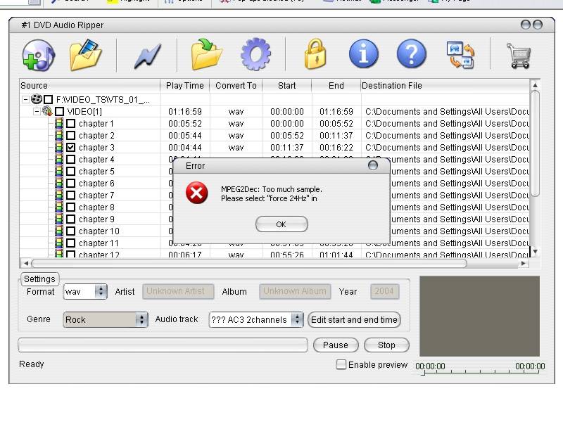

      I'm looking at this as well. I've been trying to figure out how to convert the Dolby Digital track on my non Dual-Disc DVD-A's to wav so that I can burn it on to CD for listening in my car or other non-DVD capable players.
      I ran across this program:http://www.dvdtox.com/dvdaudioripper.htm but keep getting this error message:
      Now that could be as I don't have the "registered" version but I don't want to pay to register something that so far hasn't worked....
