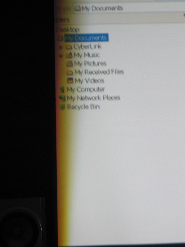

    Can any one help please. I have an infocus 4805 and when projecting there is a brownish line down the right side. Is this a lamp problem. I have taken the lamp out and cleaned as per instructions but this has not helped. Im lost as to what to do.

    Is it a straight line? Clearly defined edge? If it's more like a blob than a straight line, it's probably dust in the optics somewhere. Can you post a pic? Do you see the line when projecting a solid white or gray image? Black image?
    IIRC, the 4805 is DLP, right? If it's LCD, it could be a polarizer panel going bad (sometimes they burn up from the heat).

      attached photo of brownish screen projection. Any help please ...

            It's probably the dreaded 4805 light tunnel failure. You'll either have to cough up repair money or do surgery on the guts of the PJ to remount the mirrors lining the light tunnel, since one of them has come unglued and is blocking the light path:

                light tunnel problem
                Photo uploaded. Thank you for your help ... not sure if I can do myself. does anyone have instructions to fit this.
