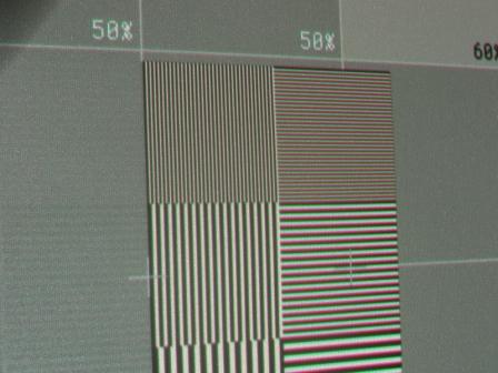

          the Mitsubishi looks ok with 10K:1 CR but if you can bridhe the xtra $2400. to the RS1 it's a much better machine. Remember that convergence has always been a problem with 3 chip LCD and I don't see any adjustment on the Mits? It would drive me nuts to pay $3200. and see a Red or Blue fringe around object like This Ruby. Also, when they throw in nonsense like "HQV processing" (Hollywood Quality Video) " it's always makes me feel like i'm looking at a product targeted at suckers. :roll:

            The RS-1 isn't exactly perfect with misconvergence either given the lens design. And all LCD is 3-chip, so it's not like you can have LCD with perfect convergence. If you get panels that are just way out of whack send it in. You'll never see most of it during movie playback anyway, and test signals only make you go cross-eyed.
                I sit 9 feet back from an 8 foot screen, I can easilly spot MC,720 pixels, and screen door. While the RS1 might not be perfectly convergable across the entire screen at least it's got SOME adjustment. Oh and test patterns are my forte, as a CRT guy I can stare at test patterns for up to 4 hours before I get dizzy. :B

                  At 1.0x screen width I'd believe you could see pixels... that's close! 8O
