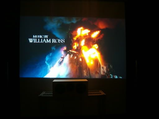

    ...but I'm a little dissapointed in my black levels as of right now. Here's a picture I took today. Since my camera is absolutely horrible, it doesn't show how great this projector is. However, you can see that the contrast levels cannot be 5500:1 as claimed.
    This is most likely due to my white walls, carpet, and ceiling, but how much better do you think I can get if I repaint the walls Behr Song Bird, which is essentially, blue, and also replace my screen with a higher-contrast silverscreen DIY screen?

    there probably is that much contrast range, but it's going to be at the upper end of the spectrum, if your looking for true black's not even the Sony Ruby can do that. the only projection Tech. that can slam to full black is CRT, and it's all meaningles in a lit room because black is the absence of light, you don't "project" black.

    This is a big problem in most DIY starter home theatres. I would try and stay away from pure colors like Blue because they will cause a color shift on your screen. Go with very dark Gray-blue if that fits your taste. Of course black walls ,ceiling, and floor are perfect if the wife will go for it.8) A dark ceiling, black screen wall, and a dark rug in front will get you 80% of the way there.

      Colored walls and ceiling will do wonders for you. I use a very dark midnight blue that works very well. Looks black with the lights off watching a movie. With lights on, brings life and a bit of color to the room instead of just flat black.

        The 5500:1 claim is for full on/off (thanks to the iris), which is different from mixed-scene/ANSI. I find the perceived contrast is about the same as my 4805, really quite good in my darkened, light-controlled room.

          Ideally, yup the room should be flat black, other options include a "neutral" dark grey or otherwise VERY dark shades of which ever colour you prefer in that order.

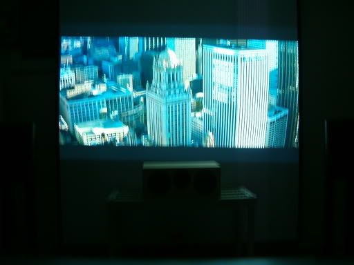

                          well I got the painting partially done(one wall to go) and here's the most recent pictures, still taken with a horrible camera.
                          Next will be getting the final screen built. I did a test where I covered the parts of my ceiling-to-floor screen (it was free) that I wasn't using with a sheet that was similar to my wall color and that also helped.

                            Excellent job on your HT. An inexpensive piece of felt placed over your center speaker will absorb the bright light coming off your screen. Cost $4 per yard from Jo-Ann Fabric.

                              I'm going to paint it this weekend hopefully while I'm building the frame for my screen, along with hopefully finishing my center stand.
