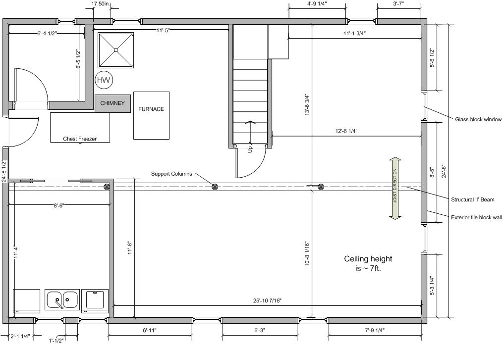

        Ward, do you have any pics or drawings of your area? I am using the same setup (4805 with a 96" white screen) in my basement, my projector is 12 ft away from the screen with no keystone correction used. I have some challenges as well, I have a 8ft ceiling but my projector had to be mounted 14" down behind a huge 4ft soffit. but it works well with some light scattering off of the ceiling.

          Thanks for the responses, here are a few things I mulled over at work today:

          3) I do have a Visio drawing of my basement, I'll post it on my web & add a link.

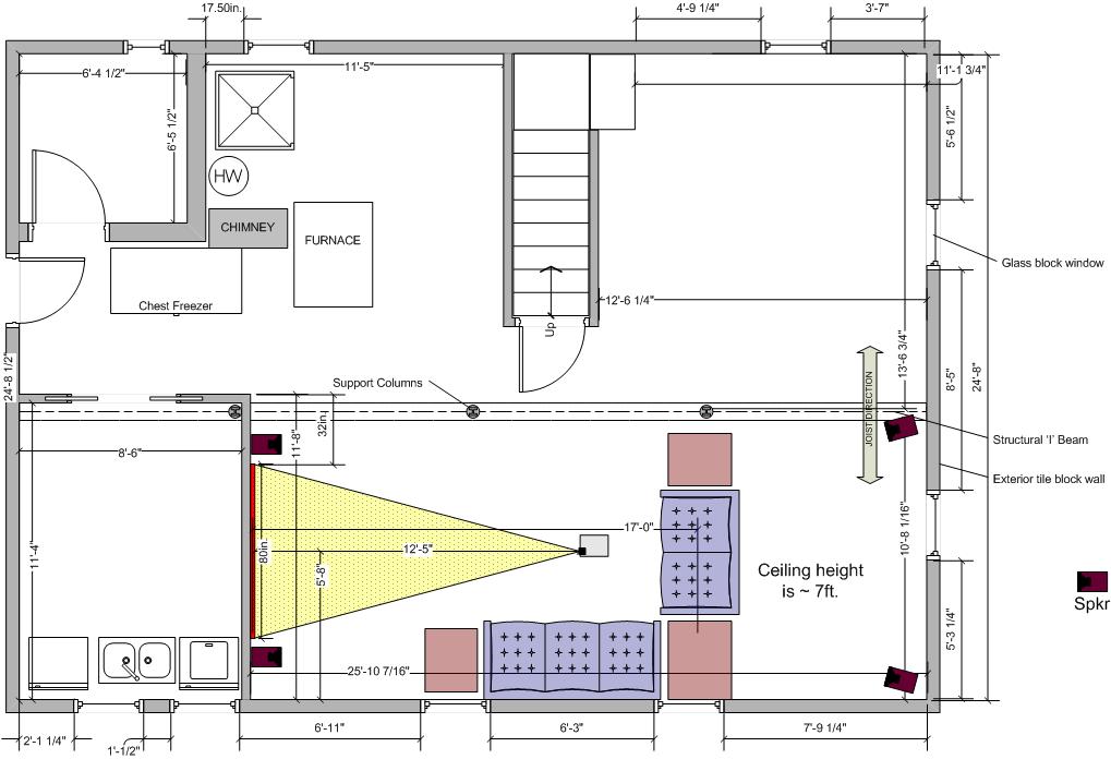

          4) I was a little bummed about the offset of 27%. This equates to 4ft H screen + 1 ft offset from ceiling = 2 ft left on the floor for a center channel. I hope when Jon mentioned a 'squat tower' center he REALLY meant squat! :rofl: Although lately I've had the cc disabled and enjoyed it more.
          I think I'll just have to play around with positioning the pj and see what I can live with and what I can't. The ~5 meter rule on DVI cables looks like a problem. Although that max length varies with the source output level. I wonder if you can mod the cable with a pull up resistor to increase the length? All great winter time endeavors.

            I meant to ask you, what kind of questions, and what did you end up choosing? I have a minor concern about not being able to use this with a ceiling mount due to the projected angle going down to the bottom edge of the screen. I'm afraid my head may be in the light path. If so, I may have to forego a permanent install and opt for a movable table.

              I would have had a problem with image offset. Using a 92" screen with the top of the screen at 6'5". (Soffit) I also wanted to use the ceiling mount option. The bottom of the screen would have been a little too low. I didn't want to have my feet in the way when reclining in my chair. My rear seating is on a riser but the low screen still could have been a problem. I ended up going with the Sanyo Z3. I know it's LCD, but no fear of the RE. My wife is slightly succeptable to it. Doesn't bother me though. I really love the lens shift option. That way, you can mount the projector close to the ceiling.

                Robert, I found that Visio drawing. Here's a pic:

                  Hi Ward,
                  Here is what I have done with my "new" Staples' 4805 PJ. Since I'm a nob, had nowhere to view many projectors, and watch one or two DVDs per week, I decided to start inexpensive and combine a lot of DIY to the room.
                  I have a light controlled 19'x13' finished basement room with a 6'5'' drop ceiling. I picked up a 4'x8" sheet of Parkland’s Polywallfrom Home Depot, as my diy screen and used Burke's suggestion to surrounded the screen, front ceiling, front side walls and front floor, with black felt. As a start, I placed the 4805 on top of a new 6' wooden step ladder (yes, I have two young children and a dog 8O ) and placed the equipment below on the ladder's steps. 4’x4’ sound absorption panels are located on each side of the ladder. The screen is positioned 20" above the floor. There is room for a center channel on incline, yet since my speakers are very good at imaging (imho), I've opted not to go five way. A couch is located 14' from the screen, with the pj at 16' from the screen. The projection fills the entire 4'x8' screen. My front speakers are located 3' from the front and sidewalls for better imaging. So far, everything has exceeded my expecttions.
                  Regarding your layout, it’s hard to know where all of your walls are, but can you shift your theatre clockwise 90 degrees? This would put your left speaker in the corner next to your stairs, with the right speaker in the outside wall corner. At least for my ears, sound bouncing off one close wall combined with sound bouncing off a furnace never quite sounded that good.

                    Originally posted by Marzen
                    ...I have a minor concern about not being able to use this with a ceiling mount due to the projected angle going down to the bottom edge of the screen. I'm afraid my head may be in the light path. If so, I may have to forego a permanent install and opt for a movable table. Ward
                    Well, that problem is solved. I looked at several mounting systems and decided to just make one at work out of aluminum plate. Any pitch or roll can be shimmed with washers and it should be completely flush to the joists.
                    Thanks for the feedback Craig, that's an ingenious way around your problems. I don't think I'll be able to use the north eastern corner of my basement for numerous reasons, mainly due to the hvac extended plenum I'm installing down the center of the basement parallel to the I beam support.
