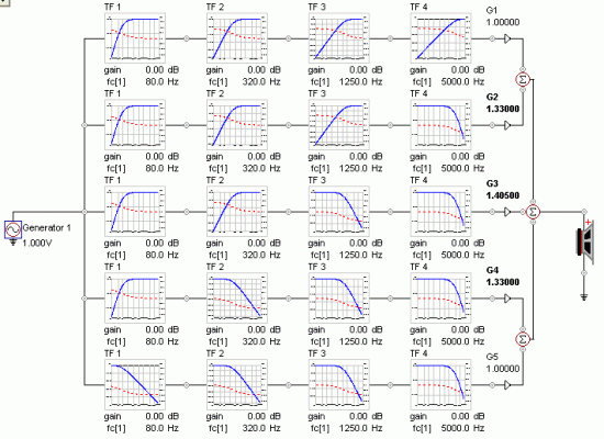

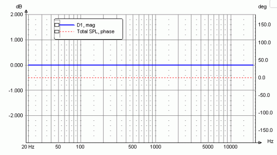

    I was sitting around today, wishing I was at RMAF with the gang, and doing my usual multitasking thing -- watching the ballgame on TV and fiddling around on the computer. I was thinking about the old Dunlavy speakers where he uses lots of drivers with 1st order acoustic crossovers to get so-called 'transient perfect' response, meaning they will play a square wave and what the mic picks up looks something like a square wave.
    The problem with 1st order acoustic slopes is almost no drivers can handle that. I got to thinking about the Duelund concept where you stack 2nd order filters at all the XO frequencies and the ultimate roll-off for most of the drivers is steeper than 2nd order. If you did the same thing with 1st order filters, would the sum still retain its 'transient perfect' behavior?
    The answer is YES. Shown below is the theoretical schematic for a 5-way so each driver only has to cover 2 octaves or so. It's just cobbled together with active transfer functions to look at the summed magnitude and phase. Each driver has 4 1st order filters, either highpass or lowpass, all at the same frequencies. Notice that I had to increase the gain of the middle 3 to flatten the response. Once I got the response flat, the phase flattened out and the square wave shaped up.
    To build a practical speaker like this, you'd probably need 9 drivers -- W-MW-M-MT-T-MT-M-MW-W. You'd also need a sloped or stepped baffle ala Dunlavy to align the acoustic centers. The big advantage over a Dunlavy would be the steeper acoustic roll-off in the stopband. You might be able to pull it off as a 4-way with the right drivers but I think a 3-way would be pushing it.

    Why do you suggest using 9 speakers vs 5 for this design? It seems to me that 2 drivers covering the same range would smear the impulse since you could no longer derive the exact origin of the wave.

      1st order crossovers have weird lobing unless you do the MTM thing. As well, the sound source moves up and down quite a bit as the pitch changes. You could make it work with half the drivers but Dunlavy always seemed to go for a symmetrical layout.

        I am having a hard time imagining how to create this inside of PCD.
        --I assume that all of the filters above are 1st order butterworth filters with a q of .707.
        --Using Arta - Which test can help me to capture a square wave.
        --Could you describe the geometry of the drivers that you simulated above?
        --Does the square wave hold up at different values?
        Note: After reading more of the 1997 Dunlavy posts it seems that the dual drivers were used to control beam width.http://gonecatfishin.net/John%20Dunl...sts%201997.htm

          Right on the 1st order Butterworth. Technically, there's no Q for a 1st order filter.
          In ARTA, the latest version lets you record an impulse from an external source -- gunshot, popped balloon, whatever. It also works as a pretty good triggered recording scope. Tell ARTA to start recording, then start a square wave playing from another app, say the demo version of TrueRTA. The advantage of a triggered scope over the scope function in TrueRTA is you capture the first few cycles before room reflections muck up the signal.
          There's no geometry in the sim, just summed electrical signals. Whatever you do for geometry, each driver's acoustic center needs to be the same distance from the ear at the listening position.

                Hi Dennis,
                Yes, this can be done at infinitum. What you are basically doing is setting up a system transfer function composed of the product of 1st order TFs with different poles.
                Tf(s) = (1 +S1)/(1+S1) x (1 + S2)/(1 + S2) x ..... x (1+Sn)/(1+Sn) where n is the order of the TF. Since each component (1 +sx)/(1+sx) = 1, then TF = 1.0 and you can then factor the numerator to get different band pass, HP and LP filters.
                LP(s) = 1/[(1+S1)x(1+S2)x...x(1+Sn)]
                HP(s) = S1xS2x...Sn/[(1+S1)x(1+S2)x...x(1+Sn)]
                The band pass filters are composed of what is left of the numerator.
                Your construction makes it a little easier to see the result.

                    The idea is cascading poles. Whether this still really fills the concept of a "true" first-order filter is where I think you're getting caught. Simplistically, if you had drivers spaced two octaves apart, the first two octaves would roll off as a first order, then the slope would increase to a second order as the next pole kicked-in, etc. This would help to limit (somewhat) how low tweeters have to go and how high woofers the need to go, but you will still be placing a fairly decent acoustic load on each.
                    For example, the "supertweeter" will be down <20dB just above 1kHz, assuming my math is right and depending upon Fc, when the second pole kicks in (simplistically: Fc(1) ~ 5kHz, Fc(2) ~1250 Hz; each Fc is -3dB, 6dB/octave, 2 octave spacing for each pole). In other words, you are looking for something that can handle LR2 at ~1.5K for a tweeter, which is a pretty special ($$) driver.

                      Actually, n is the order of the TF. In the system TF there are n poles which can be at n different frequencies (though not required). When you multiply out the TF you will have an nth order polynomial.

                        John - If you don't use different Fc for each pole, wouldn't this no longer be a first-order filter?
                        • john k...
                          • 68
                          Hi Bear,
                          Let's see if I can make things a little clearer. The system TF is composed of the product of n 1st order transfer functions. Thus, the system TF will be of order n as will each of the individual filters for the drivers. The poles of the transfer functions can be unique or all the same. The system will require at most n+1 drivers.
                          The classic case is when n = 2 and the poles at the same. The system TF is
                          (1+s) x(1+s)/ [(1+s) x(1+s)] = (1 + 2s + s^2)/ (1 + 2s + s^2).
                          The TF's for woofer, mid and tweeter are:
                          W = 1/(1 + 2s + s^2).
                          Mid = 2s / (1 + 2s + s^2).
                          T = s^2 / (1 + 2s + s^2).
                          Some of you may recognize this as one alignment of th B&O filler driver crossover where the woofer and tweeter have LR2 responses and the mid is a 2nd order bandpass response (i.e. it rolls off 1st order above and below the center frequency).
                          Now, the actual choice of where the poles are will effect the required gain of the pass band filters, etc.
                          Also note that the system can always have just two drivers. For example, when n = 2 the woofer could be
                          W = (1 + 2s)/ (1 + 2s + s^2)
                          and the tweeter
                          The acoustic response of the woofer in this case would be identical to the summed response of the woofer + mid in the case where 3 drivers were used.
                          The key here is that we are always starting out with a system TF that = 1.0 since the numerator = the denominator.
                          The problem with these type of crossover is that they can have very uneven polar response with off axis peaks as high as 6dB and on axis there is a requirement that on axis the out put of various driver must cancel to obtain flat response. That is, the inter driver phase differences exceeds 120 degrees.
                          John k....

                                  Here are acoustic target curves for the rest of the drivers.

                                  One important point, these curves are oversimplified. They ignore the low-end roll-off of the woofer and the high-end roll-off of the tweeter. Those two roll-offs should be added to each of the curves to keep the phase and group delay working the way it should. If your woofer rolled off 2nd order at 20Hz and your tweeter rolled off 2nd order at 25K, this is the best square wave you could hope for if you did everything right.

                                                      Okay, this thread is due for a revival after being referenced by Dennis H on another forum. Also today Zaph posted his test results for the SS 10F midrange, and suggested that its unusually flat response opens the door for a unique application.
                                                      Here's a suggested lineup for Dennis' 5-way crossover:
                                                      >5 kHz : Vifa NE19VTA
                                                      1.25 kHz - 5 kHz : SS 10F-8
                                                      320 Hz - 1.25 kHz: SB15-8
                                                      80 Hz - 320 Hz: SEAS L26
                                                      <80 Hz: Peerless XXLS 835017
                                                      Based on my predilection for OB, the top 4-way is dipole while the 12" is in a box. To avoid seismic hazard there is only a single woofer at the bottom.
                                                      As luck would have it I have all these drivers on hand other than the L26--but do have some RS270s...

                                                            In keeping with the theory, yes. I'm not really building this, it was just an inspiration that these drivers could work for the Dennis H 5-way Transient Perfect Mega-Tower.
                                                            In reality this crossover would take extensive experimentation to pull off, and the cabinet is pretty imposing. If it could be done with a DCX2496 I'd consider making a mock-up, but I don't see how that would work. It would probably take several in a daisy chain.
                                                            More the point, this concept appears to incorporate the big idea behind Dunlavy speakers while also improving on their major fault, which was running drivers too far outside their comfort range. That results in excess distortion and coloration. At least that's my understanding.
                                                              Duelund XO: the Big Concept
                                                              by Dennis H
                                                              The big concept of the Duelund XO can be summarized as "all drivers in phase at all frequencies." To do that, he stacks LR2 filters when using 3 or more drivers. For example:
                                                              Woofer: LR2-400 lowpass, LR2-2500 lowpass
                                                              Midrange: LR2-400 highpass, LR2-2500 lowpass
                                                              Tweeter:...
