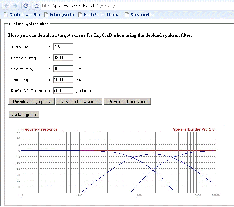

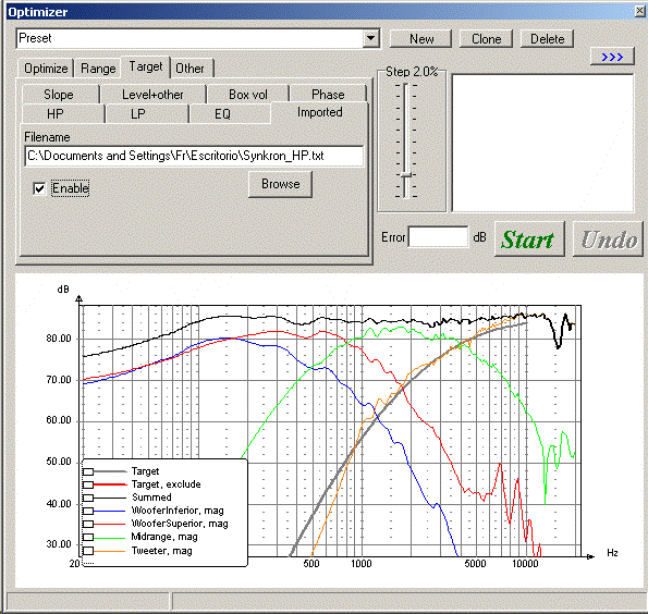

      OK, so the RS-52 can't go much lower (if at all) than 850 Hz, as used on the ZDT. So I began from there. Considering the size of the frame of the RS-52 and the Vifa, a 4 KHz x-over point seemed to fit perfectly with the requirements of a Duelund crossover, and were pretty close to where I was at that point.
      So I loaded the curves on the Duelund web software calculator.
      Apparently, everything will be fine. Other than a problem with some extra output from the tweeter (I didn't do anything about its Fs), it looked doable.

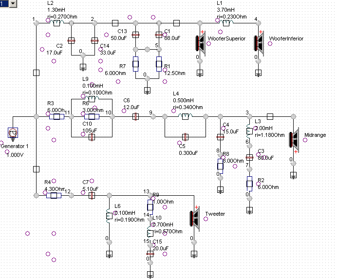

      Little did I know how big and heavy the end result would be!

        The crossover schematic is pretty simple. The woofer has a second order filter and an RC shunt to shape the response a bit in the upper end. The midrange is a bit more complex, but still it keeps the elegant simplicity of Zaph's original design; except for a huge (105 uF!) series filter, which helps tame a midrange peak which, I suspect, is diffraction from the enclosure (and since I was going for perfection, and had a couple of spare caps, I went for it). The values were tweaked a bit because I felt the speakers were a bit too forward (considering my hardwood floors), so I added a bit more BSC. Finally, the tweeter is a standard 2nd order with a parallel filter, which eliminates the Fs resonance impedance hump
        It's big, heavy, and it was expensive. Or so I think, since I managed to get it built with recycled components. Recession busting, indeed.

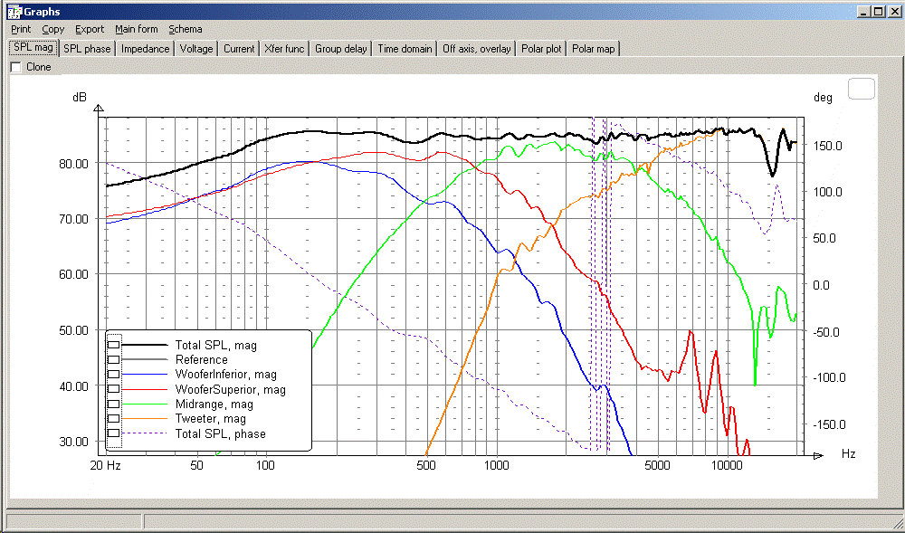

        So, how did it all work out? Pretty good, I believe.
        The FR: As flat as I could get it to be.

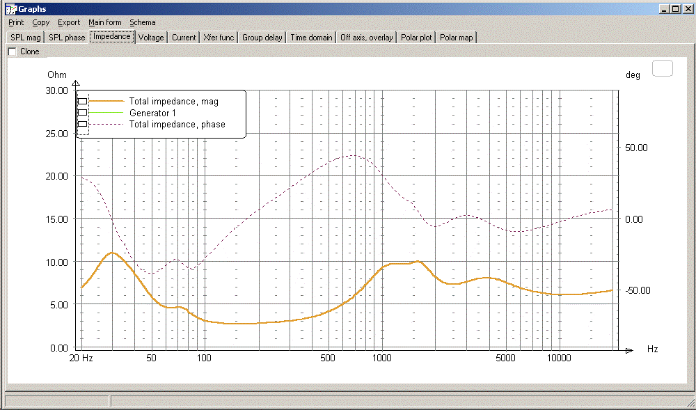

        Two RS-180s in parallel are never going to win any Best Friends award from an 8 Ohm rated amplifier, but other than that, the curves are benign enough.

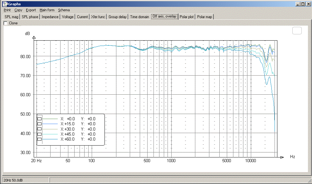

        Simulated off-axis is smooth, as a 3-way should be.

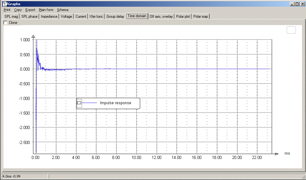

        And finally - the impulse response. According to Duelund's papers, I'd have expected a sharp rise followed by a slow and steady decline. I don't know whether this simulation is correct.

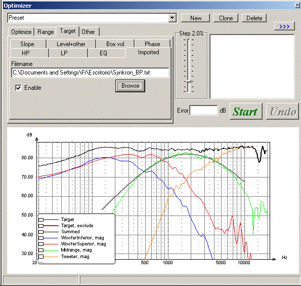

            But, is it really a Duelund?
            Only one way to find out for sure.

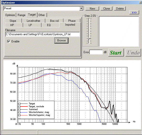

            I downloaded the transfer functions from the Duelund Synkron web calculator site, and loaded them into LSPCad.
            These are my results. I tried to get them as close as possible to the transfer functions, but due to the speakers' own response and the fact that the crossover was simply huge at that point made me make some compromises.
            Still, pretty close if you ask me.

            Note: I added the upper and lower woofer and eliminated tweeter and mid so you could get a better idea of how, when they sum up, they follow the Duelund topology.

                                                                              I'd like to replicate this modifed version of the ZDT3.5. I have two questions though:
                                                                              1. The ND20 and DQ25 are different sizes, which will result in different driver-driver, and driver-baffle spacing. Perhaps I have missed it, but what are the new driver locations on the baffle with the DQ25 tweeter?
                                                                              2. I plan to build both a pair of towers and a matching centre channel. JonMarsh seems to indicate that the modified crossover may be acceptacle for both configurations (post #10). Is this the case? If not, what type of changes might be necessary for a centre channel version?
                                                                              Any other input would be appreciated.

                                                                                  First of all, thanks for taking the time to reply, much appreciated! FYI, my initial plan was to build the Modula NeoD CC, but alas the tweeter for that is NLA...
                                                                                  I’m an EE (mixed signal / instrumentation gear mostly) and build amplifiers/electronics, but this is my first attempt at speaker building so please bear with me.
                                                                                  After reading Zaph’s ZDT page, and the three threads that fjhuerta has on this project, the baffle width being an issue is definitely something I picked up on. Since fjhuerta doesn’t appear to give (decipherable) dimensions, my idea is to use the baffle width (the entire cabinet design in fact) and round-overs specified in Zaph’s original design. The drivers would all be shifted downward the ½” or so to accommodate the DQ25 tweeter. In comparing the crossovers and design notes I *think* Zaph’s original woofer circuit/values could then be used. Is this correct?
                                                                                  The complication arises with the midrange section which fjhuerta seems to have modified partially in response to his baffle changes, and partially in response to tweeter changes. My plan there was to build the speakers with fjhuerta’s crossover, measure the responses, and then attempt to adjust the crossover using one of the freeware design/sim options.
                                                                                  Zaph’s changes between the ZDT3.5 and ZD3C amounts to reducing the midrange and tweeter pad resistor values, and reducing the woofer circuit to a single LR2 low-pass without a .5-way section and with a slight adjustment in Fc (from what I can tell). The plan for the centre channel crossover is basically to copy this approach with fjhuerta's ZDT3.5 crossover, and then try to measure and adjust as above.
                                                                                  The hope with the foregoing plan is to only require value changes in the crossover compoents to achieve same/similar results to those published by fjhuerta. Please feel free to point out my naiveté as appropriate.
                                                                                  Again, thanks for the input and for confirming the baffle step issue.
