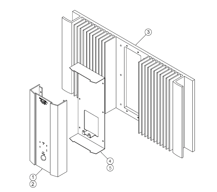

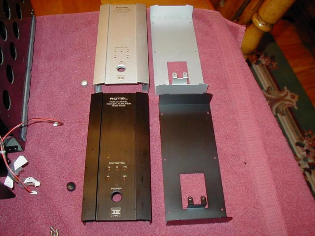

    I had a few scratches on the center faceplate of my black RMB-1095 (purchased before the silver ones came out) and figured I'd drop B&W/Rotel a call and see how much it would be for a new center faceplate. While I was at it I figured since my other two Rotel amps are silver series 10 I might as well get the silver center faceplate and button so all my amps match.
    I found the email address for tech support and a gentleman by the name of Shane Kea was good enough to reply with the part numbers and a pic of the parts(see attachment).
    For the RMB-1095 the parts numbers for the pic are:
    1 & 2 in the pic equal the center panel
    Part #CS00075 (PANEL, FRONT CENTER BLACK RMB1095 $18.10)
    Part #CS00076 (PANEL, FRONT CENTER SILVER RMB1095 $18.10)
    4 & 5 in the pic equal the sub assembly
    Part #CS00122 (PANEL, FRONT SUB BLACK RMB1095 $27.15)
    Part #CS00123 (PANEL, FRONT SUB SILVER RMB1095 $27.15)
    Not numbered in the pic (only because I didn't originally ask shane for the button) so I only have the silver button part number:
    Part #CS00007 (BUTTON, POWER 14F ROUND SILVER $1.81)
    As you can see it cost under $50 to turn my black amp into a silver one, so it matches all my other Rotel gear.

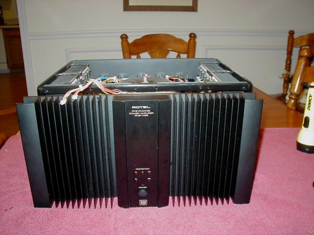

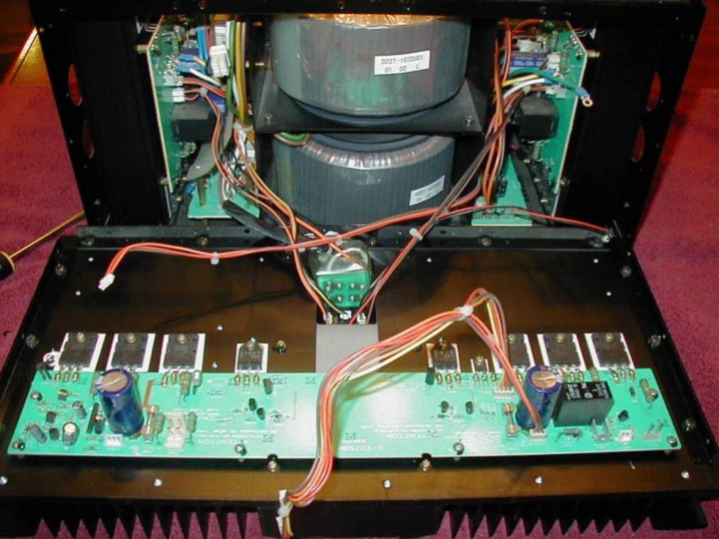

      I think when I looked into this in the past you have to remove the complete front assembly for the change. Its not as easy as it looks.
      Fish
      • Legairre
        • Jan 2002
        • 231
        Yes you have to remove the heat sinks which are screwed in from the back so you have to remove the cover. Also like any amp it's always best to leave it unplugged (in my case 24hrs just to be sure) to make sure any stored charge has dissipated to ensure you don't get shocked to death. 24hrs may be overkill, but better safe than sorry.
        The parts should arrive this week I'll let you know how difficult it is.
        "What do you mean it's too loud? My ears aren't even bleeding yet!"
        Radden Home Theater
        • Legairre
          • Jan 2002
          • 231

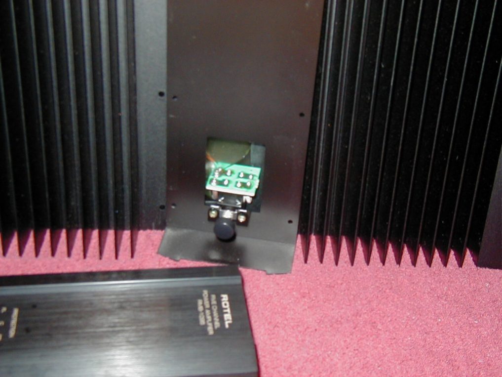

          Never mind my previous post the interior shot of the amp shows the screws to remove the center panel accessable without removing the heat sinks. They are to the left and right of the transformer so it appears you only have to remove the cover.
          Radden Home Theater
          • Legairre
            • Jan 2002
            • 231

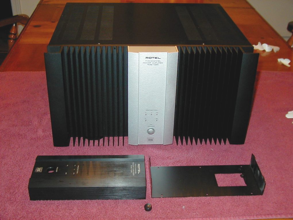

            The parts arrived today and I have to admit I was wrong the front heat sink panel does have to be removed, but it's not difficult. I took my time and it took about 2 hours. I have about 25 pics of the whole process and I can give step by step instructions. It's late so I'll just post a few before and after pics now and post the rest tomorrow with instructions.
            The whole process wasn't difficult it just takes time.

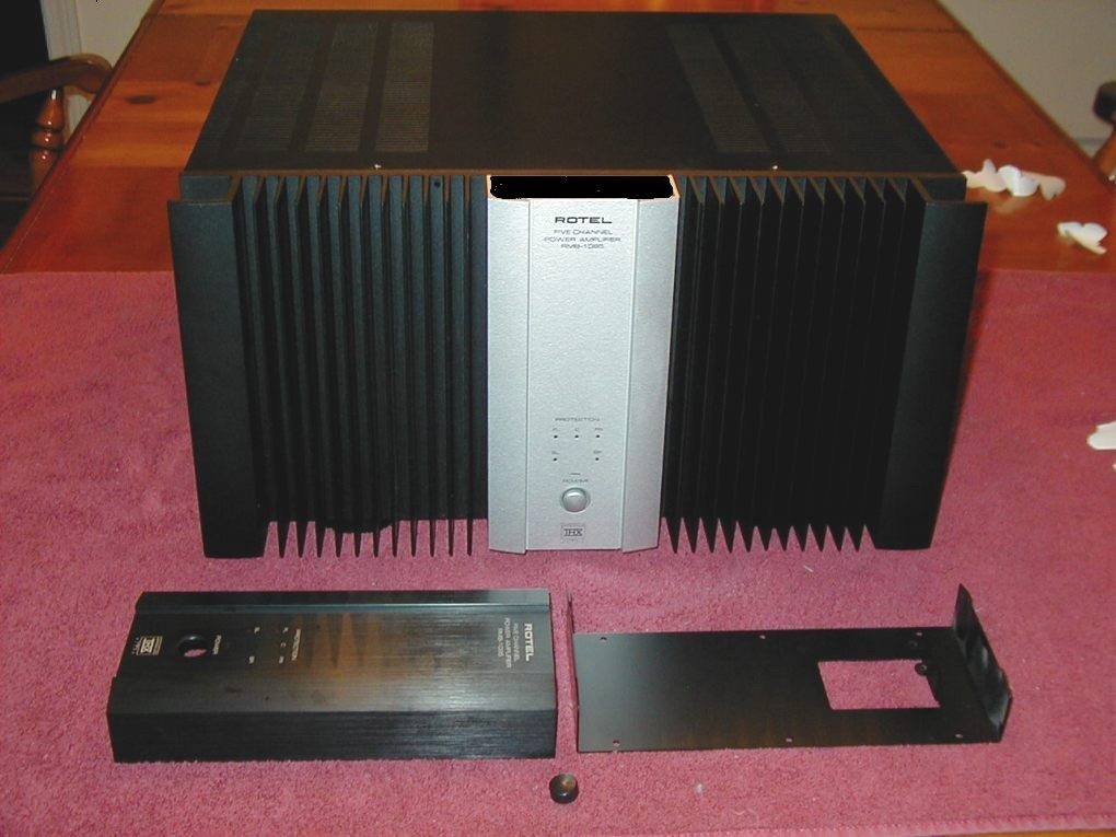

              Looks good, but one question: is the power LED red? I'm sure its blue on the silver ones. Maybe you should have changed that little PCB above the power switch too.

                  Hi Mike, the blue LED comes pre-installed with the silver panel and the red LED is pre-installed in the black panel. Also the red LEDs for each channel are also pre-installed. All you have to do is connect the wires(clips) to the correct contact.
                  When you're done your black 1095 will have the exact same look as a silver factory 1095.
                  Here's a pic you can see the blue LED glowing

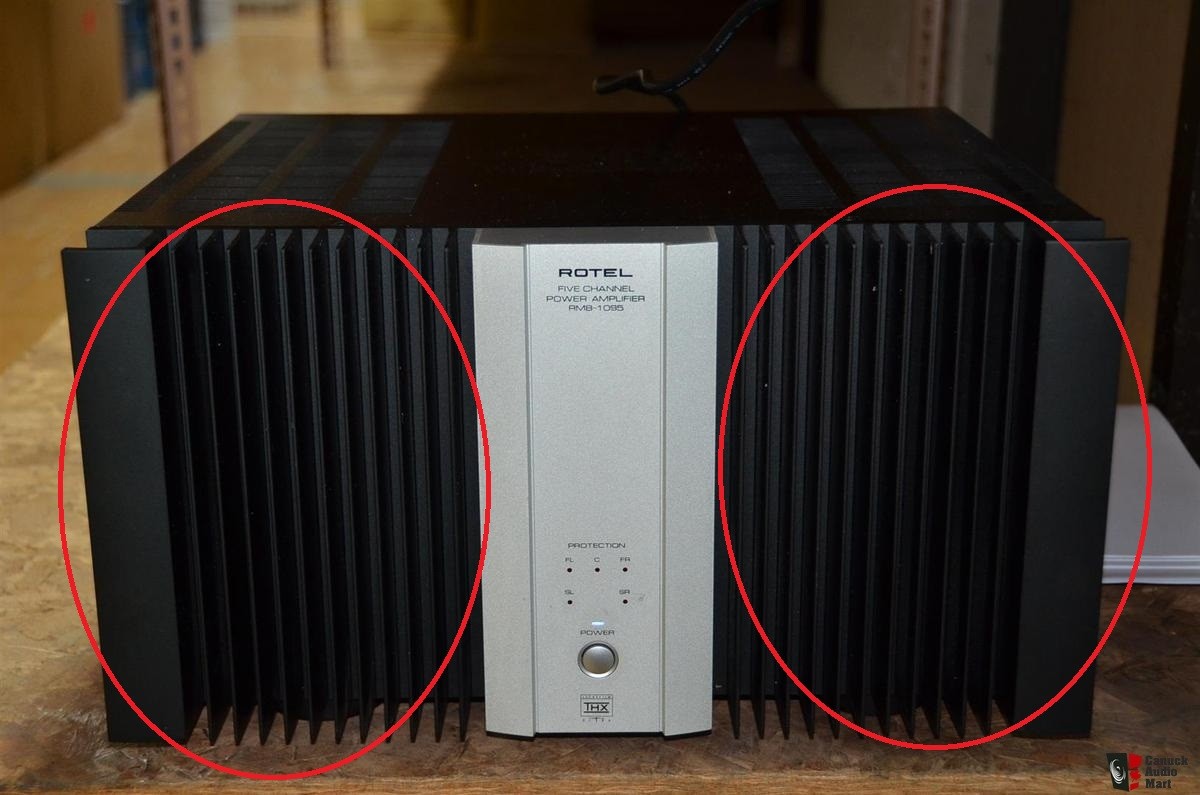

                                                  Is there anyone to paint front black grill to silver color spray?
                                                  • JDH
                                                    • 270
                                                    I wouldn't recommend painting the fins as it will not look original and most likely reduce its resale value. Wasn't the point of changing the centre section to silver to match other Rotel gear ? I probably would of gone the other way and turned your two other Rotel amps to black
                                                    JDH
                                                    Bits of HT & 2ch Stuff: Rotel, Pro-ject, Oppo, Bel Canto, Elektra Audio, Benchmark, Panasonic, DSPeaker, Epson, Slim Devices, Belkin, Philips Pronto, Harmony, URC, Sennheisser, AKG, HTPC under development, KEF, Whatmough, Definitive Technology & Pardigm Signiture speakers
                                                    • DFAL Minion
                                                      • Jan 2017
                                                      • 15
                                                      the fins on the front of the amp are for aesthetics (appearances) only.
                                                      they are not intended to function as heat dissipation (cooling) for the amp.
                                                      therefore, i see no problem with painting them.
                                                      i do, however, agree that the value of the amp will be reduced as a result.
                                                      whether that is an issue or not would be up to the owner.
                                                      if i were interested in a silver finish for the unit, (which i am not, since it is well known throughout the galaxy that BLACK gear sounds better), one could remove the front panel and have the black anodized finish bead-blasted.
                                                      afterwards, there would be multiple options on how to finish it.
                                                      it could be left 'as is'.
                                                      it could be sprayed with a clear coat finish, or any color of your choosing.
                                                      it could be clear anodized, or anodized to any range of available colors.
                                                      it could be polished to a chrome-like shine.
                                                      be it known that none of these options would imbue the equipment's performance with the obvious advantages provided by the Dark Force.
                                                      Supreme Director of Operations, EVIL TWIN
                                                      "A Royal Guardsman never seeks special privileges, ever. His entire goal in life is to serve our Dark Master, ET, and the New Order he created."
                                                      • BWLover
                                                        • Jan 2009
                                                        • 552
                                                        I was told that the front fins on the 1095 are in fact heatsinks, but the 1090 is just for looks.
                                                          Just email service@rotel.com
                                                          Shane, if you're out there I apologize in advance for any emails you might receive from this post.
                                                          Is it necessary to replace "4 & 5 in the pic equal the sub assembly" so I guess if I just replace to "1 & 2 in the pic equal the center panel" it seems like this [IMG][/IMG]
                                                          • lradden
                                                            • Sep 2012
                                                            • 30
                                                            Sure you could do the mod without replacing 4 or 5. 4 and/or 5 are just the black and silver(depending on which color you are switching) sub assembly that makes the center top and bottom the same color as the center front.
                                                            • Fishy
                                                              • 299
                                                              Sadly the resale value of these nowadays isn't that great.

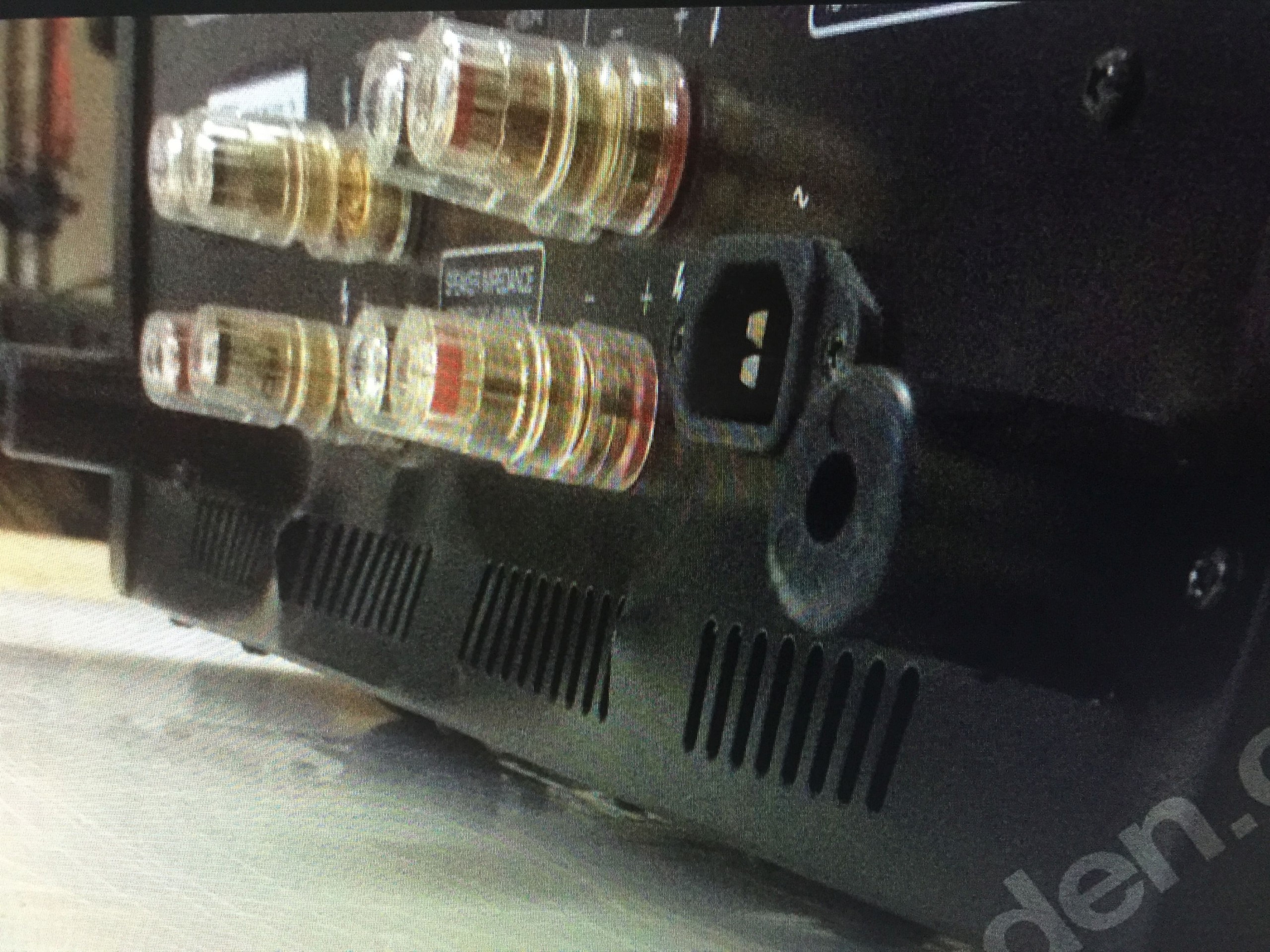

                                                                      Hi guys, Is it possible to fix this dent?
                                                                      [IMG][/IMG]
                                                                      [IMG][/IMG]
                                                                        i can not see the pics...
                                                                        • sakgoz79
                                                                          • Jan 2015
                                                                          • 30
                                                                          [IMG][/IMG]
                                                                          [IMG][/IMG]
                                                                            • 4157
                                                                            I see the pics, and DAMN! I would suppose anything can be fixed, but I'd consider having a professional look inside that before powering it up. There could be cracked solder joints, PCBs, etc., in there that could cause serious problems down the road. If you aren't very comfortable doing that sort of assessment/repair it should go to a qualified technician.

                                                                              Thanks for quick reply but it is working normally it has just dent
                                                                              • Kevin D
                                                                                • 4601
                                                                                We had Rotel repair a shipping damaged 1090 before. If they still have the parts, time and a screw driver is all you need.
                                                                                You'll need to contact them directly for part numbers.

                                                                                          I sent the instructions with pics on how replace the faceplate to your email address.
