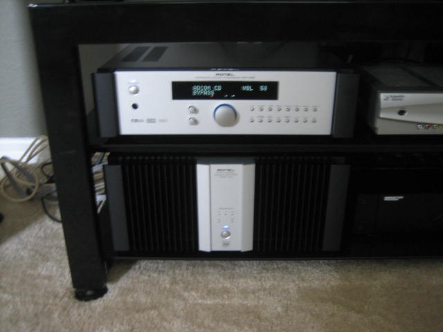

    I finally bought my first 2 Rotels. The RMB 1075 and the RSP 1068. In the future I want to get the 1092. I love the way these things sound. I think that they sound a little bit better than my Musical Fidelity A3.2 integrated amplifier. Anyway, do you guys have any suggestions as to what I could do to improve the sound even more?? Where would you add acoustic treatments ect... This is the family room. It opens into the kitchen so it's about 3000 cubic feet. What kind of subwoofer could fill this space. Thanks for any suggestions!!
    My RMB 1075 and RSP 1068

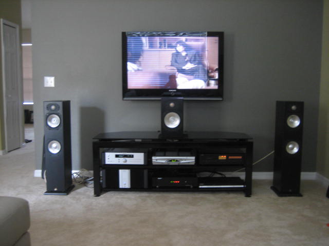

    front and center channel

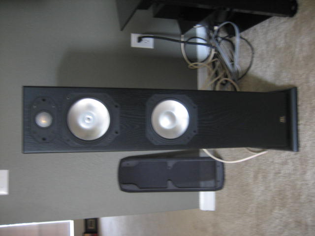

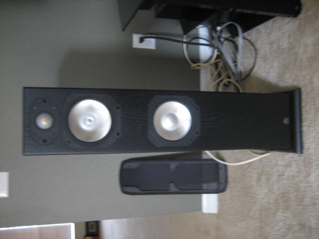

    front speakers Monitor Audio S6

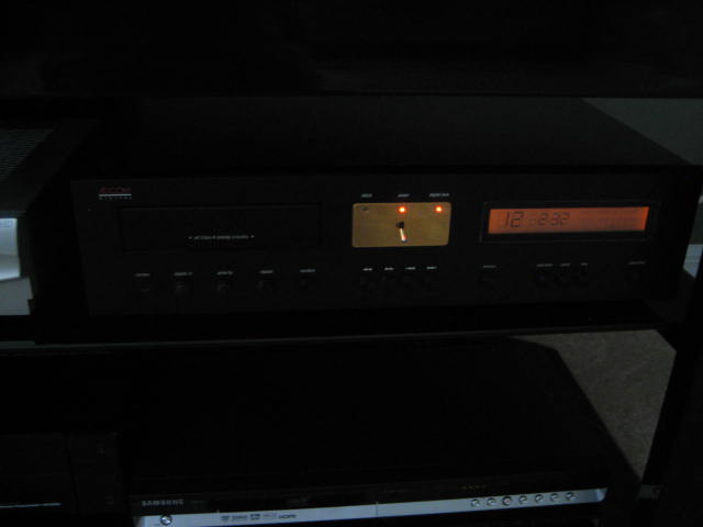

    adcom gcd 750

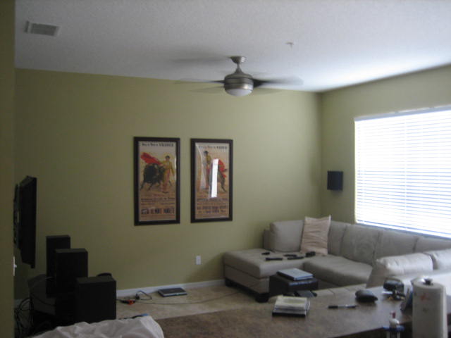

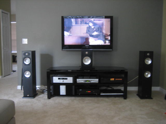

    my room.
    My wife wants to move the tv where the two paintings are!!!??? What do you guys think.

              First thing to do IMHO:
              1) Spikes on speakers, speakers on carpet is far from perfect. Try really heavy and stable granite plate below, because spikes on carpet isn't good too. Soundcare superspikes are really good.
              2) Speakers position, that's really important, I've obtained best result by aligning them with listening position, I just see a small part of the internal side.
              3) Feet for electronics, Ceraball are impressive, especially under amp and source.
              4) Better power source, better power cords, also try to avoid ground loop.
              5) Room improvement. Window on the back is far from perfect, that reflect too much sound, but you cannot really do a lot of thing, 1-2 absorber on left/right could perhaps help. Absorbant also on the right wall, just at the level of the speaker, 1m should be enough as a start. To test buy a very big piece of glass wool, that give and appro idea if that kind of thing could help.
              Try more heavy curtains too (also good to darken the room quickly)
              Moving the tv as your wife suggest could also improve, because you won't have a big hole on the left and a wall on the right, you will have two wall, give it a try.
              6) Speakers cables and modulation, try to borrow some different brands, that could dramatically affect the sound.
              7) a very good furniture for the electronics, try also granite or heavy wood plate below the CD, with some damping material like straben pads between the plate and furniture, that change the sound quite a bit.

                        From the pictures you’ve posted I would say you have four major problems:
                        Some you can resolve for free...
                        1) I agree with your wife, rotate everything by 90 degrees. Right now you have two walls next to your right speaker and only one wall near the left this will cause a slight dis-balance in the sound... a trained pair of ears could probably tell the difference (at least until their brain adjusted to the new sound)
                        2) Rotating will also partially solve part of number two, your excessive window reflections on your TV screen. To totally solve this one and at least try to reduce the bright sound induced by the glass you will need to buy a dark set of thick curtains that over laps the entire frame by a few inches. Without blocking the sun out you basically just destroy the high-contrast capabilities of the TV.
                        3) Running fans and motors in an audio/video room is a no-no; it increases the noise floor and therefore kills the dynamic range. It also induces unnecessary electrical noise in your AC circuits. If you must run fans then at least buy the Rotel line-conditioner.
                        4) Cables management… running loops of power cables and A/V cables close together is another no-no. Power cables and transformers cause massive electro-magnetic fields extending 12inches beyond the wire itself, the more power you draw and the more loops you have the worse it gets. It’s like having a 500watt 60hz electromagnet next to your credit cards. If you can… shorten the speaker wires and run the power cables perpendicular to ALL other cables. Also move the amps and other transformers as far away from everything else, as much as possible.
                        As stated already, speaker position can make or break a sound system.
                        Isolating the speakers from solid objects is always a good idea, the reason being is that sound transmits through all objects (tin can/wire principal) the problem is that the denser the material is, the faster the sound propagates through it; this can time smear the air pressures because air isn’t very dense. Materials with high mass will block high frequencies and materials with high strength will block low frequencies. :T
