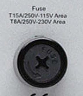

    Eric, it sounds like it's the fuse. All you need is a standard phillips screwdriver. There is a fuse holder on the back panel of the A52.
    When you replace the fuse, make sure to get a SLOW-BLOW type. If you replace it with a regular fast-blow, it may blow out immediately.
    At 230V, the Halo A52 needs an 8 amp slow-blow (8AT) american style 1/4 x 1 1/4" fuse (6.3x32mm - NOT the euro 5x20mm).

            The main fuse is located on the back panel. It's just above the AC plug. Its a black cap. http://www.parasound.com/img/halo/a52_rear_big.jpg

                  Correct! You should find this fuse holder on your back panel:
                  A Phillips screwdriver is needed to unscrew the cap of the fuse holder and remove the fuse. In unscrews counterclockwise. Follow the direction of the arrow in the picture.
                  If you don't get the blue "Halo" light, it means that your low power standby circuitry is not working. (All Halo amps have a second transformer plus accociated circuitry for standby mode). AFAIK, the standby transformer does not have a user replacable fuse. Either the main fuse is blown, or the standby transformer or its circuitry is defective.
                  FWIW, the standby transformer is the yellow-white-silver component to the left of the FUSE_11 arrow in your picture. Any failed internal fuse would probably be on this circuit board. It seems like all the fuses you point to in the picture are on the main board. I'm pretty sure they will not affect standby operation in any way. Even if blown, you shold still have your blue Halo light and command of operation. Since your standby circuitry is dead, the fault is most likely limited to the main fuse, the standby board (where the little yellow transformer is located), or any connectors leading to this board following the connection from your 230V wall socket.

                      OK, it´s up and running again, just had to replace the 8A US style fuse as Peter said.
                      Thanks a lot Peter for your help and r100gs for opening the eyes of a blind
                      I still can´t beliefe I opened up my amp to search for the fuse that is more than visible on the back panel. Anyway, it is all fine again.
