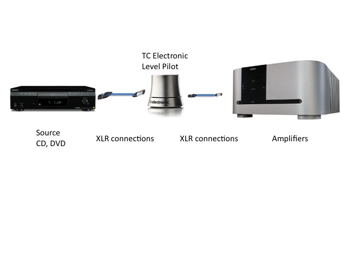

                  look at the bottom portion of this schematic:
                  when listening to 2channel music I have the signal going thru the Pass Labs Pre X2.5...but notice also that I have the signal also going to the Pre/Pro, which handles all the bass via a very robuts bass management (pre/pro BM + DEQ2496 for EQ and Low end boost). Speakers are set as full range, so the mains get the entire kaboodle from the Pre side.
                  Thus, from the pre/pro, they are crossed at 40hz in music mode, and the signal above is discarded in the Pass Labs, at it is only analyzing the correct input for itself. Therefore, the mains get all the goodness of the high resolution transport + DAC + Pre X2.5, going directly to the Pass Labs Monoblocks, and the subs get their signal from teh Pre/pro
                  Nirvana my friend!
                  you have to hear it to really understand how great it sounds.

                    Originally posted by ssabripo
                    mine is a little bit more complicated, but well worth the headach look at the bottom portion of this schematic:
                    Nirvana my friend! you have to hear it to really understand how great it sounds.
                    Love what you did how where you able to do these drawing like that?
                      microsoft visio
