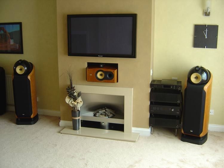

    She came up with a "solution" to build-in the center speaker in the wall, with a flat tv hanging above it. Unbelievably I've found a picture on the internet of just that, so it's easier to show what I (she) means. The only difference is that I have a HTM-1 and I will place my 802s further from the wall, and scrap the fire place
    Now...IF I would go through with it, would such a mouting position hinder the sound in any way? I would think it does, but I've no idea.

    This is a tough situation to deal with. Everyday I have to help my customers deal with similar situations. If you put the center channel in the wall like the picture it will sound heavier and thicker in the lower midrange and upper bass. There will be an added emphasis on male voices and things like an electric bass. It will also affect the imaging. The wall will act as an extended baffle for the speaker and the image will smear. With all of that said, it will not be unlistenable. You, both you and your wife, will have to decide what will work for you.

        In my opinion, you'd be better off just running a phantom center and selling the HTM1. Plus since you are building a dedicated room, what's her deal? It's not like you're putting all this gear in the family/formal living room.

          The foto you showed presents several problems. First, if that fireplace works, I owuldn't count on reselling the center speaker for anything or it not being affected by the heat rising both from interior and exterior.
          Then most important the sound will be very closed in and heavy on the base. Since the Center pseaker is THE MOST IMPORTANT speaker in a Home Theater, this is a lose lose situation.
          Is that a htm1 you are speaking of or an htm1D which would be a "crime".
          How about a nice cabinet with the speakers just below the Screen. Why go wall. This way the depth of the speaker fronts on all your speakers will coincide with the screen.
