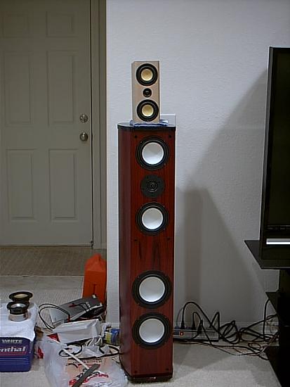

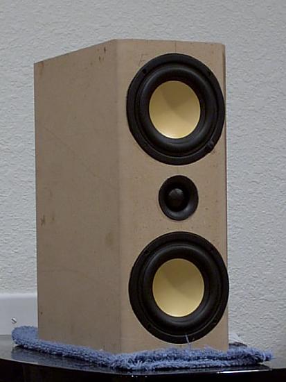

    Hi everyone! I've started my first project finally. It's a 5.1 sub/sat system using HiVi M series drivers and the Dayton ND20. L&R are MTM (M3N), center is WMTW (M3N and M4N), and an M8N for the sub. I've built the test enclosure for the mains so far. The finish will be a maple veneer with piano black caps on the top and bottom like the speaker in the picture. Here are some pics.

    Looks great! Good choices on the drivers; with a sufficient highpass and good room placement for the sub, it could be miles better than Bose (and similar names) with a very similar form factor. I look forward to seeing more.
    Edit- I had a thought- did you have any trouble with the tweeter centered on the baffle like that? I was playing around with The Edge a little while ago, and placing it off-center really seemed to help smooth the response.

      Thanks for the comments JoeC. Ya know I was in such hurry to get a test enclosure done so i could start on the XO that I spaced simulating diffraction before I drilled the hole. Now I'll justt use it to verify the woofer performance. Good catch

        Those are really cute. It's funny to see them on the bigger speaker. Only then does one understand how tiny they really are. Good job.... :T
          Yeah, what Thomas said. Those are tiny! Keep us updated.
            • 16069
            Very cute- amazing how small they are, the proportions look like a bigger speaker.
            Curious to see how this turns out.
              I didn't play with such narrow baffles... might as well sim this one to see if you don't have to throw it out, you know?

                        garto- 4.25"w x 9"h x 8"d I started with 3 liters for testing and raised that to 3.9l for the finished box to make room for the XO. Which I hope fits in there, it's a tiny inside the box.
