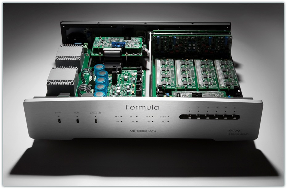

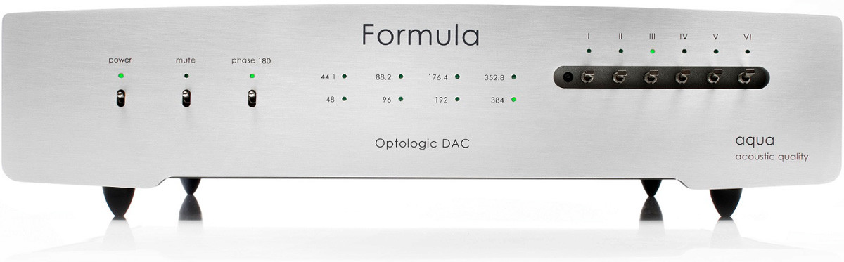

    Perhaps the name translates or reads better in the native Italian. AquaHiFi is from Milan... why can't we have more interesting new audio players in the US of A, instead of social media start ups? I know, probably greed and access to money from investors.
    But regardless, my colleague and friend in Munich, who hasn't yet moved back to Singapore, is evaluating a new DAC and is quite impressed, especially at it is AC powered, not battery supplied, and has no re-clocking or rubidium standard in the signal path, while his reference setup has all of that.
    Discover our flagship Formula xHD D/A converter. Featuring proprietary Optologic discrete R2R ladder DAC technology and full modular design for zero obsolescence.

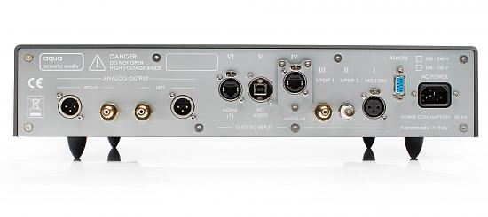

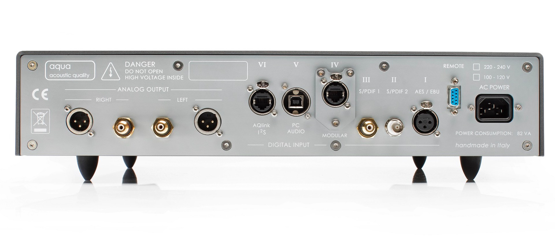

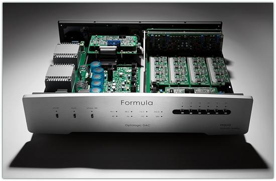

    Modular, and readily upgradeable, it uses a proprietary R2R NOS setup, like the TotalDAC-Dx series. It is actually available in Canada and the US, through a distributor and dealers.
    It has a lot of intriguing design features, but rather than paraphrasing that info, I'll just send you to this capable and interesting review at 6moons.
    There are lots and lots of beautiful pictures of PCB, certainly enough to tantalize the DIY junkies among us (you know who you are) and also to satisfy those looking for an impeccably built product.
    Last edited by theSven; 10 June 2023, 20:21 Saturday. Reason: Update image location
    the power section looks quite interesting.

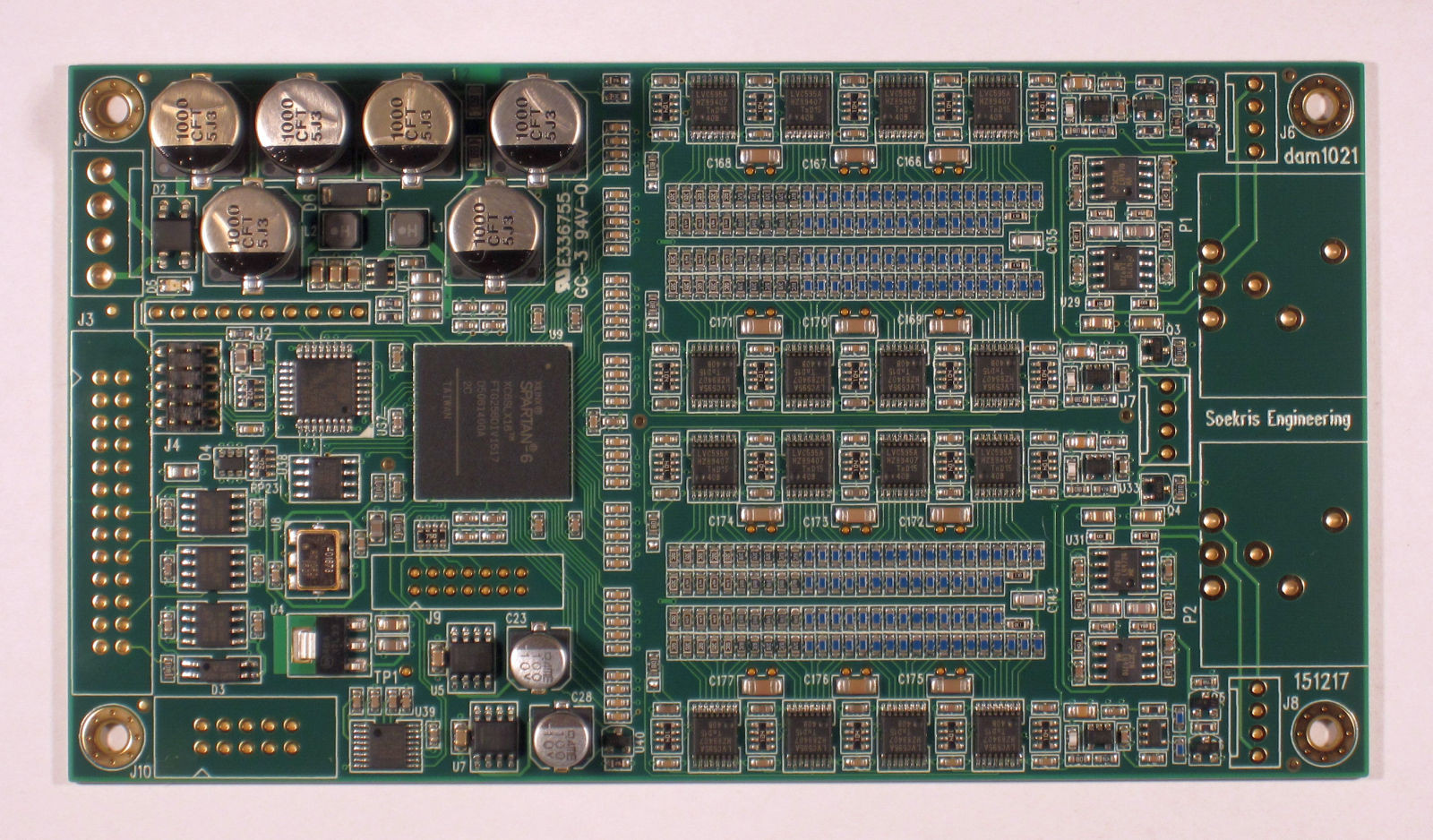

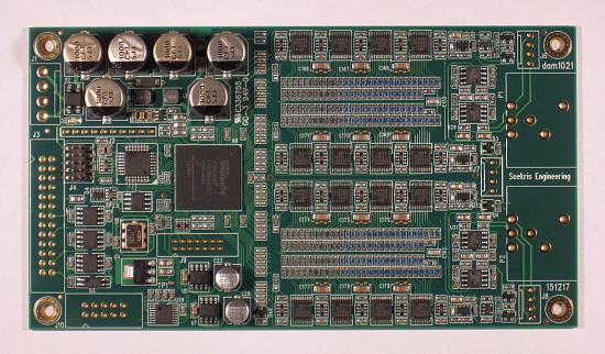

      OT, but i was wondering if you had any knowledge regarding these?
      Soekris Engineering, Inc.

        Yes, I do. ;-)
          then shall i read into the 'wink' emoticon that if one were to purse a DIY DAC then this might be a good candidate?
            • 16196
            Yes, but I was more interested in them for this...
            you might write them and see if they've will be back in stock, or if that relationship is terminated. (would save me the effort- was considering that an an "inexpensive" traveling DAC... ) (no time for case building here)
            I do recommend going with the more expensive version with the higher precision resistors.
            Note how nicely things look at lower input signal levels-
            You WILL need a good preamp/buffer stage- 625 ohms is NOT really a low output Impedance. Maybe short cables going in to a Freya? :W
            For me, this has limited appeal because of the interfaces (or lack of) available - I'm more a AES/EBU kind of guy... USB a distant second. If I had a Signature Rendu, like the one I transshipped to my friend in Munich, with I2S, it would be different- but I don't.

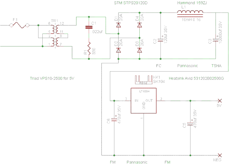

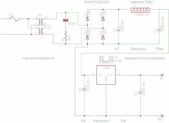

              would something like this be appropriate for a PS?
              also, would my rubidium clock have an application here, too?

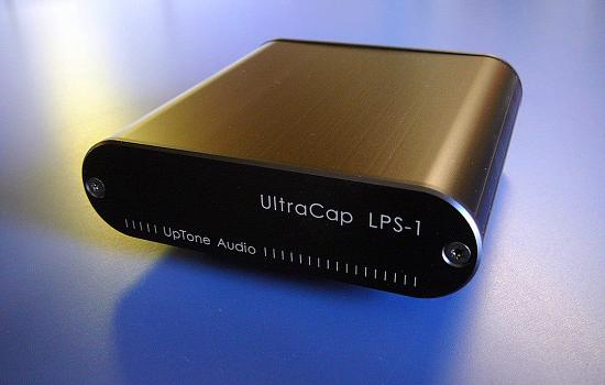

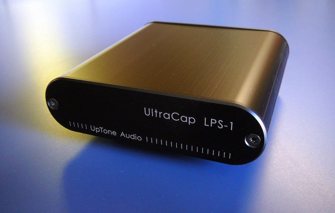

                That could likely work. But...
                If this is within your budgetary limits for the power supply, I'd recommend giving it a consideration, especially as this is Analog we're talking about...
                Switchable from 3.3 to 5 to 7V. I use 7V for the microRendu.

                  Yep.....that is the Cadillac.......
                  maybe after i get a project compete i will upgrade to that level.......first i gotta get something built & working!

                    The regulator looks pretty good- that is a good part from LT, and the choke rectifier helps. The biggest issue with a lot of relatively conventional supplies like this is the common mode noise they can bleed into the system, just across the transformer windings from the AC line. This is what the Ultra Cap avoids.
                    Go for it... and thanks for following up with SoeKris. They are pretty close by- relative to a lot of things, but it would be a 2-3 hour drive. Quicker to get to Ron's...
