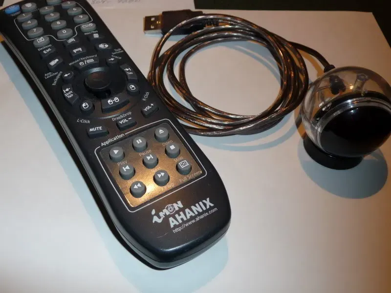

                                          There are a handful of really good remote controls that use a simple IR interface that integrate well with an HTPC. One of the most frequently used is made by iMon:
                                          iMon IR Remote Review
                                          When combined with a bluetooth keyboard and mouse you can have full wireless control of any HTPC and the backend fileserver while you continue to sit on the couch with a beer :W

                                            Like this one?

                                                Yeah i think it looks kinda similar :

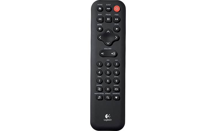

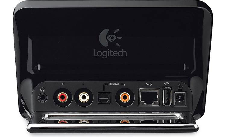

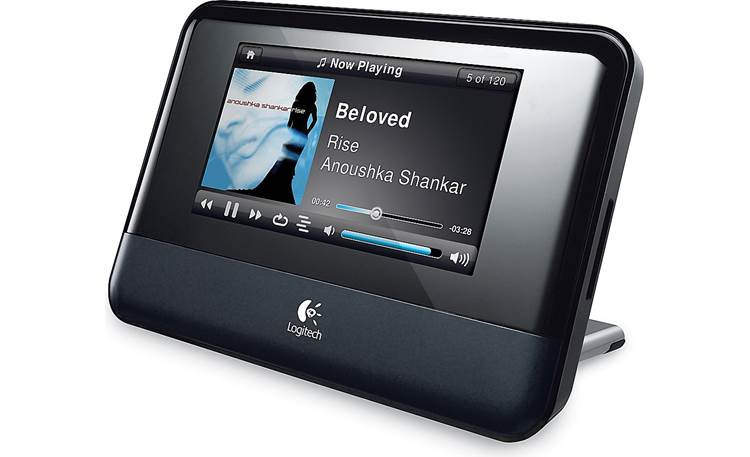

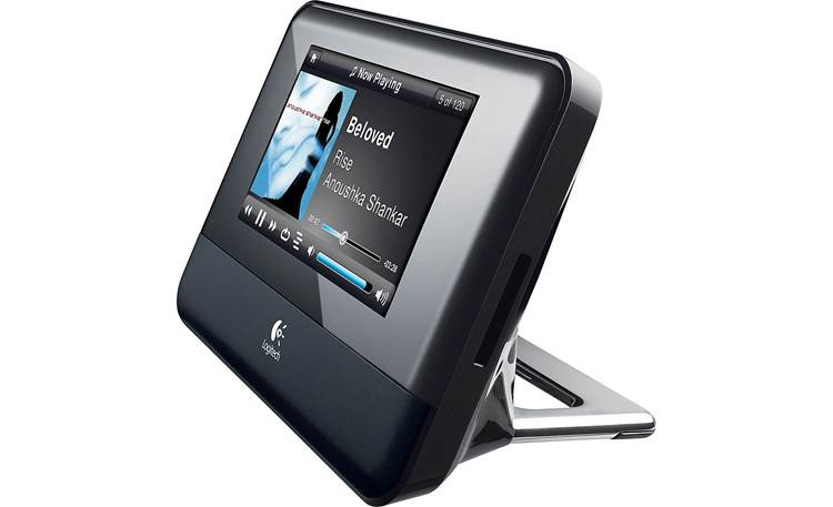

                                                                The upcoming Squeeze Touch looks pretty sweet. I haven't read much about it yet, but pretty pictures.

                                                                Such simplicity.

                                                                                Have been using the Squeezebox Duet since it first came out. Use dbpoweramp to rip music to flac. Presently have about 450 albums in my
                                                                                collection.
                                                                                This is a relatively inexpensive way to get started with digital music. You will spend a fair amount of time ripping your CD's and getting your music organized. Once you have though, you will find yourself listening to stuff you may not have played in years.
