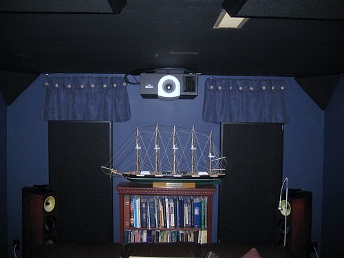

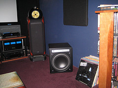

    First of all, you will love a dedicated room. I built one in my basement a coulpe of years ago. It was similar in size, 11 X 16 X 8. The back of my couch is about 3 feet from the back wall.
    As to your question a very good one. I will suggest two ideas based on how my speakers are set up. They sound quite excellent.
    * My sitting position is a triangle with my main speakers. 9 feet on all sides.
    They are about two feet from the front wall and a foot off the side wall.
    * All 5 speakers are pointed to a spot about 6-12 inches behind my head. This means the mains are towed in quite a bit. My rear speakers are towed in severely, in order to hit that spot. They are approximately 1 foot off each wall.
    * As for the side speakers, they should be at least at your side on the walls, and maybe a little bit forward of your sitting position.
    I've since done acoustic treatments to the room, with very nice results
    I've attached pictures for reference.
    Hope this helps.

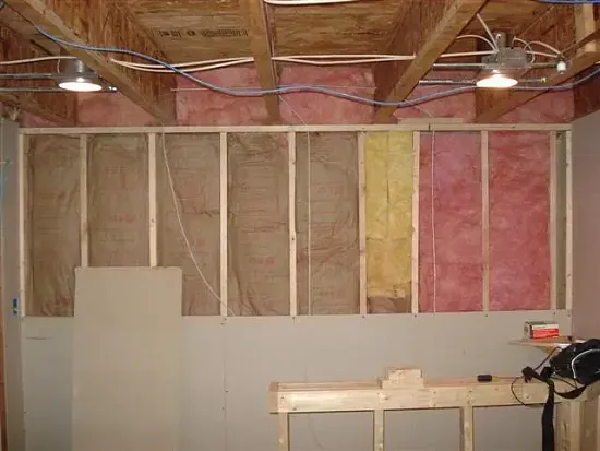

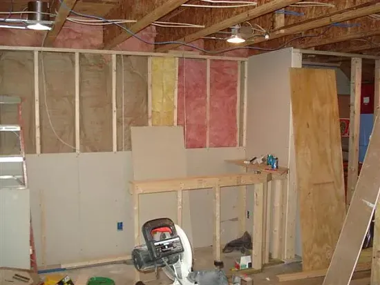

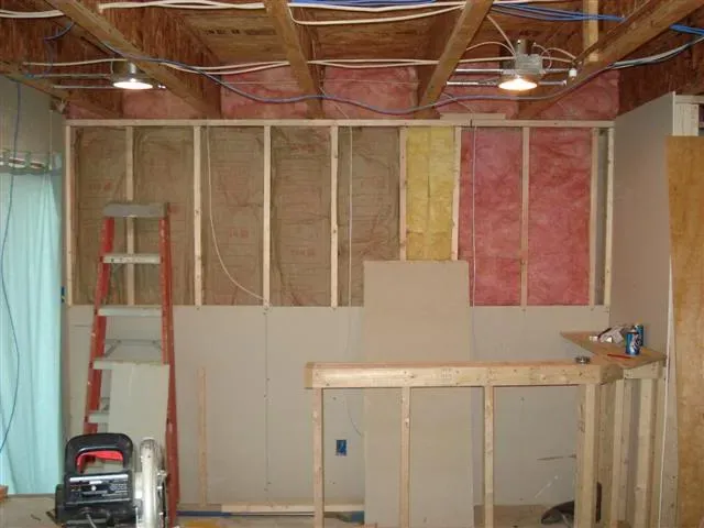

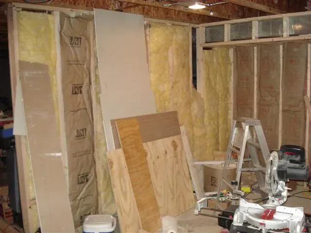

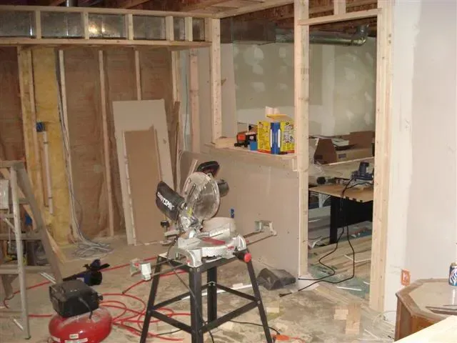

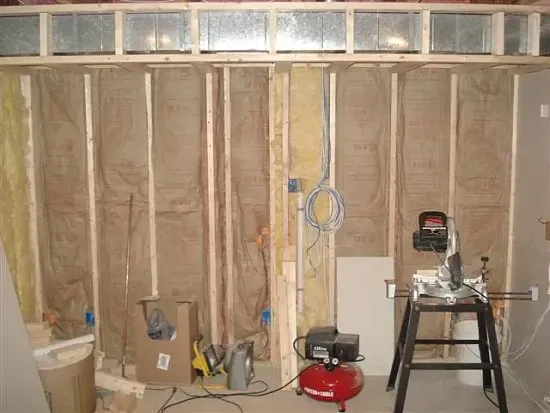

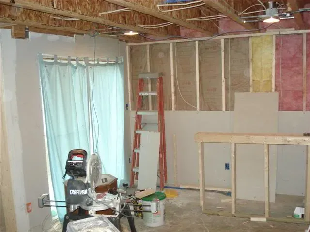

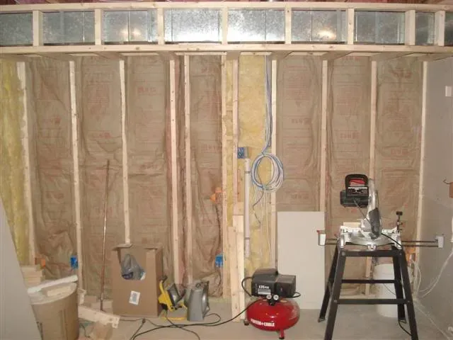

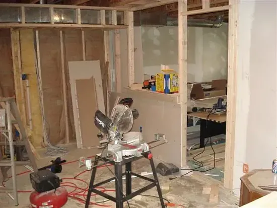

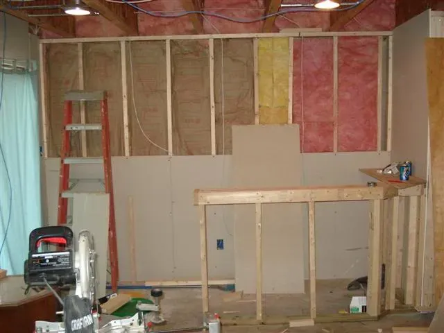

                          Here are the pictures finally:
                          The back wall where the rear surrounds are going…you can see the speaker wire hanging down. I pulled wires for 6.1 and 7.1, just incase I don’t have my two rear surrounds by the time this is finished

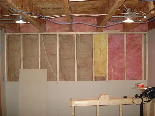

                          The front right of the wall where T.V. is going
                          Front wall center

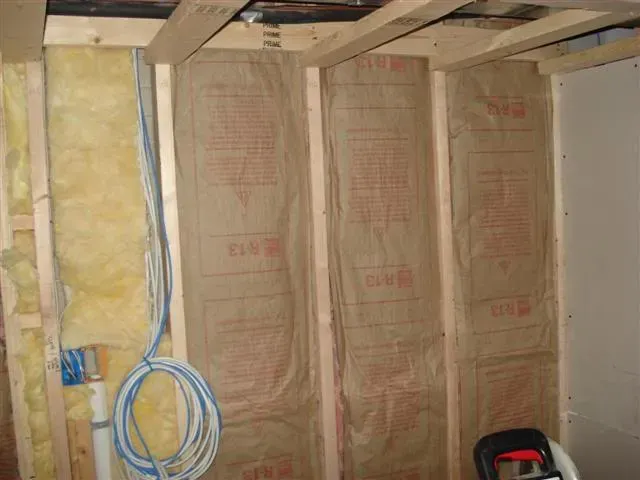

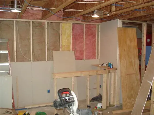

                          Rear right wall

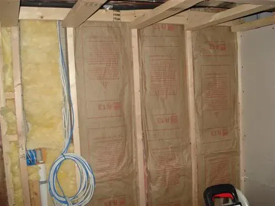

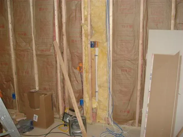

                          Another picture of back wall

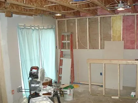

                          Left side of front wall….the reason there is insulation is cuz the furnace is on the other side, and “trying” keep the sound down a lil
                          Right side of front wall…..there was a wall there, but decided it would be to “closed” if I didn’t open it up….to turned into a lil countertop. When I have poker games in the other room, everyone and talk without walking up to the “door”. I have it roughed in for a door, so when the time comes to sell I can throw up some studs, doors, and make it an extra bedroom
                          Another straight on of rear wall
                          Rear again
                          Front wall again
                          Last edited by theSven; 24 June 2023, 16:37 Saturday. Reason: Update image location
                          • htsteve
                            • 1216
                            Jeff,

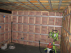

                            A dedicated space will be quite excellent. I built mine two years ago, a dedicated HT room in my basement.
                            Some quick thoughts:
                            * Did you wire up for a projector? If yes, do you have backup wiring for it? My main cable is an HDMI, but I also put in componenet cables as backup (in case either end didn't work at some point).
                            * I assume you will get a heavier curtain for that doorwall.
                            * What colors are you painting? My room is quite dark (it's not a family room setup, so I could set it up for optimsl video performance). Dark grey screen wall, dark navy blue walls and black ceiling.
                            * Good idea on insulation. It does help. If there are rooms above, don't forget to insulate the ceiling.

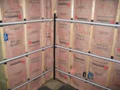

                            * Another idea is to put in resilient channel before the drywall goes on. This decouples the drywall from the studs. It's a great way to control the very low bass that you feel. That low bass is like water, it will leak out everywhere. I've attached pictures (although they're small).
                            * Front right wall where the half wall opening is. You might consider putting some kind of 'closet' door(s) on it. You can keep them closed if you want (preserving the sound integrity of the room) but have the option to open them up and use the space.
                            * What are the overall dimensions?
Name:	Channel and gasket on wall.jpg
Name:	Resilient Channel.jpg
