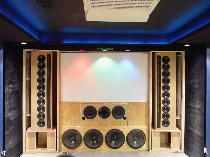

        I can't imagine the 2 front height speakers having that much of a signal so I don't think a high dollar speaker would be in order for most people. I have the DPLIIz and chose not to use the two high fronts because;
        A) The line arrays I built are floor to ceiling.
        B) My screen wall has no extra room on it.
        C)The Yamaha reciever does not have pre outs for them.

          I just had a thought, what if I rewire the top two mids and tweets on the arrays for the high speakers? May be more trouble than its worth, I will think about though.
            Click image for larger version  Name:	DSC05439.jpg Views:	4 Size:	107.4 KB ID:	958411
            Very nice I love the DY Speakers that must move some air! I wish I was electronically inclined
            May be when I have time in my old age I might go back to school and learn speaker design
              Nice design! I hope if you're using that for home theater with front projection, that you're painting the wood black, or at least using dark acoutically-transparent fabric. (even then the light wood would show through, though)
              I wouldn't bother re-wiring the top drivers. Think about what the "front height" speakers do--they pull the sound stage up in the vertical, to give you a front sound wall. By building such a tall array, your sound field already takes up your entire front wall!
