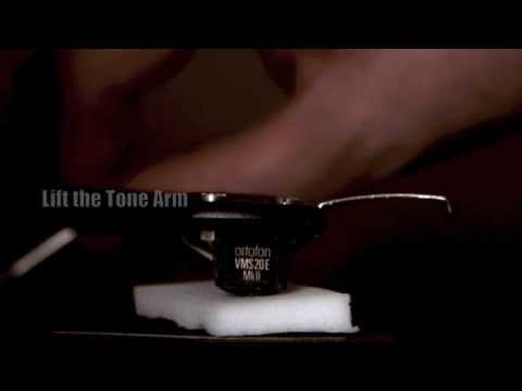

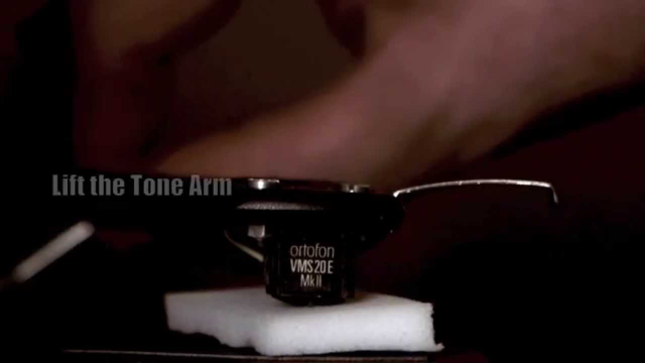

          • 4143
          A Mr. Clean Magic Eraser is an easy way to clean the stylus , just gently rest the stylus on it a few times then brush it to make sure it's clear.

            Nice setup Doug. "Some assembly required?" 8O
            The pops could be due to static electricity build-up. I think some record cleaners have anti-static stuff in them, also get some anti-static record sleeves. That should cut down on the popping some.

              • 5673
              Originally posted by Alaric
              A Mr. Clean Magic Eraser is an easy way to clean the stylus........
              Lee, you beat me to it.....again!

                      Magic Erasers are available at most grocery stores, Walmart, etc, in the cleaning supplies aisle. They're used to clean stuff around the house, including turntable styluses, apparently. I think Heather has some stashed under the sink. I may have to "borrow" one when I get a TT sometime.
                      In a pinch, you could use a soft sponge or microfiber cloth in place of the Magic Eraser. As long as you just lower and raise the stylus on whatever it is, without dragging it across the surface, it shouldn't hurt it, and it should take the dust/dirt off.
