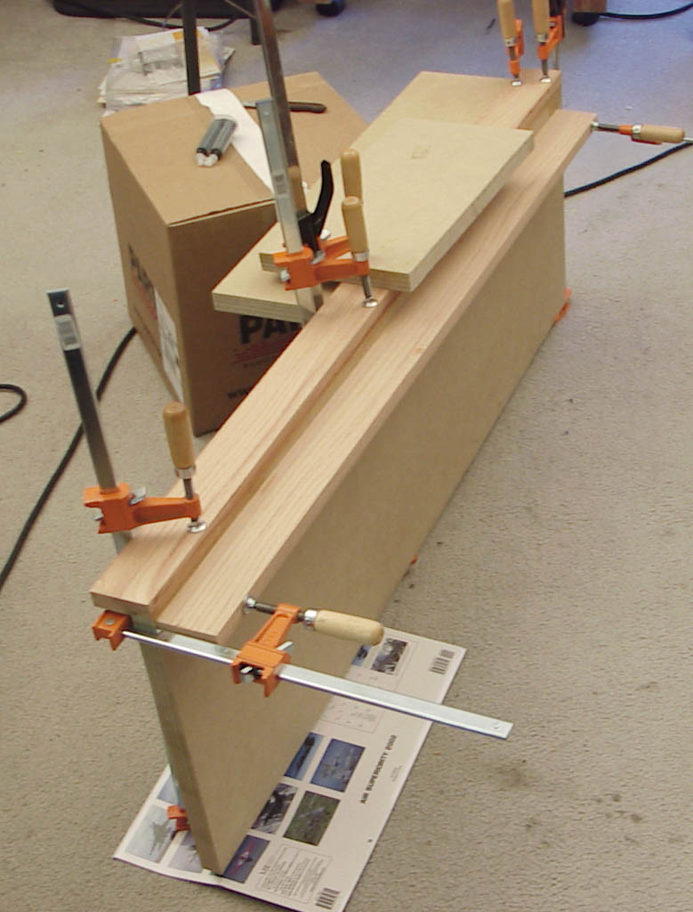

            At this stage, it's a bit ugly... Lex won't have to worrry about any competition for the beauty queen title his beloved Sonus Faber's hold.... yet... :P
            First clamping step....
            Second side, after routing front panel....
            Earth First!
            Last edited by theSven; 09 December 2024, 13:00 Monday. Reason: Update image location
