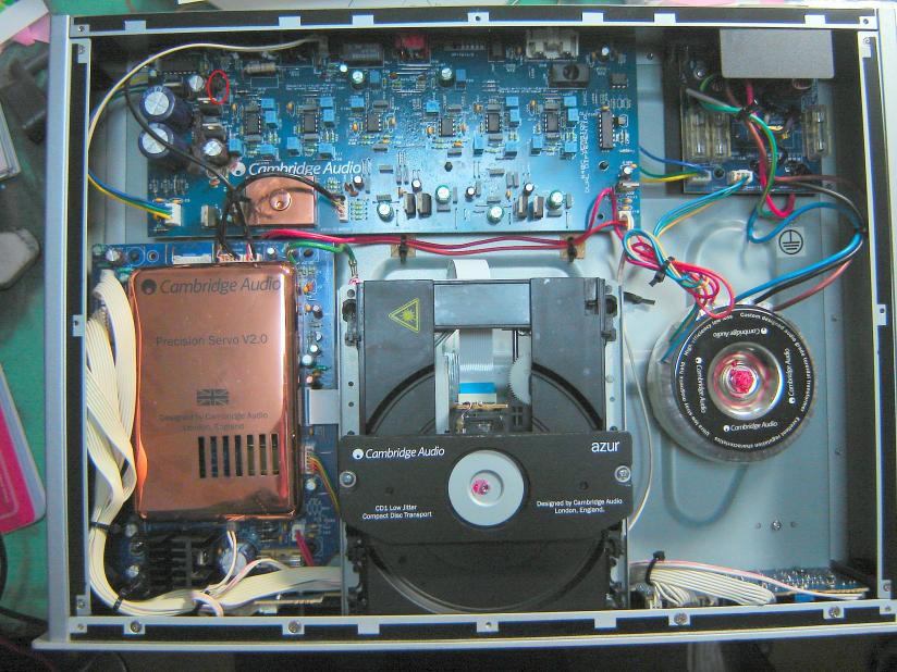

                                                                  Simply take the top off. Look at the left hand side main board and find R11. It's near the big capacitors. Put an ohmmeter on it. If you get anything higher than 2.2k then it needs replacing. Unplug all the leads to the board taking a note of where they go. The longnose pliers are useful for this. Some may be a bit stubborn. Take your time and work them firmly but gently and they will come clear. The board is secured with about 4 small phillips head bolts from memory. Undo these and the board will come free. Flip it over and locate R11 again. Desolder it and remove. Fit the new resistor with an airgap, solder and trim. Re-assemble and test.
                                                                    • 16113
                                                                    Thanks for sharing this and posting in such detail. If you had any pics from when you did this work, I'm sure some folks would really appreciate it.

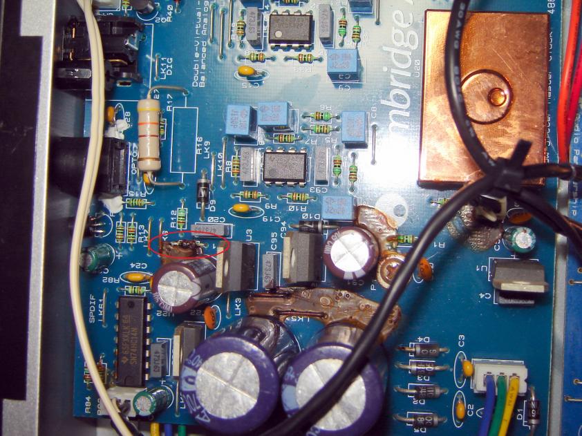

                                                                      Here's a couple of pictures I took at the time. In my case the resistor is smothered in glue from a glue gun used to secure the large smoothing capacitors at the factory. Not a pretty sight at all.
                                                                      I think there was one or two bolts and a number of black plastic clips securing the board. Just squeeze on the clips to release them. Do that first and see if the board comes free. If not, then go ahead and remove the bolts. The dual Wolfson DACs are on the other side of the board if I remember correctly and can be admired when you do this little repair.
