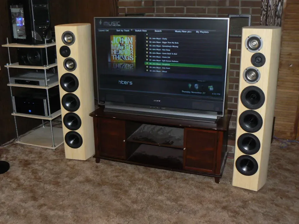

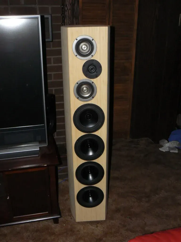

            Post some pics of your enclosure from a couple different angles so we can see if using some high priced veneer will work in the first place. Sometimes it just doesn't seem right on a specific design.
              Honestly I don't know Mark, that's kind of why I made this thread I need idea's.
              I'm not good enough with sketchup to really depict birdseye maple or anything haha. If someone else wants to give it a go here's a pic

              And yes I was thinking of staining birdseye. I've seen some very nice stained birdseye. Although something like burl, quilted maple, or the likes may stain better? The birdseye maple I was looking at is figured so it's kind of different. Basically it's something I saw on ebay and I was like "Hmmm...."

                  Nice cabinets, those are begging for rosewood or other naturally dark red veneer IMO. After experimentation with getting my ash veneer to actually turn black and get the grain dark (won't take black dye) there is a beauty to a veneer that doesn't require stain for color.
                  I was on the verge of just leaving them natural but they are too light for front projection, too bad since they would be nice light.
                    Well another option that I've considered is making another 1/4" thick baffle to go on the front and paint that black and veneer the rest of the cabinet in birdseye or something. But then again I do really like the look of fully veneered. Also realistically the new baffle would probably have to be at least 1/2" as I'd have to do 1/4" deep for the recess.
                    Either way there isn't a lot of my baffle showing so I think this is a rare occasion that you could get away with doing something like quilted, birdseye, or tiger maple throughout the whole cabinet. If the baffle didn't have so many drivers on it I think it would be different.

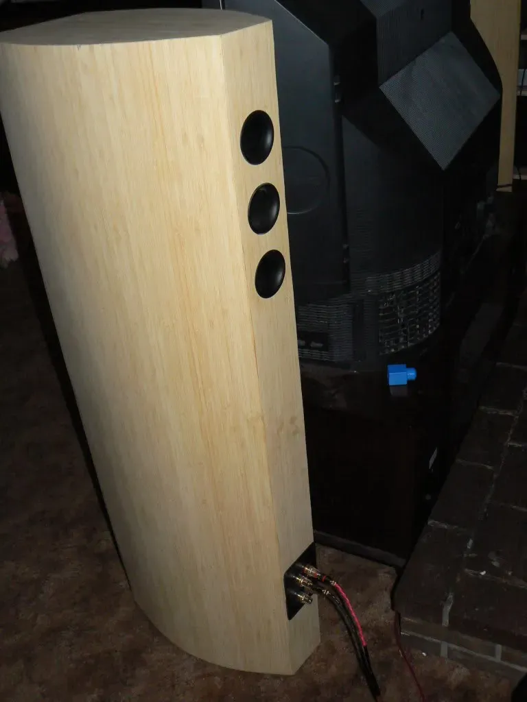

                            It's not the grain that I have issues with. Basically there are lot of parts where the veneer split and did all kinds of weird stuff because its bamboo. I haven't decided if I will stain the speakers dark or not. I was thinking of leaving the front baffle natural colored (birdseye or what not) and stain the rest of the cabinet. Or even just doing the whole thing in an epoxy gloss clear and leave it natural colored.
                            The veneer that's on there now just has to many problems. I will never use bamboo veneer again that's for sure :B

                                                    The router messed it up too I did the recesses after I put the veneer on and those parts got screwed up as well. It's just the bamboo veneer.

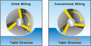

                                                                          Is there a definition for "climb cutting" somewhere? I'm going to take a guess and say it's like do a little bit back off do a little more back off do a little more. Sort of gradual cutting.
                                                                          • cobblepots
                                                                            • 102
                                                                            Unless I'm mistaken, climb cutting is similar to climb milling in which the bit is spining in a way that it will want to "climb" up and over the work piece. This helps reduce chipping as Dennis has stated. New bits also help prevent chiping. (I have a bit for veneer only)
                                                                            • David_D
                                                                              • 197
                                                                              You are spot on Cobblepots.

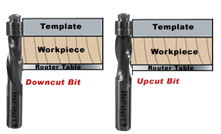

                                                                                So don't use a flush trim bit? I was thinking I'd get a laminate trimmer maybe to use this time around.
                                                                                • cobblepots
                                                                                  • 102
                                                                                  I used a laminate trim bit with pretty good results on my router. I also like to run tape just behind the edge that I'm flushing to on the veneer and where the bearing will travel. Even through the bearing is supposed to not move, I've noticed a slight pressure line when I don't use masking tape. The tape wasn't thick enough to really notice the extra veneer overhang. placing masking tape on the veneer was sort of a "i will NOT have chips" measure as I really didn't want to buy a new $150 piece of makore that would probably not match... May have been overkill but worth $3 in tape to me.
                                                                                  • David_D
                                                                                    • 197
                                                                                    +1 for tape under the bearing.
                                                                                    The down spiral flush trim bit was what I was referring to...

                                                                                    In the picture, imagine the "router table" as your veneer. The downward spiral will push the veneer to the sub-straight.
                                                                                    The upward spiral will pull the veneer from the sub-straight. This is great for clearing chips & dust but not so great for keeping that edge crisp.
