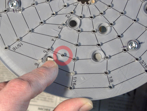

                                                I haven't tried this yet so my idea may be flawed, but on the Jasper jig, if you drill a hole half-way between two sizes along the line, would it not be a 1/32 difference?
                                                Yes, that would work. You'd want a drill press for accuracy though. Any error in placement of the new hole gets doubled when cutting circles.
                                                I've tried it, although my drill bit wandered some even using my drill press (yeah, I was in a hurry). Perhaps brad point bits would work better than a standard twist drill when used with an accurately placed center punch or awl prick.
                                                You can also see from the picture that only holes for larger diameters will work. The holes for cutting smaller circles are spaced too close together. There's an occasional router screw mounting hole to work around too.
                                                Last edited by theSven; 12 July 2023, 19:10 Wednesday. Reason: Update image location

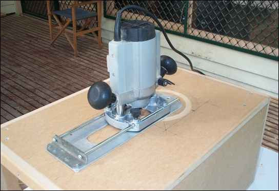

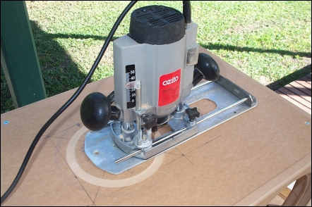

                                                                          I made my own using the slide rods that came with the router.
                                                                          Not large enough for an 18 inch driver though. For an emergency, single use solution, this actually worked!

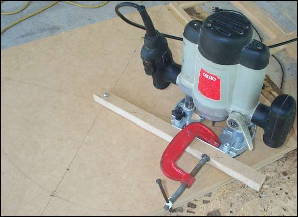

                                                                          Last edited by theSven; 12 July 2023, 20:21 Wednesday. Reason: Update image location

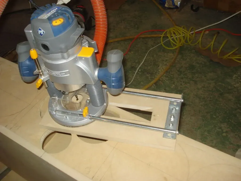

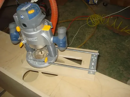

                                                                            Collo you inspired me. So I did this and worked great.
                                                                            Last edited by theSven; 11 July 2023, 20:59 Tuesday. Reason: Update image location
