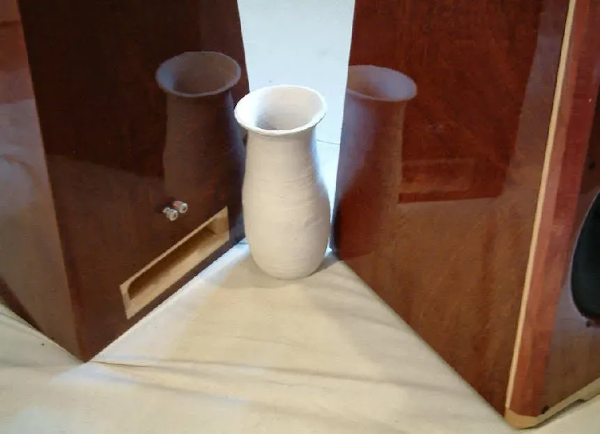

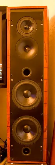

    Brad, they were custom made by a local metal worker for me. I had to put a bunch of time into finishing them, as I wasn't happy with the level of finish they provided. But, they turned out all right. I drew up what I wanted in AutoCAD and sent it to them so they could copy it. It uses the same punch outs that the binding plates at Parts Express use, so you can use pretty much all the binding posts at PE that are meant for that style plate.
    If anyone is insterested in the AutoCAD drawing or a pdf, let me know. I'm sure most any metal worker can do these for relatively little money.

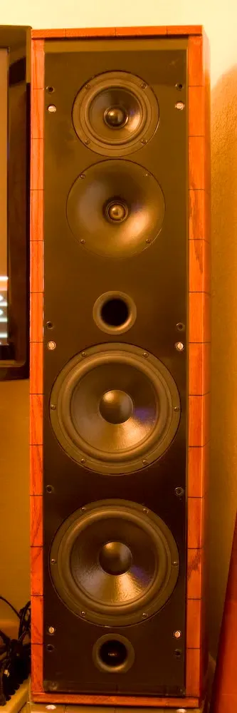

      Originally posted by Jed
      Watt/Puppy's are no match. :B

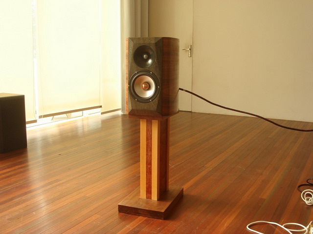

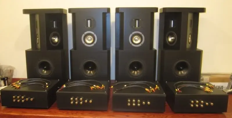

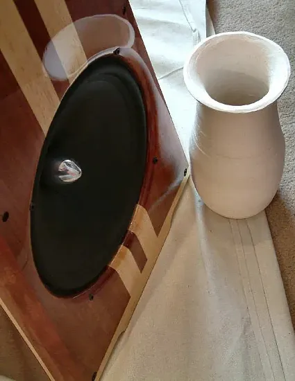

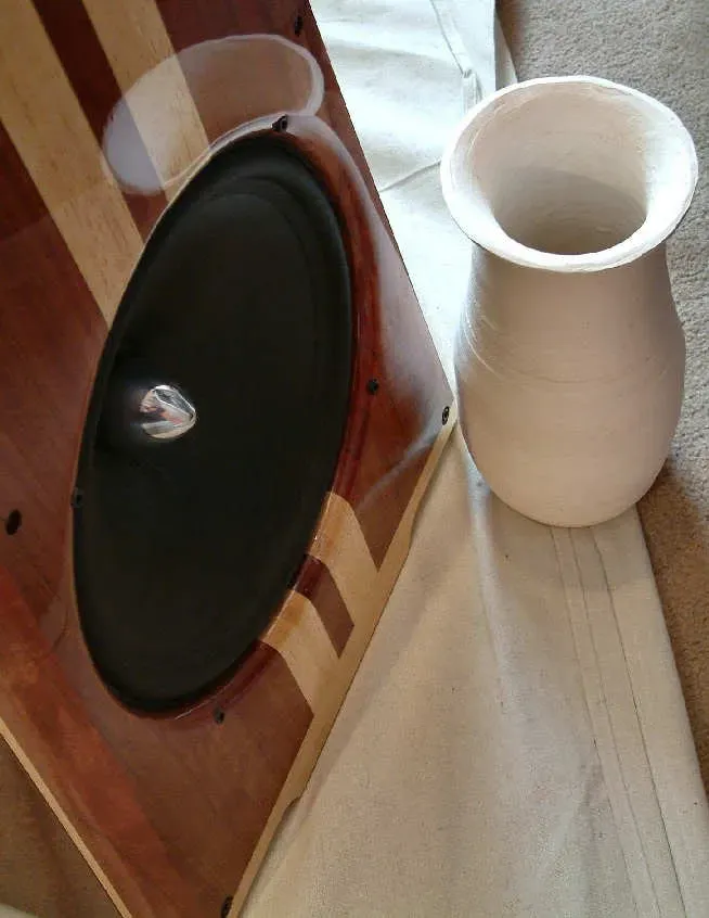

      The 7's are very good speakers, but in his room, in his system, we both preferred the Zaph L18 design I took down there. Part of it has to do with the unavailability of proper placement of the 7's in his room.

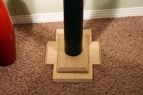

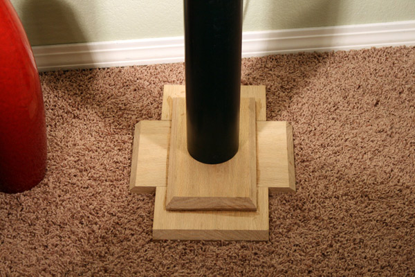

      ...but this is finish thread, so I should probably post something related to finishing. Here is a pair of Troels Ekta Grandes that my friend just finished in fiddleback anigre..
        Brad - you can purchase a fly cutter and some scrap 6061-t6 aluminum. If you have a drill press it's really easy to cut these. Drilling and countersinking the holes ease really easy. If anyone would like some of these type of plates please let me know. I have the equipment out at my hangar at the airport. We do this for instrument panels all the time.

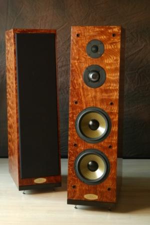

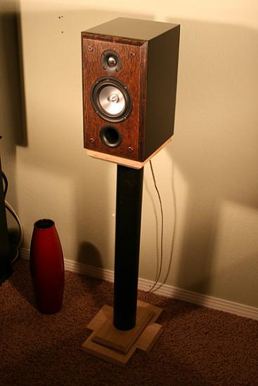

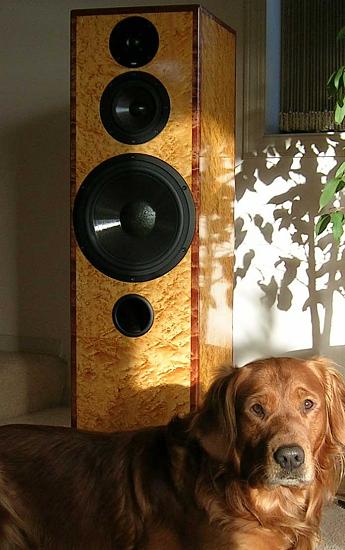

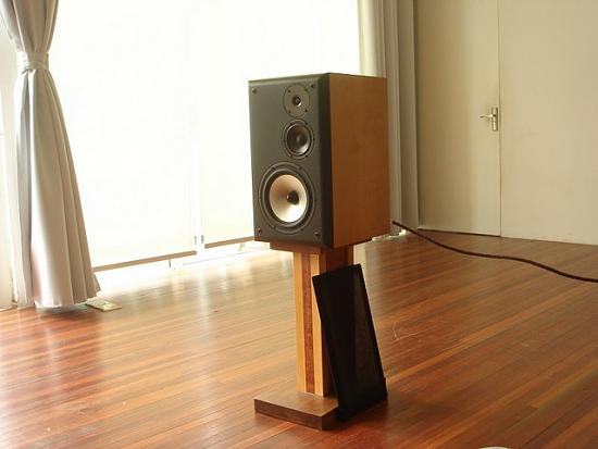

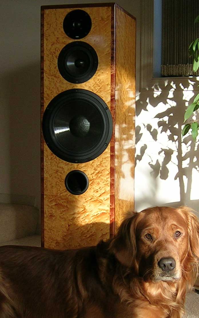

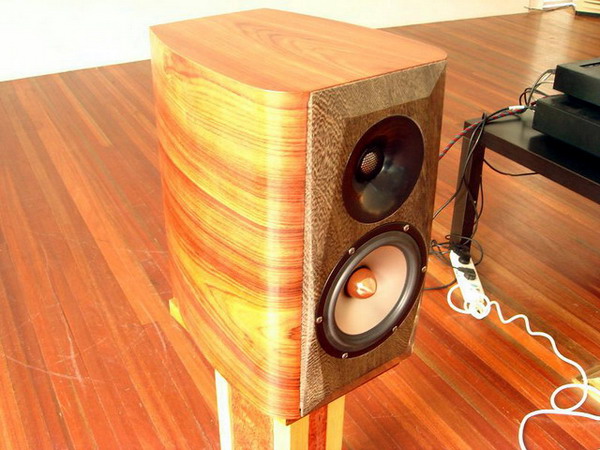

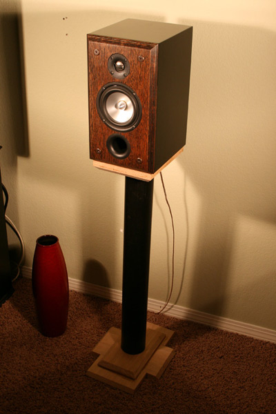

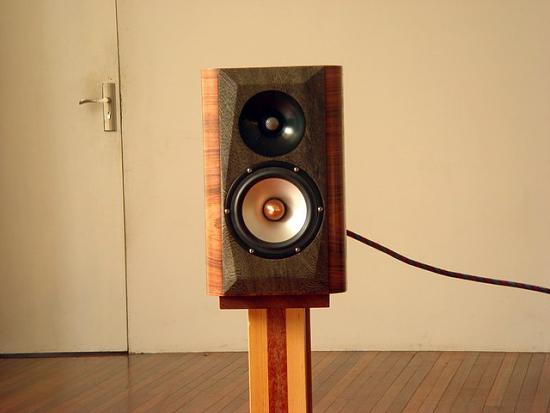

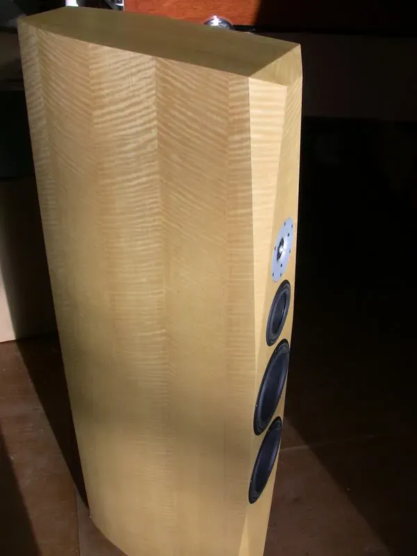

          This is an Eton 3-way finished in natural bird's-eye maple veneer with makore edging. As you can see, the maple has some interesting figure in addition to the bird's-eye. I was fortunate in finding eight sheets cut from the same flitch, so I could build a pair of these quite large speakers with matching sides as well as fronts. I was lucky enough to find a board of figured makore in my local hardwood store.
          I used aniline dye (hand-mixed for colour) followed by polymerised tung oil. This was something of an experiment and it turned out to be quite fussy to use. I wouldn't choose it again...maybe use the natural tung oil instead.
          Martyn

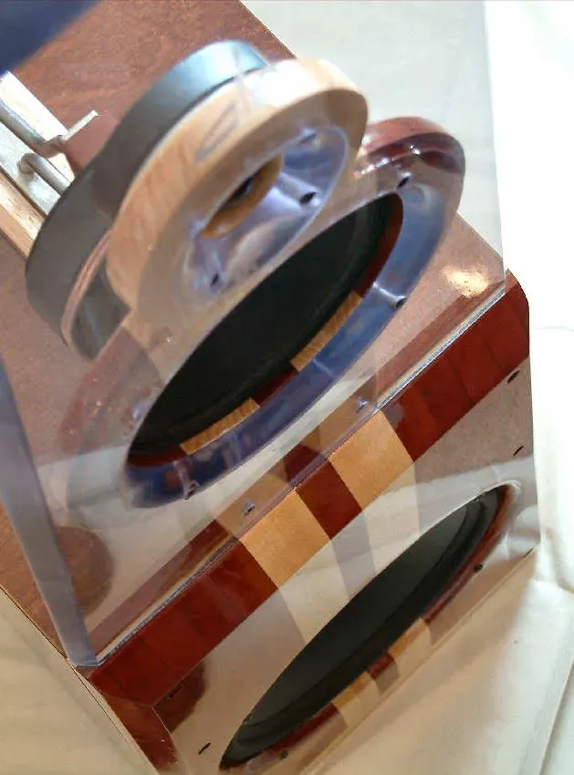

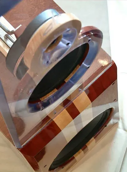

            I finally took some photos of the Duo's. The Dou's

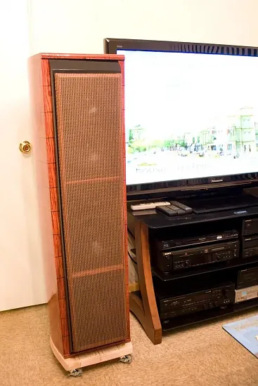

              Rolex those cherry towers look amazing. How did you accomplish that finish? Any more pictures?
              • Rolex
                • 386
                Thanks, that finish was one of the easiest I have done. It is wood backed cherry veneer so you can use the iron on method. THe veneer was left natural in color, then I applied a lacquer finish with airless spray equipment.

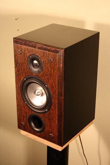

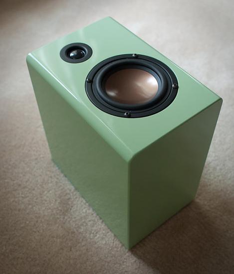

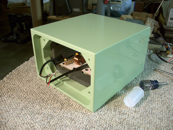

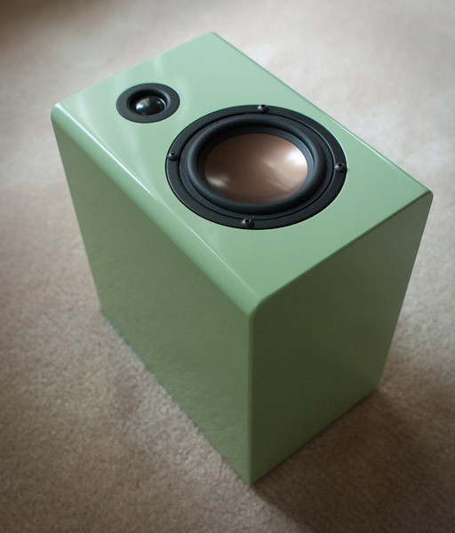

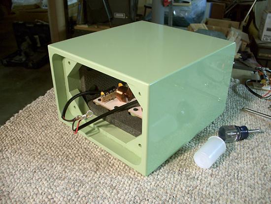

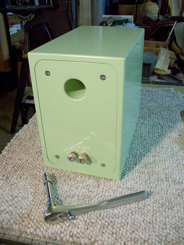

                            I built Paul Carmody's Overnight Sensations this past autumn and tried to avoid solvent-based paints as much as possible. I mixed a custom green color from General Finishes' Antique White and Sage Green Milk Paints, and clear coated with General Finishes Glossy Polyacrylic.
                            All these coatings were water-based for no-smell application and easy clean up.

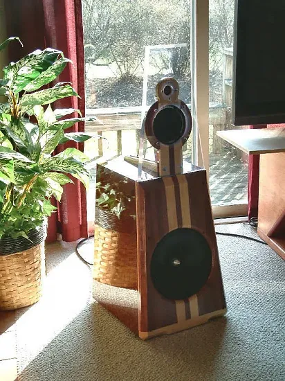

                                  I forgot about this thread! Here is my newest, the BaSSlines:

                                          Bill, did you apply that green with a spray gun?

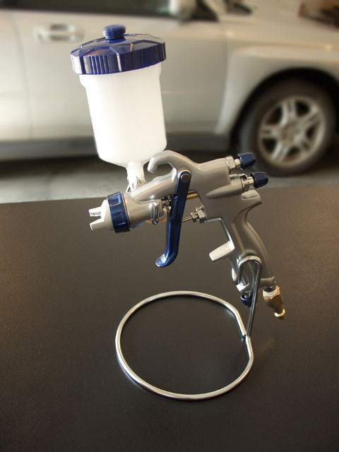

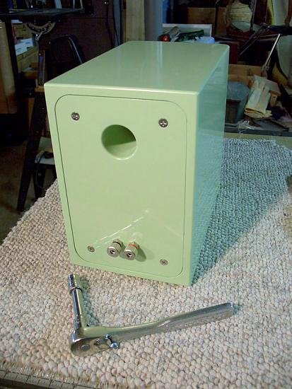

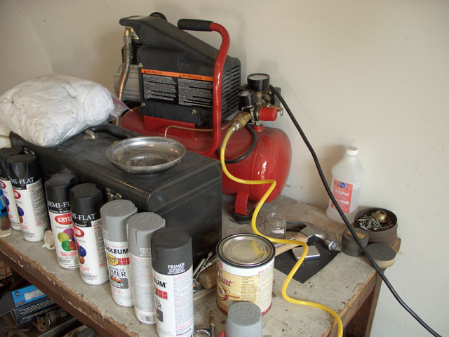

                                            Yes. I used a small gravity feed Kobalt spray gun from Lowe's (~$40).
                                            While I used a larger compressor for this job, you could do just fine with this small 1 HP/3 gallon Sears compressor (~$100 on sale) and the little gun.
                                            I've painted much larger projects than speakers with this inexpensive combination. Pause to give the little compressor time to catch up occasionally, and it does fine.
                                            I diluted the water-based milk paints (purchased from Woodcraft) 1-2 oz water to 16 oz. paint depending on color. It takes a little experimentation to get it right, and each color I use requires a different dilution. The clear is almost water-thin, so I didn't dilute it.
                                            Strain the paints before applying using strainer cups from a place like Sherwin-Williams. Otherwise you end up with little paint boogers all over the surface. :cry:
                                            After building several clear coats over the color, then it's elbow grease time with fine abrasives, polishes, and finally wax.

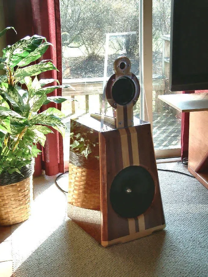

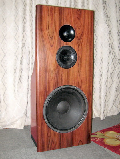

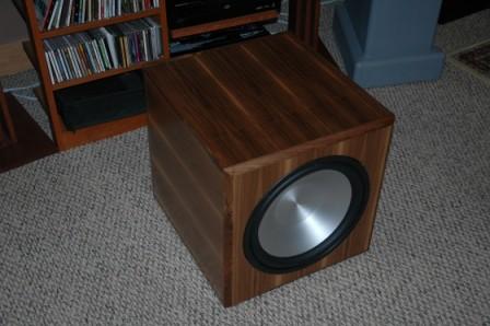

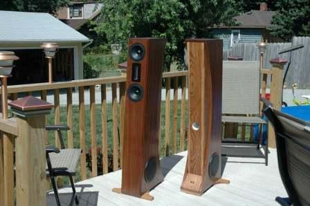

                                              Here are a couple of projects that I have done in Walnut.

                                                            Took me Long enough!!!
                                                            Originally posted by dsrviola
                                                            Can you tell us more about your speakers, and do you have larger pictures? They look lovely.
                                                            Sorry for the delay in getting back on this. Nebraska snow storms have been brutal on me.
                                                            The speakers were nicknamed "The Scimitars". I built these for my Sister and Brother-in-law. I used an Aurum Cantus G3si Tweeter that I won at DIY Iowa, and some Vifa P14 buyouts along with a dayton classic 8" to hold down the low end. It has been several years since I made those, but IIRC, the cross-over points were in the 400hz, and 3300Hz range. Curt Campbell did the cross-overs and we voiced them in together. The face plate is solid walnut over an MDF sub-baffle, the sides are MDF w/ walnut veneer, and the backs and inset sides are solid oak. Tops are solid walnut as well. They are a fairly relaxed sounding speaker (necessary due to the crap my sister listens to on her IPOD).
                                                            The Sub is made of Walnut veneered plywood and was built for a gentleman named Taqi who lives in Ireland. He chose the Accoustic Elegance 15" after hearing about them from James Buckhalter (I built him 2 of those boxes out of cherry). The edges on the sub box are solid wood to stand up to dings and moving.

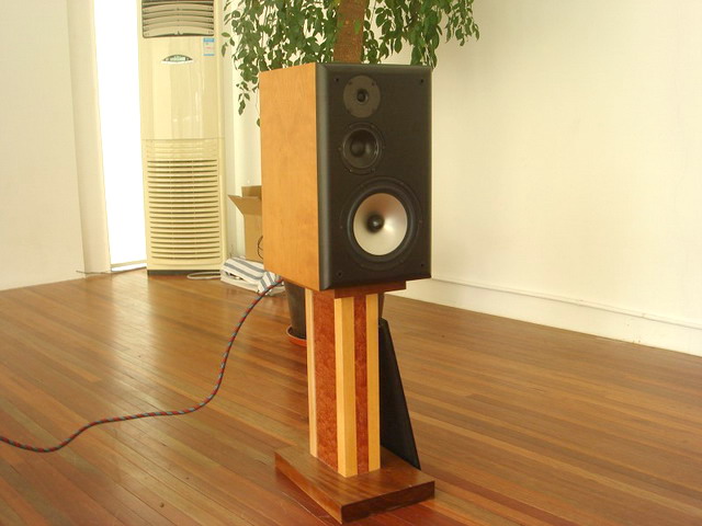

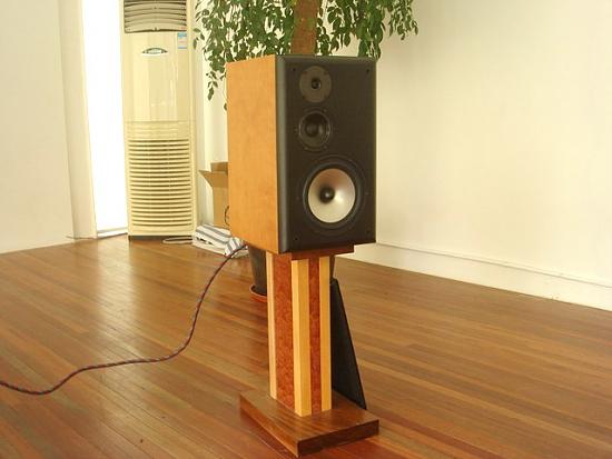

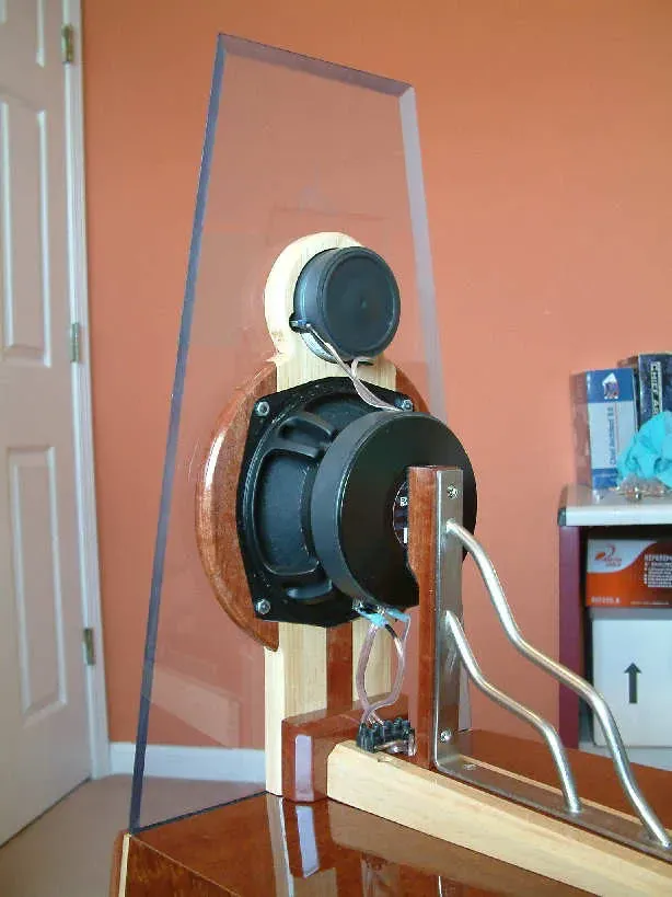

                                                                    • WE4242A
                                                                      • Jul 2010
                                                                      • 7

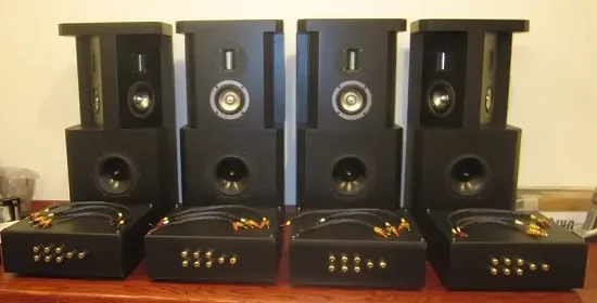

                                                                      others
                                                                      OB project and 3 way classics
                                                                      Last edited by theSven; 24 June 2023, 20:20 Saturday. Reason: Update image location

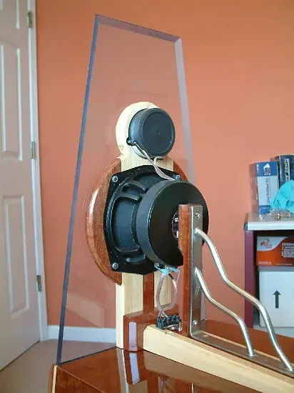

                                                                          Zaph‘s all metal project

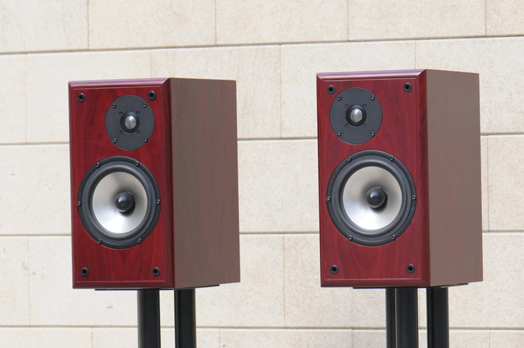

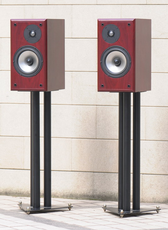

                                                                                        • juliovideo
                                                                                          • 63

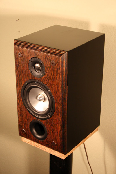

                                                                                            I'm not worthy!!!
                                                                                            Mahogany ply stained ebony + krylon satin black box + un-finished diy stands.
                                                                                            Oh. zaph za5's..
