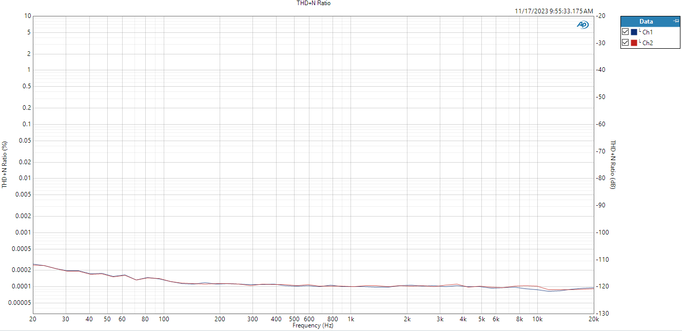

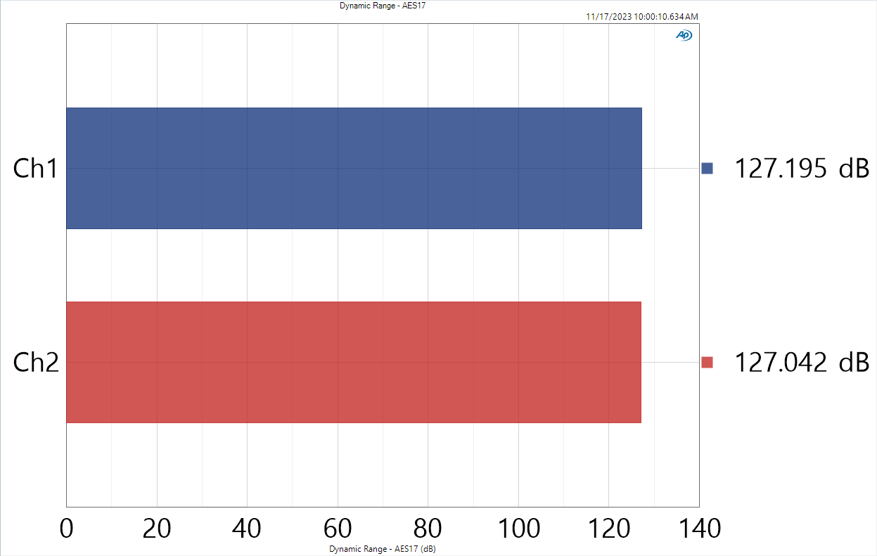

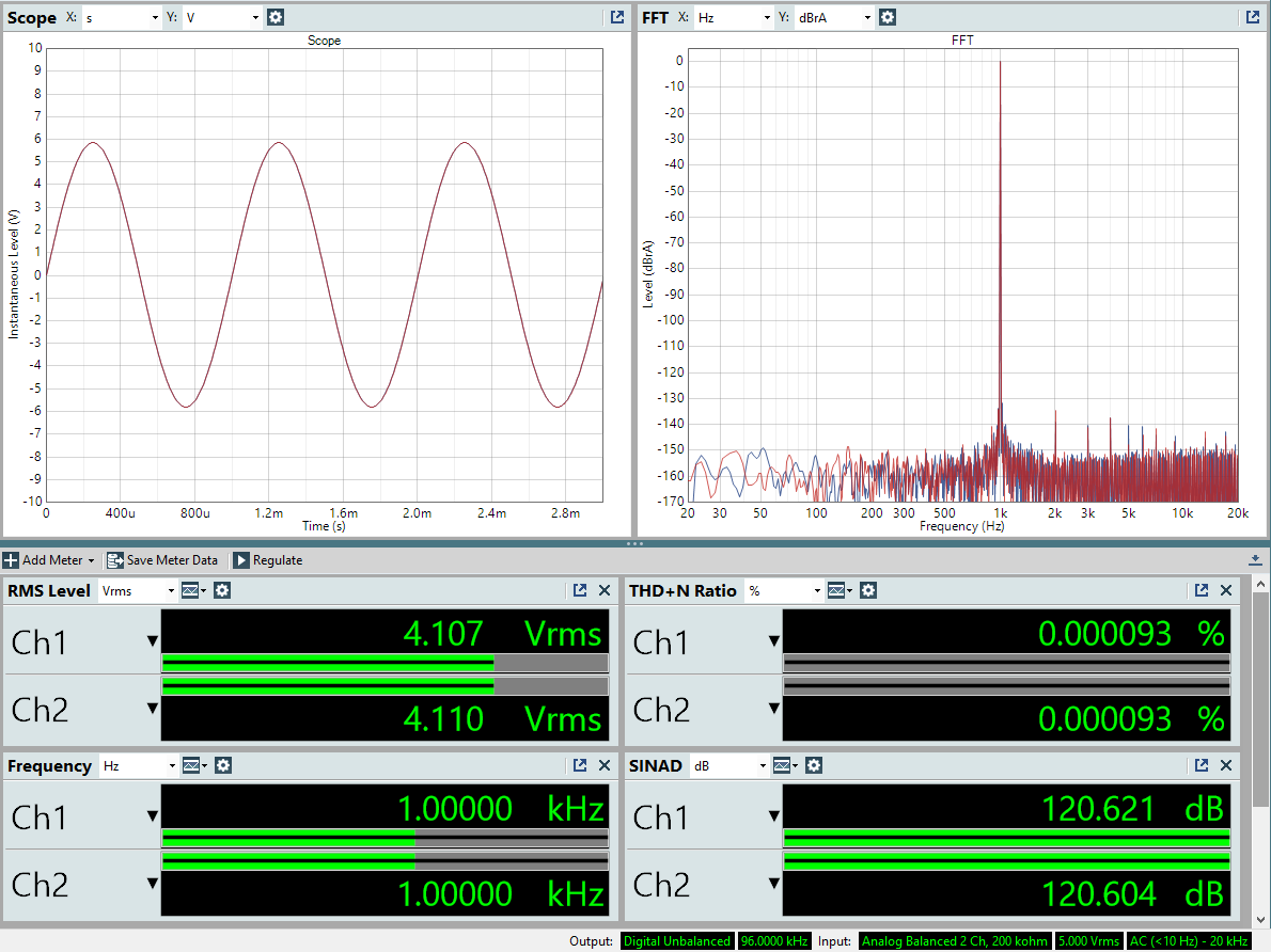

              I’ve found something affordable that you might consider dipping your toes in, before you invest in 8 channels of R2R DACs:
              https://www.minidsp.com/products/ht-series/flex-
              probably as neutral and honest as the best professional DA converters used in studios in the late 20th century eg. Prism, Digidesign, Apogee. Of course if you’re looking for DAC to sound like your favourite DAC then it’s probably not your cup of tea.

                I'm using the miniDSP Flex8:
                two channel (16 or 24 bit) digital input with EQ followed by 8 channels of [EQ, crossover, delay, gain, etc.], and an 8 channel DAC of newer vintage than their earlier boxes. They claim this DAC is better. There is some online distortion testing by a third party.
                The EQ and crossover can optionally be entered as biquad coefficients. So I am currently using a 3rd order Bessel mid-tweeter to mimic a certain JM's quasi 3rd order LR idea.
                It may not be the ultimate but given my budget, this unit saves me from paying a fortune for quality crossover components every time I make a change or experiment.
                One limit that will put some people off is they didn't increase the processing clock speed from the earlier units. It's still doing 96KHz. wish it was 192KHz.
