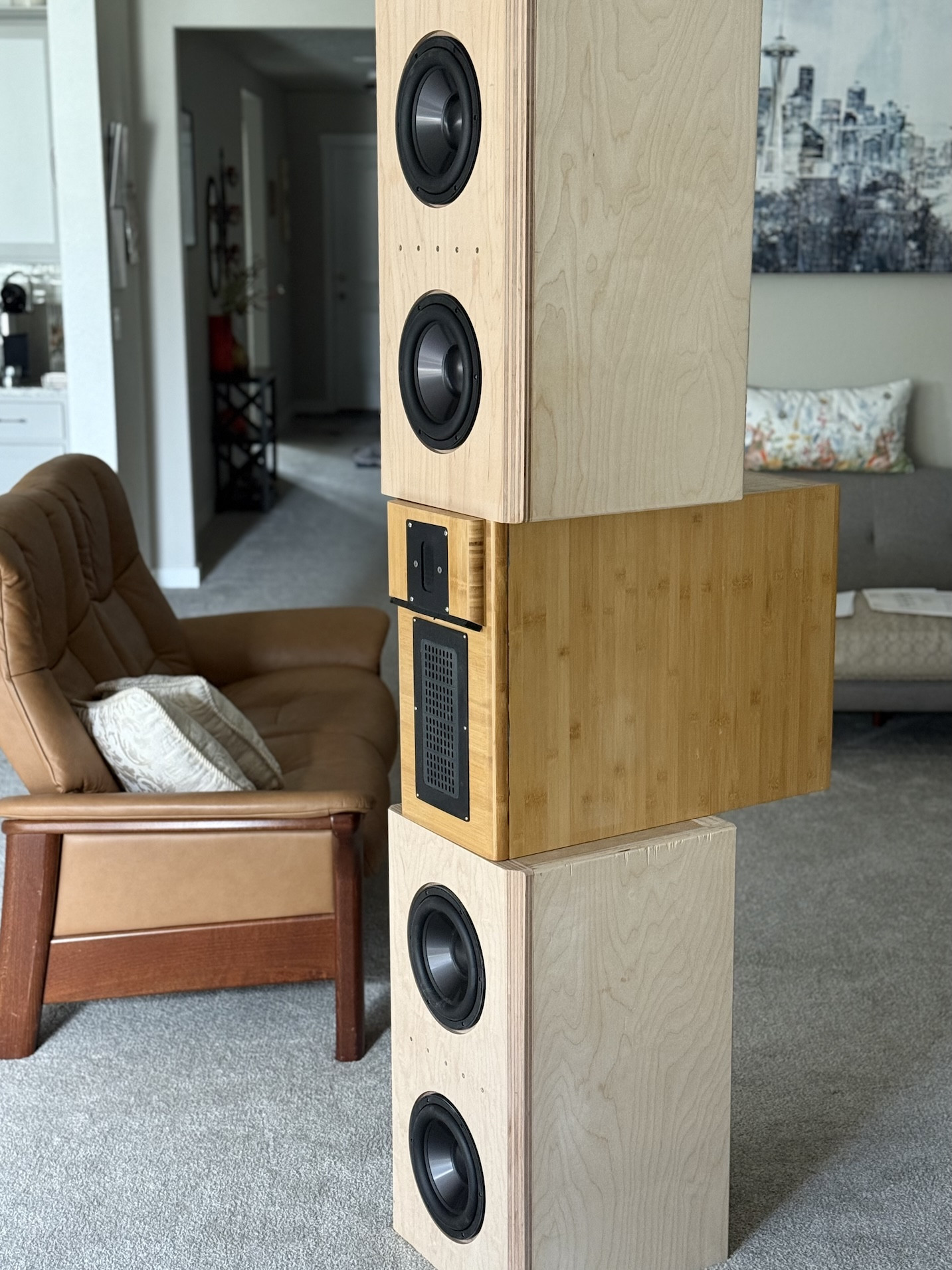

      Funny thing is, I have MF-HF basic test cabinets built, and it would be easy to take one of my full size Saint-Saëns V3 cabinet or stack two of the mono woofer cabinets being built to have the basis for trying this out- the only problem is TIME, or lack there of, with so many things on the table, including non-audio unfortunately.
Name:	Kii MF-HF Round over.png
      I've been talking with ET about modifying the Kurosawa's to use that MF-HF combo, and have some new maple planks for updated front panels. Of course, the issue there is that the woofers in that project are hideously expensive, but since they're on hand, no worries.
      Now, using the RSS210 and that MF and HF combo, my approach would probably be to use the tried and true home brew LR3 crossover topology (No, Linkwitz had nothing to do with that, though I did run it by him and explain the idea in a past California meeting.) Basically, an Ardent style crossover.
      Because, of course, the combination you describe would work fine in a Wavecor Ardent style cabinet.

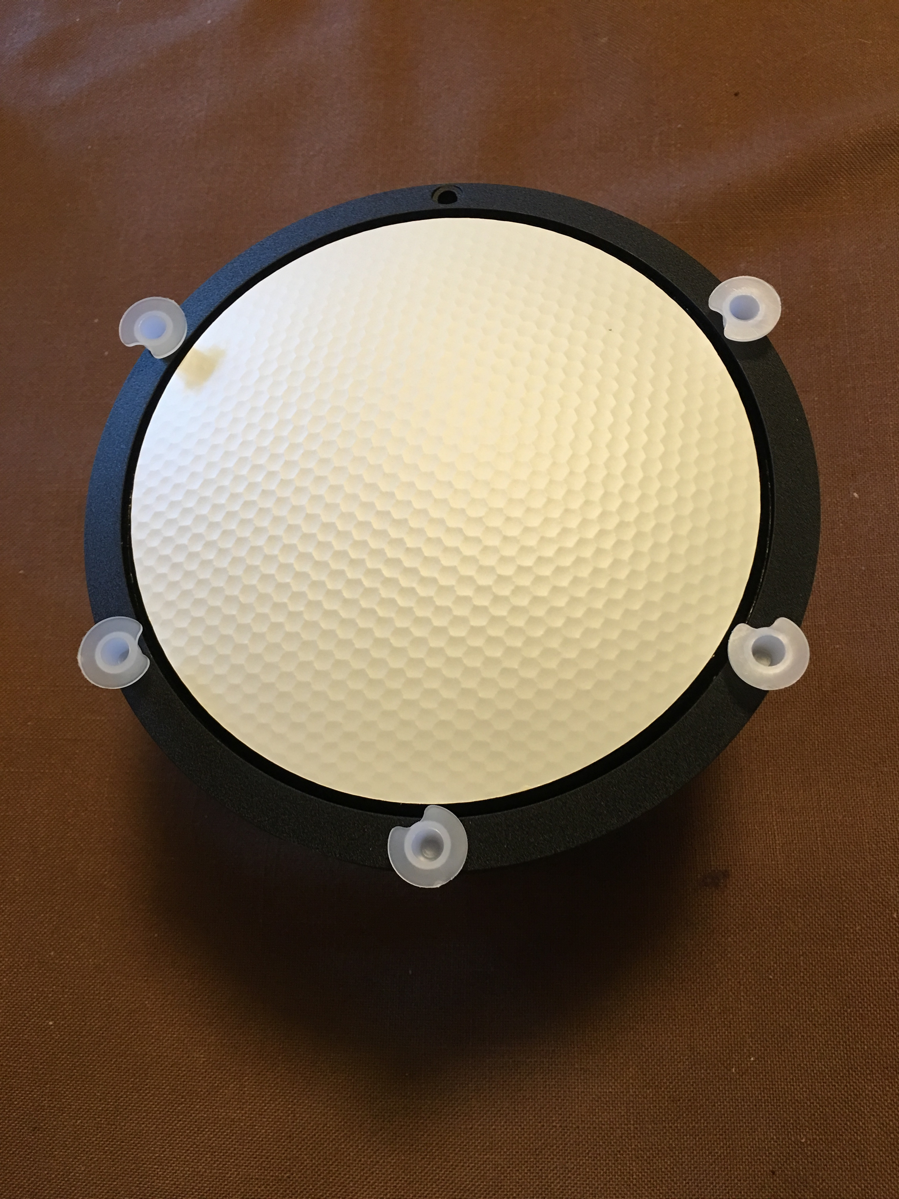

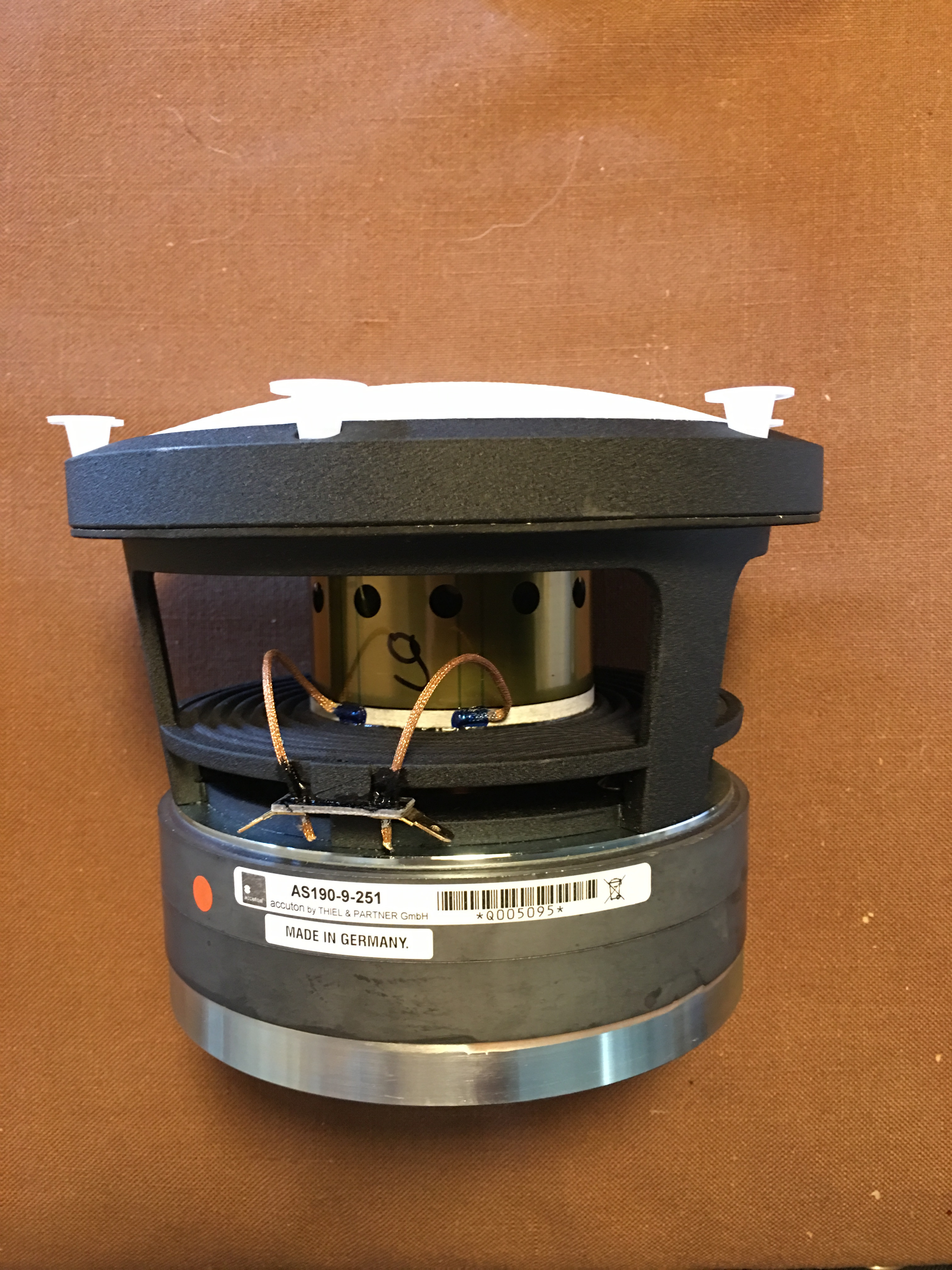

            The woofers used for this project were/are the Accuton AS190-9-251. My recollection of the price when I bought them 10 years ago was about $500, through a European vendor. (no American vendor had the quantities- and were asking about $800 each). Now, I see pricing between about $1,250 and $2,100 each, depending on vendor and location. (that high one was probably after one of the recent egregious tariff bumps).
            Pictures from 2016, that I'd sent to Michael Bell (HTG member and past collaborator)
            Click image for larger version  Name:	image1.jpg Views:	0 Size:	2.12 MB ID:	960263
            Click image for larger version  Name:	image2.jpg Views:	0 Size:	2.13 MB ID:	960264

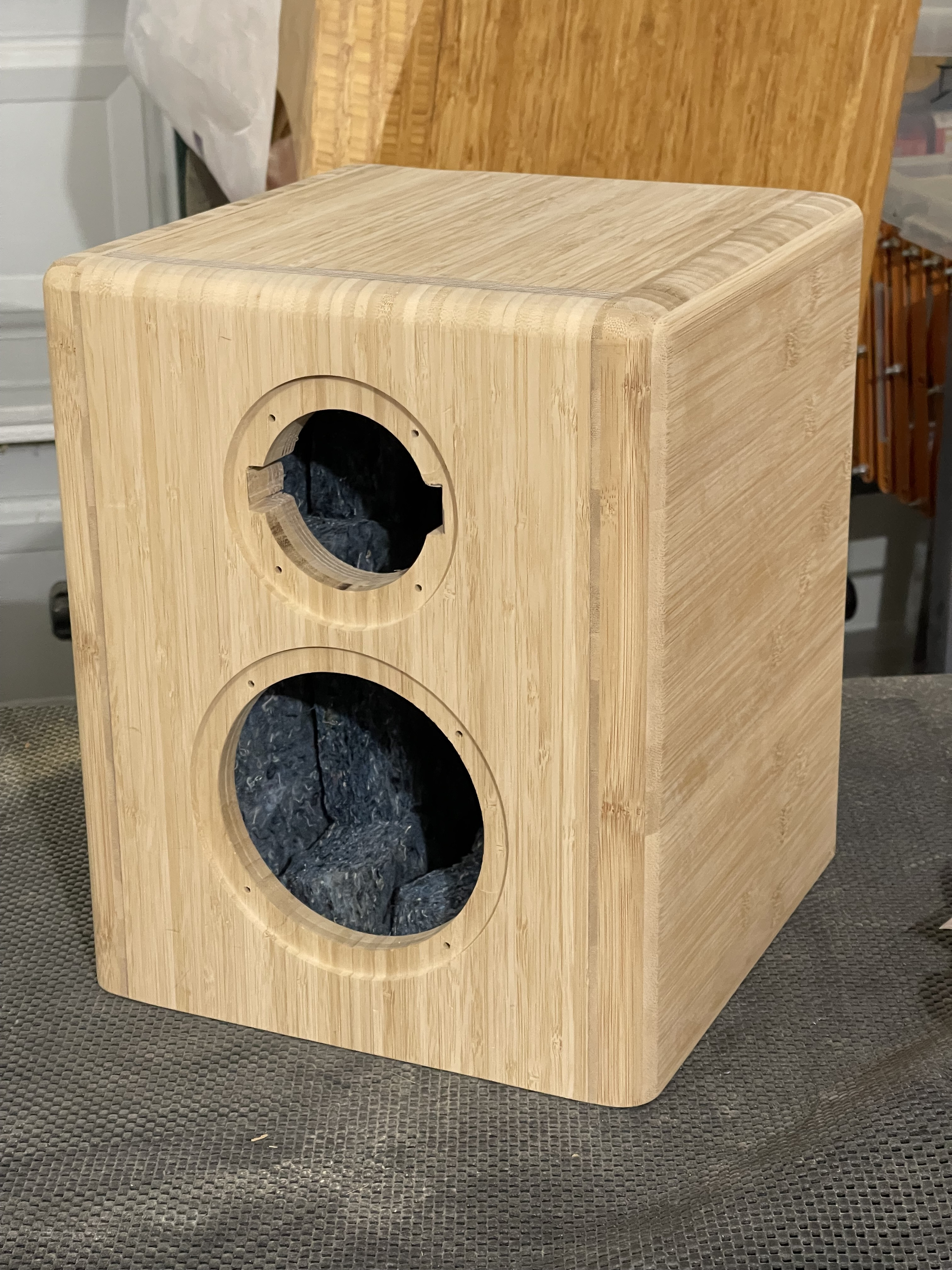

            The HF version is the so-called high fidelity one, (different VC mechanics) and other bits, intended for larger enclosures. What you probably need is the HO version, Iike I'm using in the V3 of Saint-Saëns- I have both dual driver cabinets and now completing single driver cabinets, that could be stacked, of course, but mainly to ease the lift load of assembling the complete system in place. (the dual driver cabinets are about 100 lb each, and one could say a "kluge up" as I start with a PE MDF cabinet designed around the RS210HO and then build up a stronger shell around it using mostly BB ply. Transfer function for either version is about the same, but I have alternatives for both 4 ohm and 8 ohm version; dual driver is two 4 ohm parts wired in series, as the original intention was to parallel two of those cabinets for a net crossover load of 4 ohms.
Name:	POC V3 Side.jpg

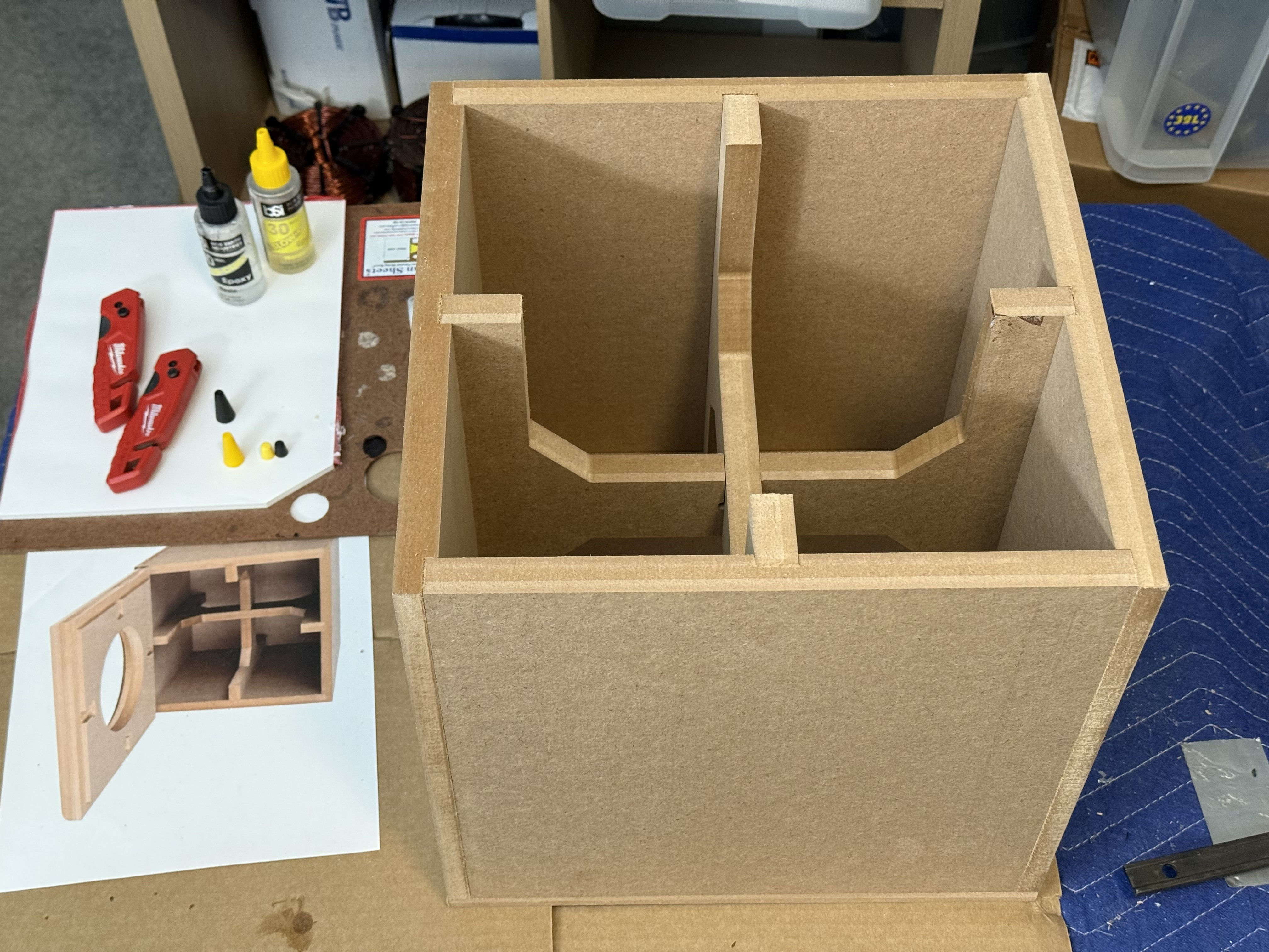

            Starting point after assembly from PE- their front panel thrown away.

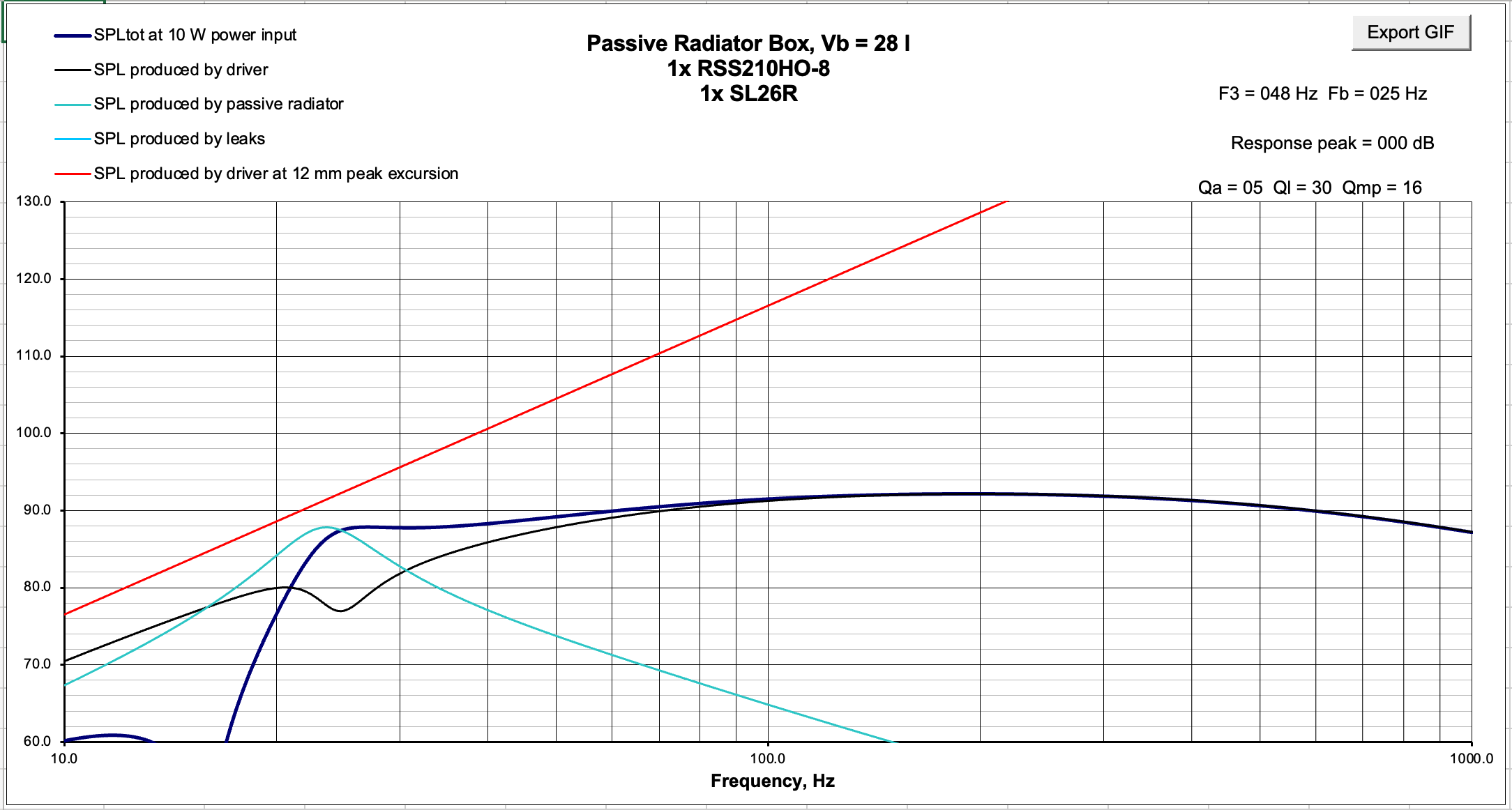

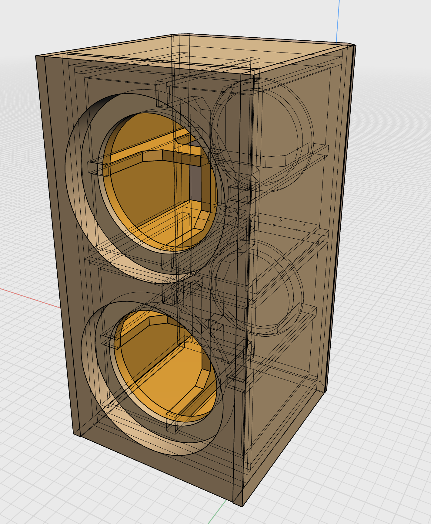

            This is one of the more extended LF alignments I was looking at for 28L, using Seas SL226R passive radiator (I think just one added disk- mass is in my XL files). Fully stuffed to adjust LF level in a room and system Q.
Name:	Screenshot 2026-03-18 at 9.58.12 AM.png

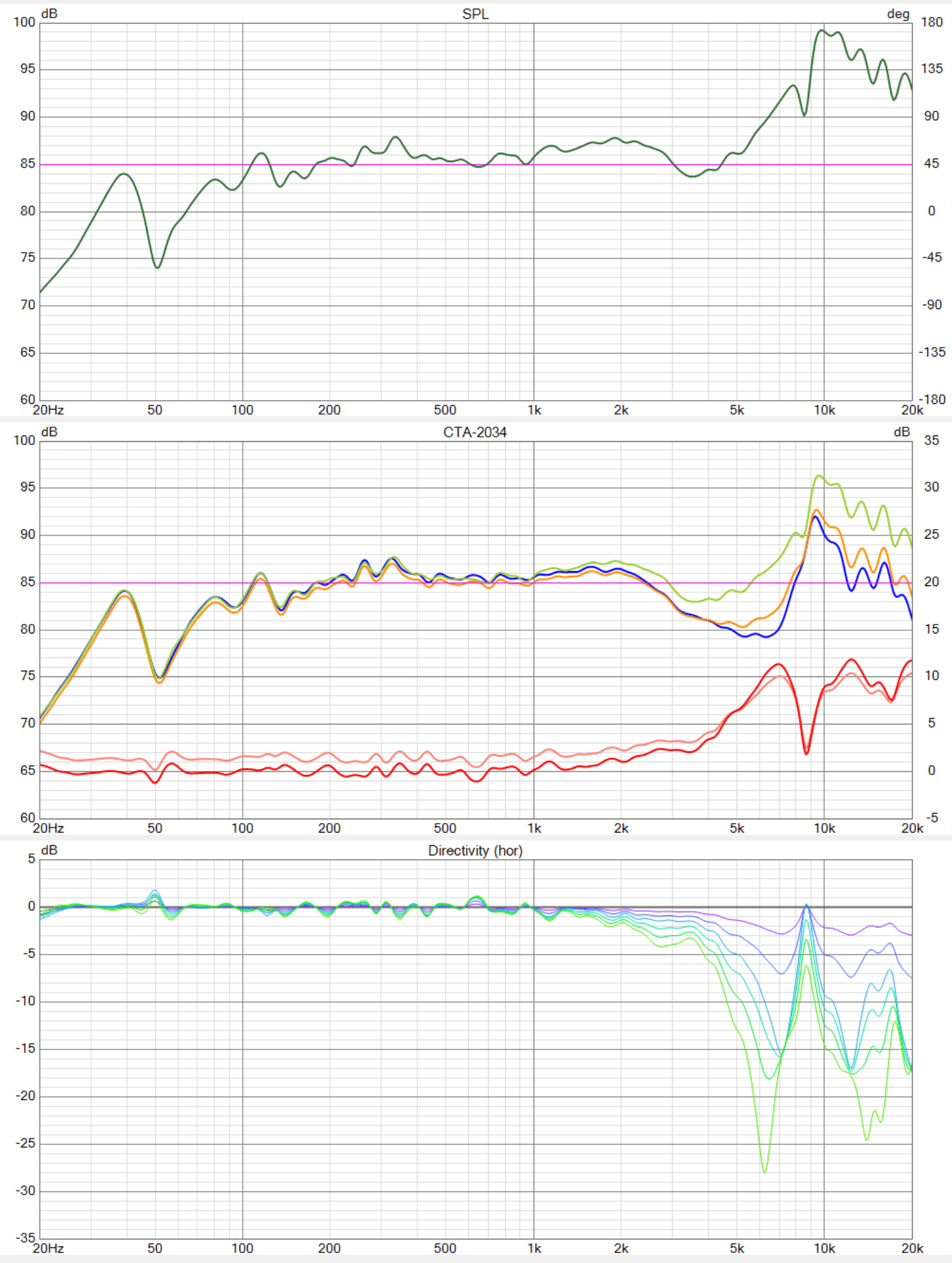

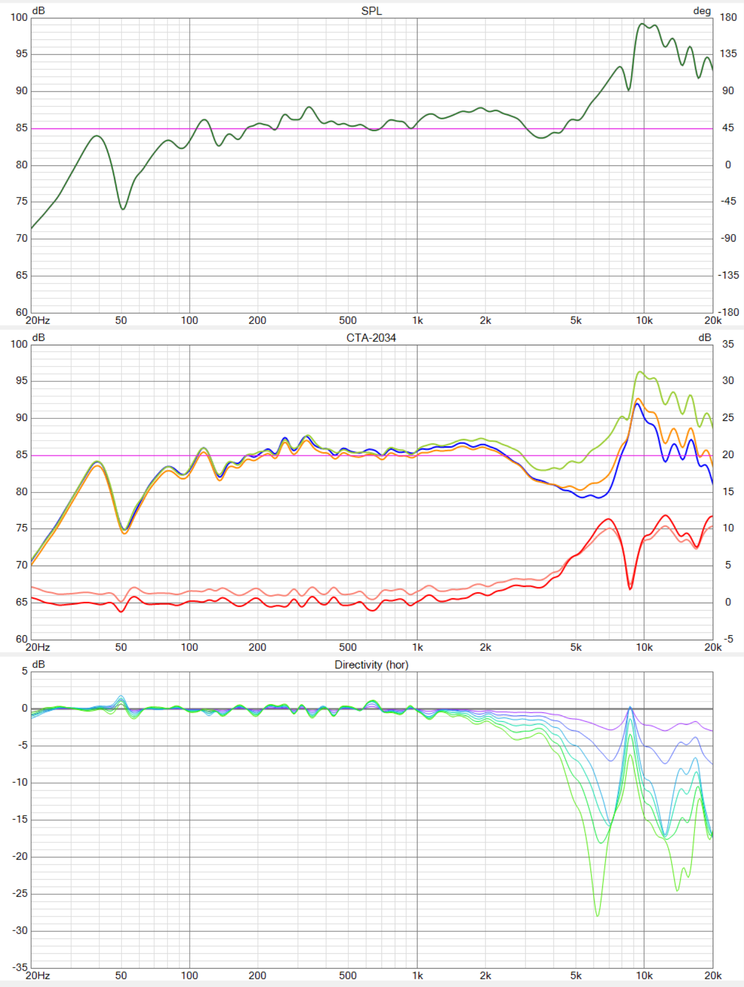

            • 16203
            witness this response plot in test enclosure, 28L if I recall correctly for one AS190, relatively long sample window (100ms) and 1/24 octave smoothing (low smoothing, IOW):
Name:	AS10 On Axis 15cm.png
              JonMarsh commented
              Editing a comment
              This was a simple sealed test enclosure; LF roll off is due to low system Qts.

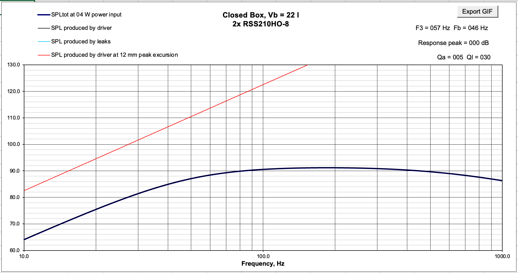

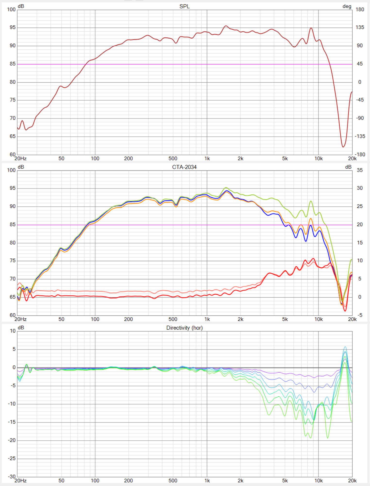

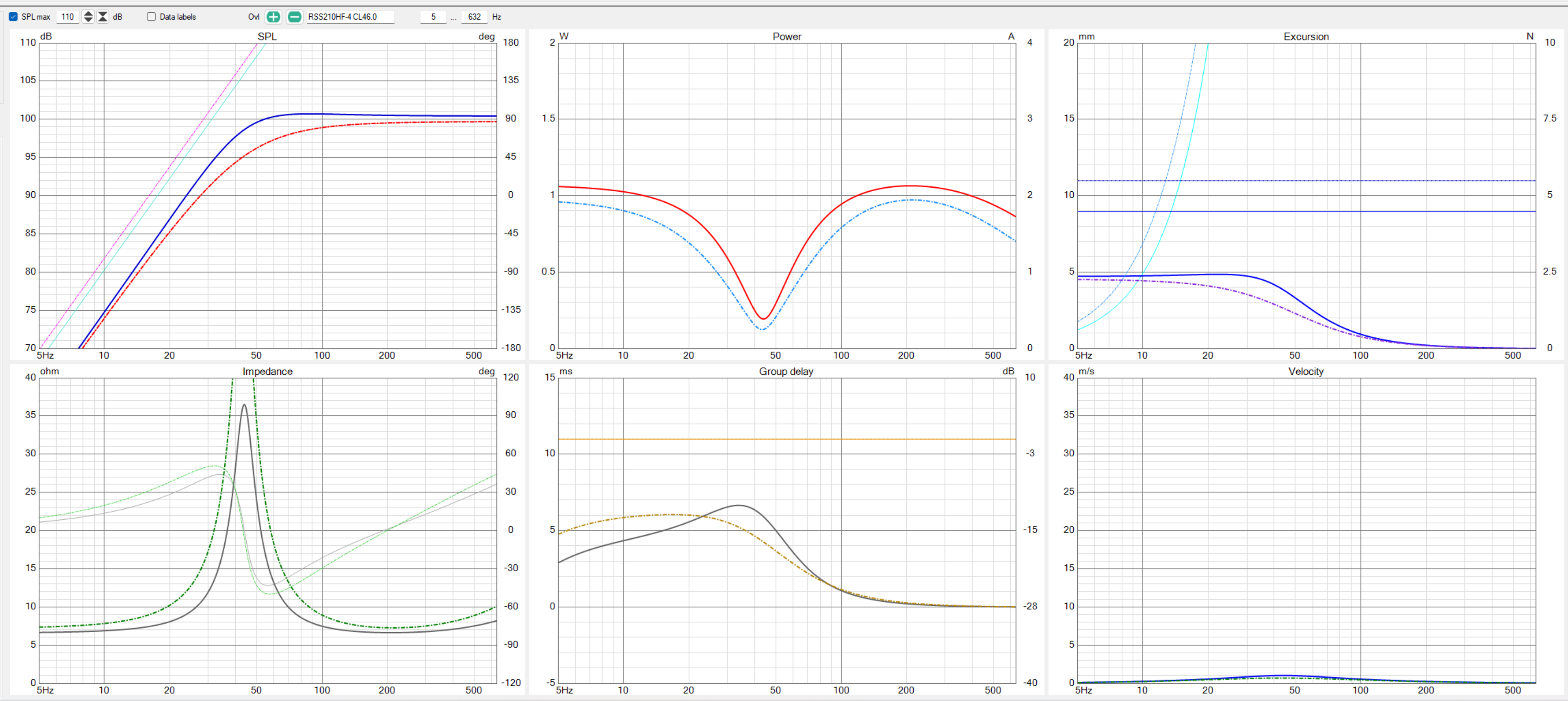

              A couple of graphs to compare- RSS210HO-4, 2x wired in series, in 22L and 37L
Name:	Screenshot 2026-03-20 at 8.44.34 AM.png
Name:	Screenshot 2026-03-20 at 6.53.46 AM.png
                JonMarsh commented
                Editing a comment
                Either cabinet combo is capable of a maximum of 100 dB at 30Hz at maximum rated excursion sealed. Placement can provide some LF balancing via controlled boundary reinforcement and of course there's the simple expedient of passive inline shelving EQ between preamp and power amp as described in other posts on the forum.
                JonMarsh commented
                Editing a comment
                Note that the power levels for the Unibox evolution are different for these two graphs; 1 watt versus 4 watts.

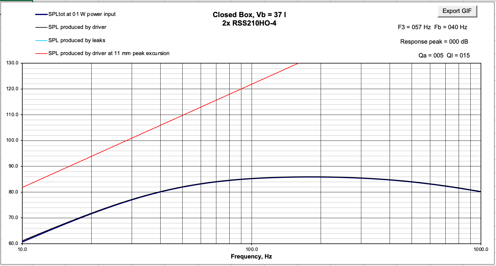

              Click image for larger version  Name:	image.png Views:	0 Size:	583.4 KB ID:	960292
              In the top left, you have HO (pair, in series in 33 cubic liters, about 0.707 alignment) vs. HF (pair, in series in 46 liters, about 0.75 alignment). I'm trying to stick to the HF, as that is what I have on hand. You have a little bit of a bump, but that may not necessarily sound bad.
                • 16203
                Looks pretty reasonable to me! 46L is still a fairly petite size- just imagine the size you would need with two PuriFi PTT8.0 or two MW19TX-04!
                (would have to be reflex due to their low Q; large due to the cone mass versus CMS.)

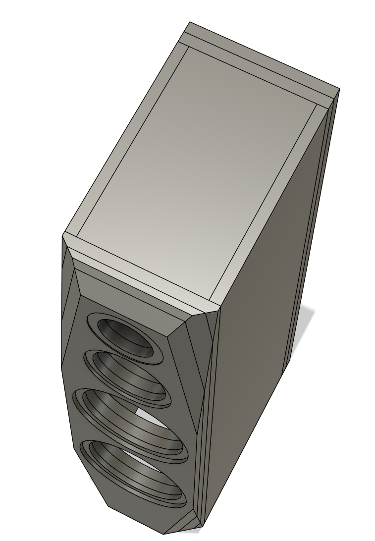

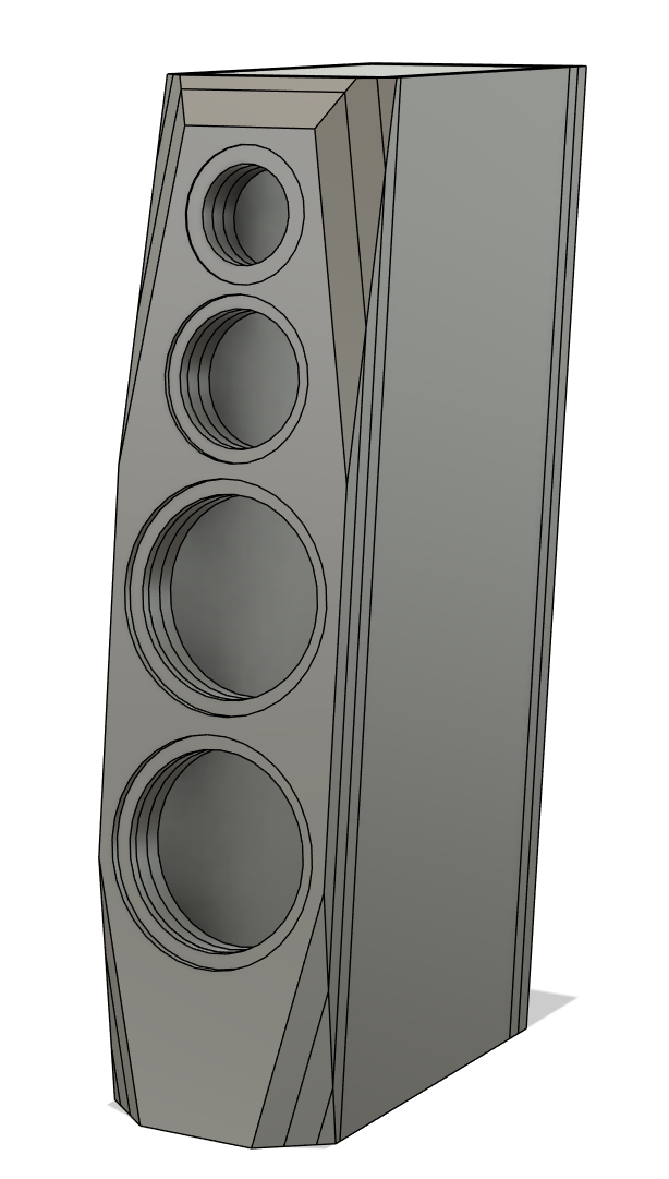

ID:	960301Click image for larger version

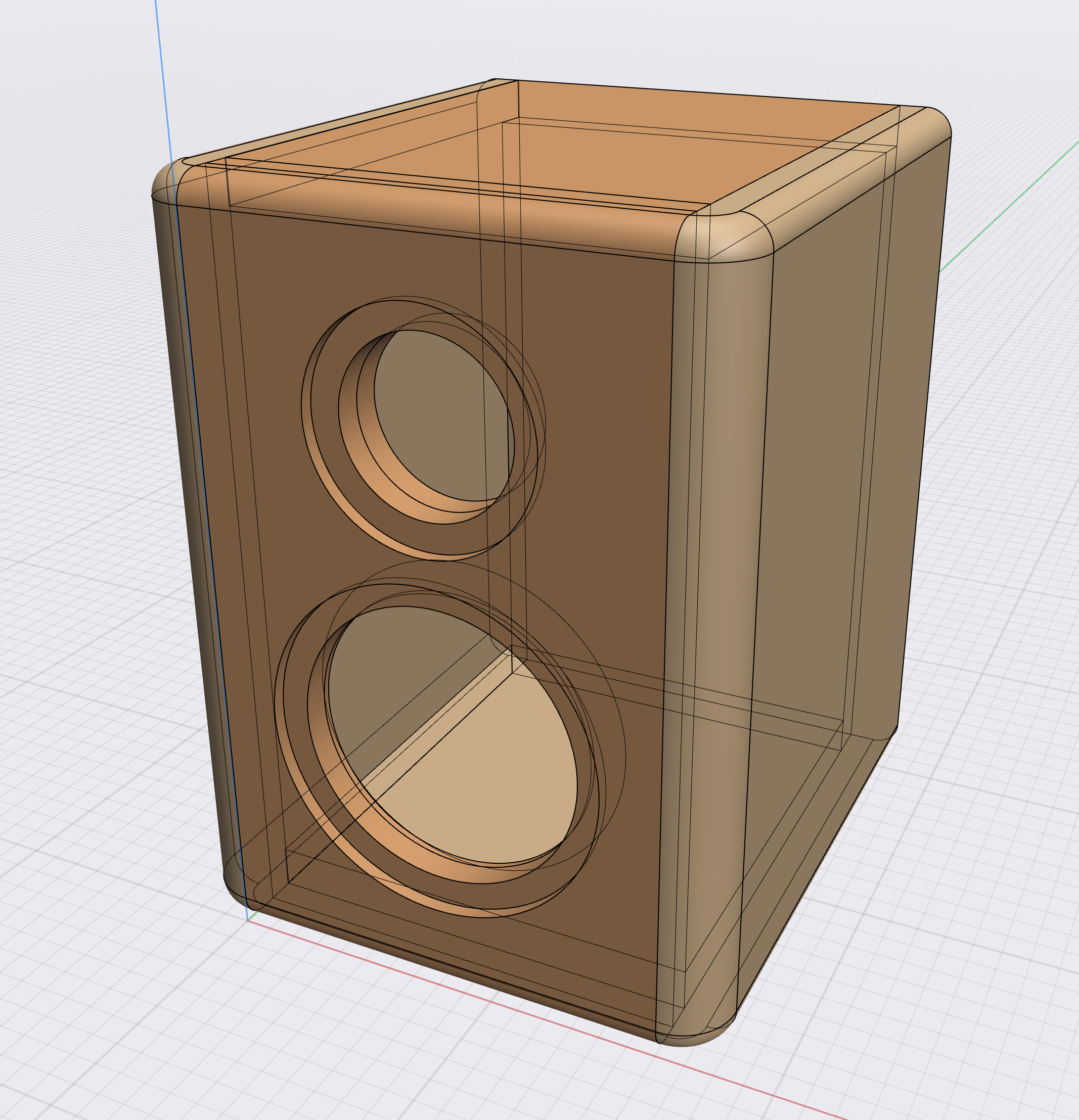

                    Quick drawing -- just to see what the proportions may look like. This is roughly 950mm tall (37.4"), 240mm wide (9.44" wide) , and 420mm deep (16.5"). This is likely about as small as we can go. ​Right now, the side walls show one layer. This will likely be 1 layer of 18mm BB + 1/2 or 1/4 MDF.
                    My big concern right now is I suspect there will be possibly material directivity mismatch between the tweeter and mid.
                      JonMarsh commented
                      Editing a comment
                      Classic!

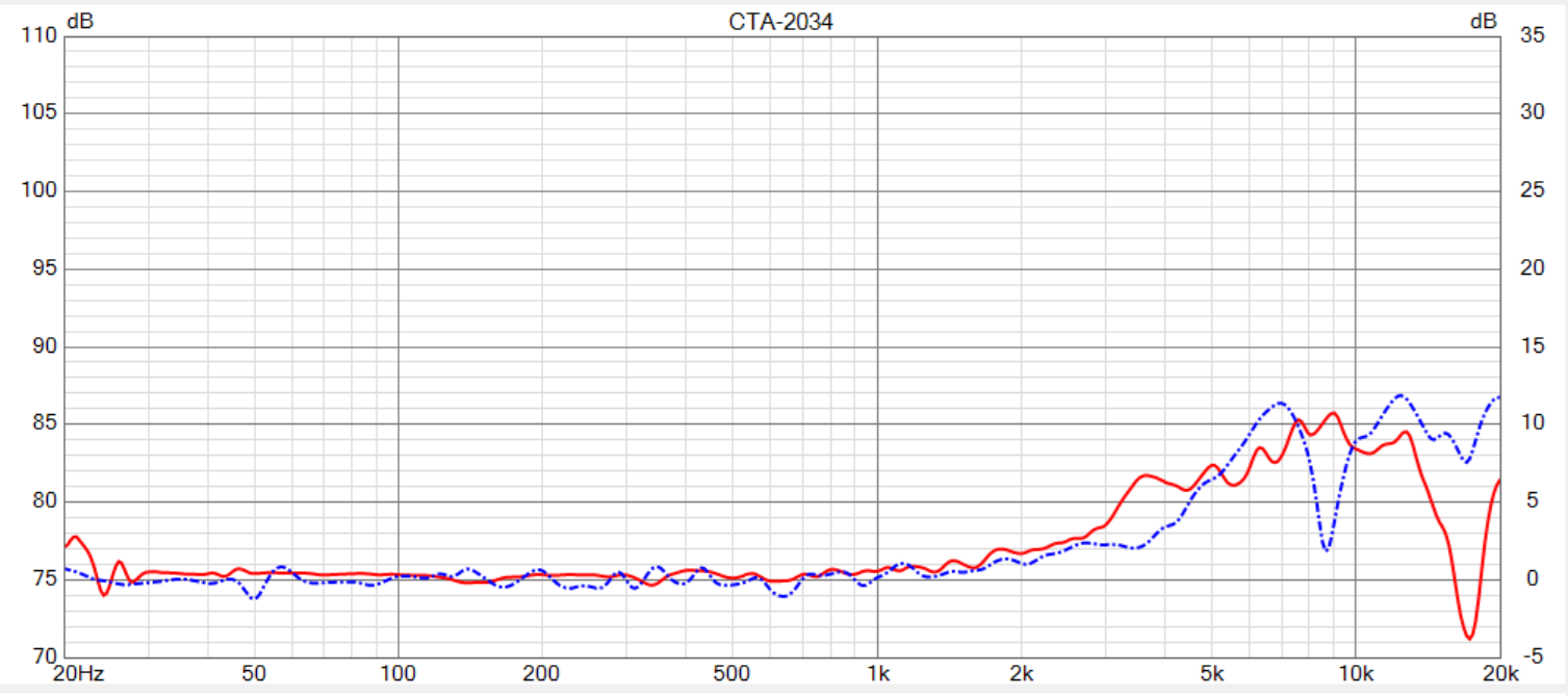

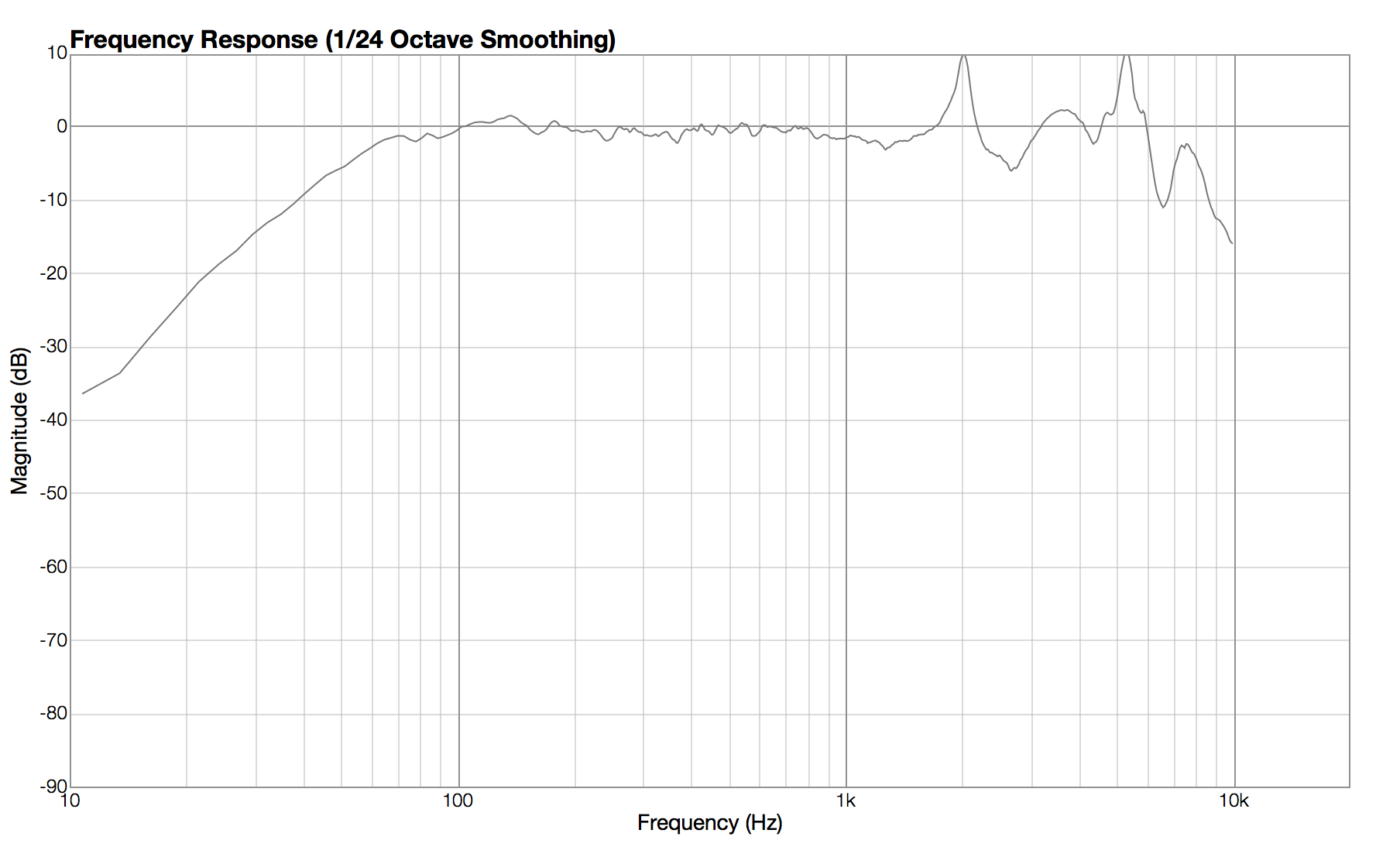

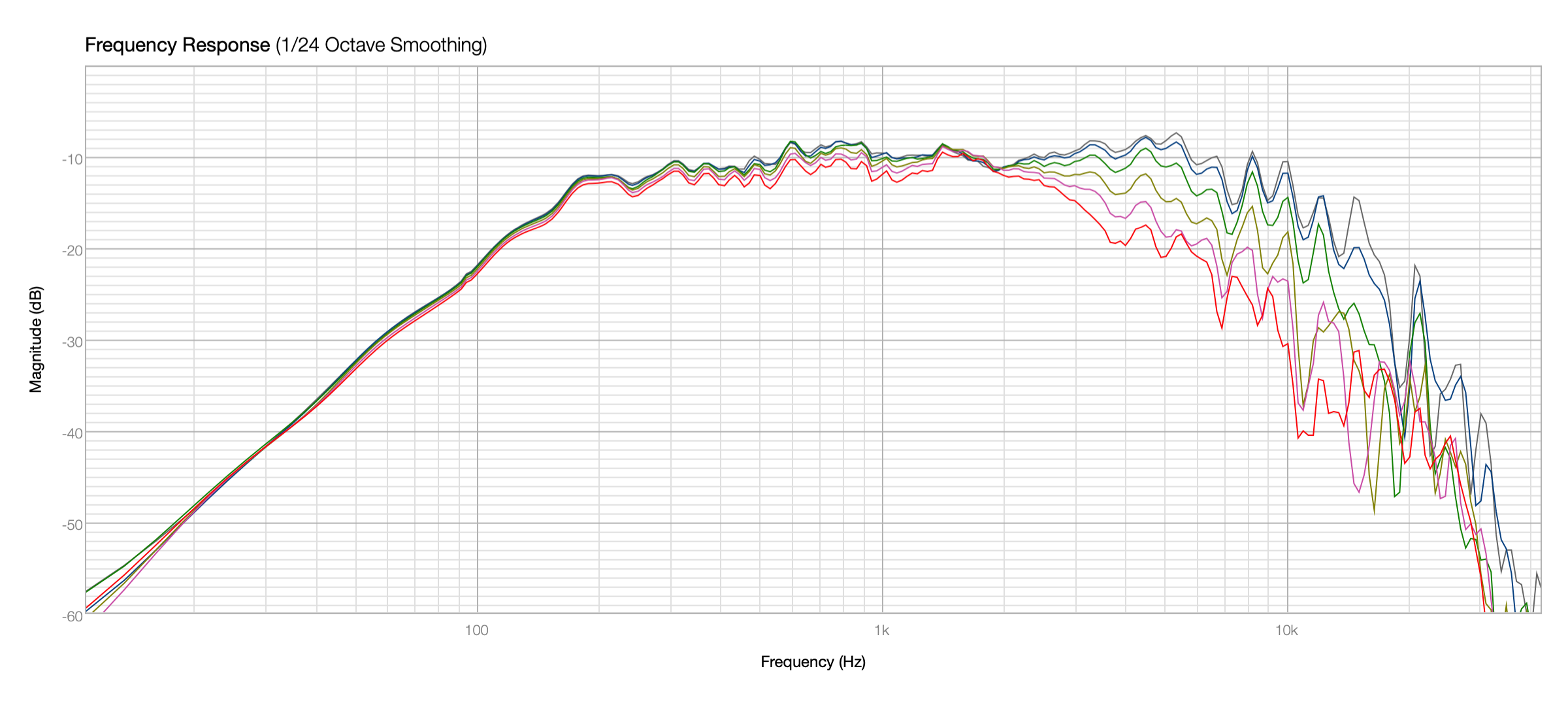

                      This was my quick and dirty polar response check for the FSL-0512, in a plain box. Obviously, some implications regarding crossover frequency and slopes-
Name:	FSL-0512 Polar 0 - 50 Deg.png

                        Here is the SB15CAC vs FSL-0512 ---- these are simple traces from manufacturer spec sheets. Its easier to compare if you click on the images and use the left/right arrows to toggle between the measurements.
                        Click image for larger version  Name:	image.png Views:	0 Size:	513.8 KB ID:	960310
                        And here is the Peerless:
                        Click image for larger version  Name:	image.png Views:	0 Size:	511.7 KB ID:	960312
                        • Efalegalo
                          • Jan 2007
                          • 162
                          And here is the directivity index of the SB15CAC (Blue - dotted) vs the FSL-0512 (Red - solid) ---- pretty much similar out the about 2.7Khz?
                          I suppose if you are crossing somewhere below that (e.g., 1.8Khz - 2.0Khz rage), then maybe the overall directivity index between the two options is not going that different?
                          I have the Peerless on hand. If someone is willing to ship me a single SB15CAC for some polar measurements, I'm happy to do it.
                          Click image for larger version  Name:	image.png Views:	0 Size:	124.0 KB ID:	960314

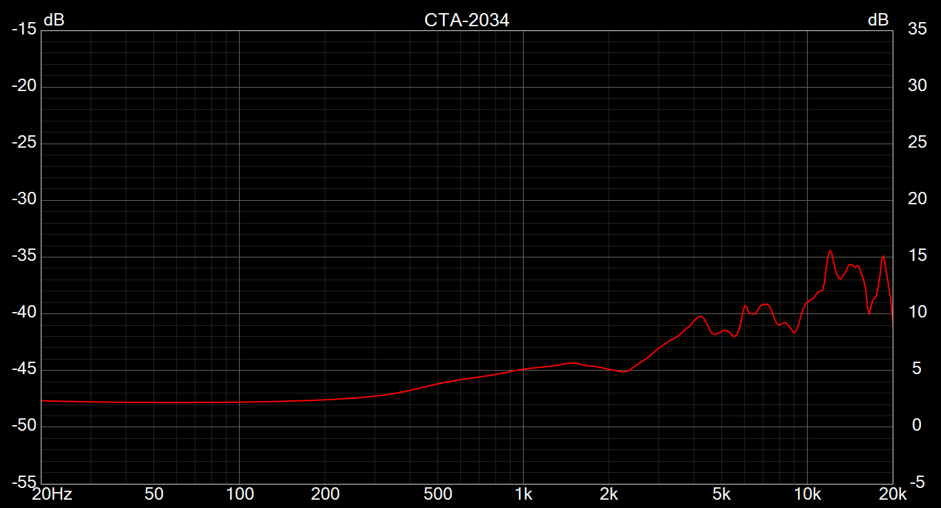

                            Of course, drivers of similar size will have similar DI, with only differences caused by breakup behaviour. Any sane designer will use the driver below the primary breakup region so those wild swings in response are well attenuated. That said, the view shown using manufacturer data is a lie as far as real-world DI is concerned, unless the design is for an in-wall speaker. First, response data all the way around the speaker is required, not just to 90 degrees, and then the DI through the midrange region will be defined primarily by the baffle shape, with DI increasing to 5dB level at 1kHz. Real-world DI in a cabinet can look a lot more like this:
                            To get a pulse on the effects of baffle shape and it's effects on DI, diffraction tool with directivity export will give some idea of reality for comparative purposes

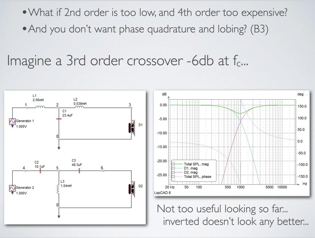

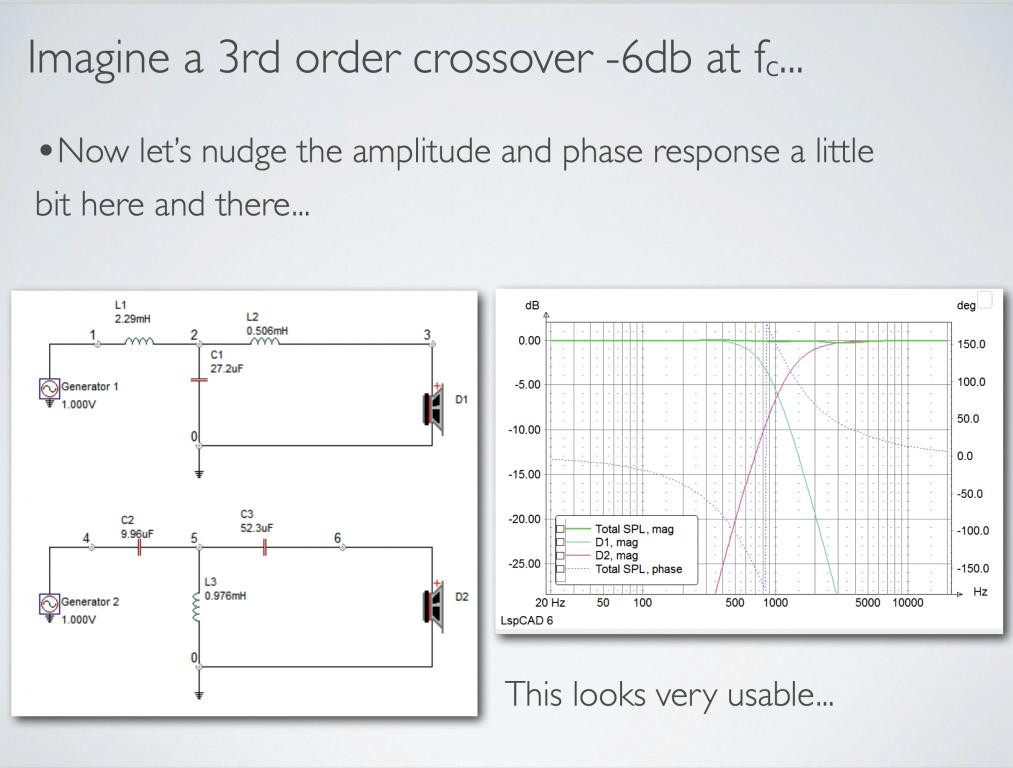

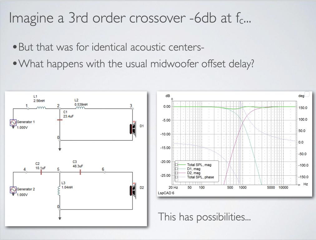

                                  And, if it helps, a re-post of my basic concept explanation for the LR3 - IMO the best Linkwitz-Riley Crossover alignment that Sigfried had VERY little to do with, other than the - 6dB concept (it's not a square function of a lower order crossover, and it's an odd over crossover.)
Name:	Imagine a crossover.jpg
Name:	Midwoofer offset delay.jpg
                                  Midwoofer offset delay is the difference in Z-axis origin. Front to back.
Name:	Crossover tweaked.jpg
                                  Three way is just an extension of the concept- of course, it requires a little bit of balancing of drivers with Z-axis offset in the right range, and usable response in the right range in consideration of the preferred crossover point based on the Z-axis offset.

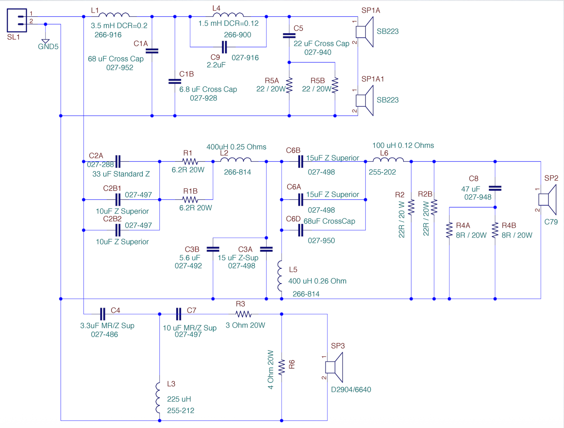

                                  Here is a Wavecor Ardent example crossover build with components available a few years ago. Refer to the Wavecor Ardent reference posts for more details.
Name:	Example Wavecor Ardent Crossover build.png
