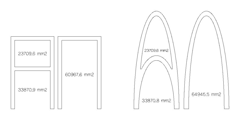

    building my 1st set of speakers and The Uluwatu caught my eye. But I would like build it with a twist as I own a CNC machine.
    1" plywood is the weapon of choice and I've been experimenting with some translam designs (while keeping the front dimensions and the volume the same). Presuming the square design is the worst one (but easiest to build) what's the right way to go? I've quickly sketched these:

    Any ideas?
    • 16077
    You might want to take a gander at Steve Manning's posts on the TTC cabinets- he's done the conventional translam approach in the past, but I pointed him in a new direction, which I'd suggest you consider, too, as it might remove a lot of the gut ache that people go through with conventional translam builds.
    So, from that viewpoint, we'd probably recommend something like you middle idea, but with some differences in the approach. Check out this thread for some details.

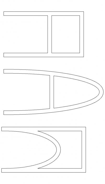

      By the "new direction" you mean the threaded rods and gaskets instead of gluing stuff together?
      I've played a bit more in CAD and found a design with almost the same volume but the question now is how much bracing do I need? As I have to account for it in the volume. Do I even need any extra bracing?

      Each speaker would consist of 39 "dual" layers and 9 "single" layers plus the full top and bottom pieces. Front would be probably also from plywood or maybe polished aluminum. Dunno yet.

        Yes. Steve has built translam in the past, and so have others on this forum, and others.
        A major problem with the conventional translam concept is that the materials are then asked to operate in a mode in which they are not strong. Nearly EVERYONE I know that has made a plywood based translam, for example, has had issues with layers delaminating.
        Consider the physics of the material properties- plywood has good bending strength, and good compression strength, but poor tensile strength in the direction of the laminations, especially when leveraged by the length of a sidewall.
        MDF has good compression strength, but is mediocre in all other characteristics, including material cohesion in the precedence of leveraged force to separate a joint. This is what happens in a Translam.
        I am not a physicist, but I play one on the Internet. (In real life, I’m a trained psychologist, but have just retired after working 35 years for an international semiconductor company as an engineer).
        But don’t take my word for it, experiment. Use the scientific method. The TTC concept is very, very strong. And reliable.
        Ask Steve. PM him.
