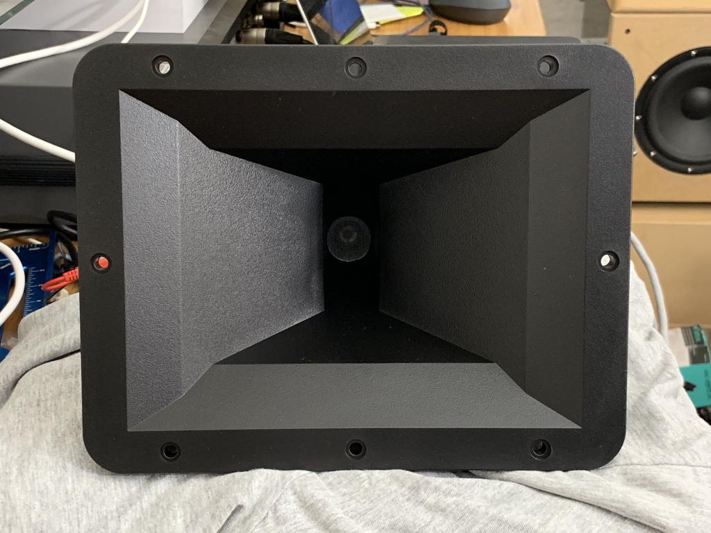

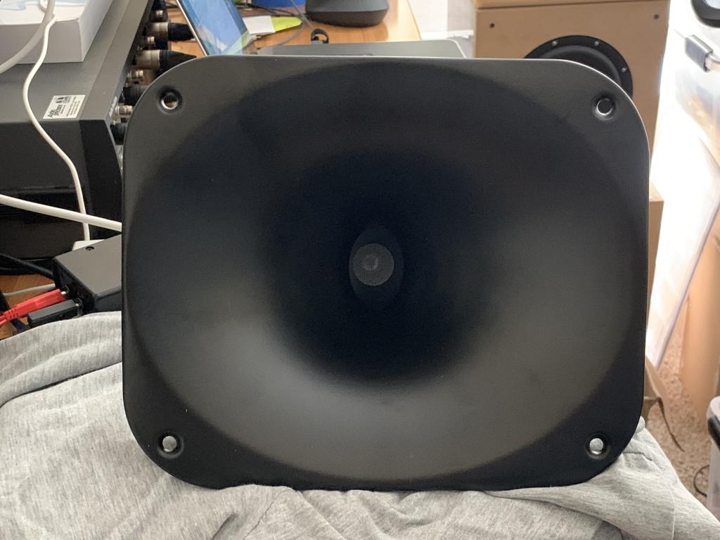

    New waveguides sourced from vendors on the Galactic rim have been obtained for evaluation... yes, it did require the use of “rebel” transportation services on the notorious “Kessel run”.
    This is also a 1.4” throat waveguide device- the plan is to test with the B&C DE990TN, one of the most advanced titanium diaphragm compression drivers on the market. This should be accomplished soon.
    There is the clear possibility of a cabinet design using a modified “off the shelf” subwoofer cabinet, for those who’s woodworking skills may be out of practice. This has been sourced and is in the process of assembly.
    Waveguide tests will occur much sooner, though...

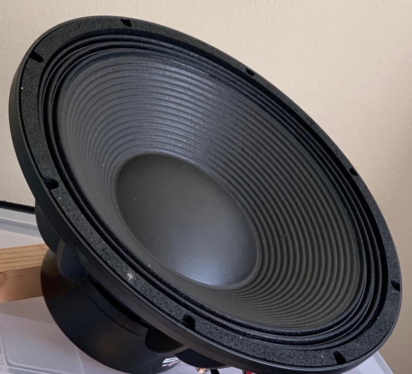

    For those who may be lacking in imagination for the nature of the other project underway, I submit these two images...

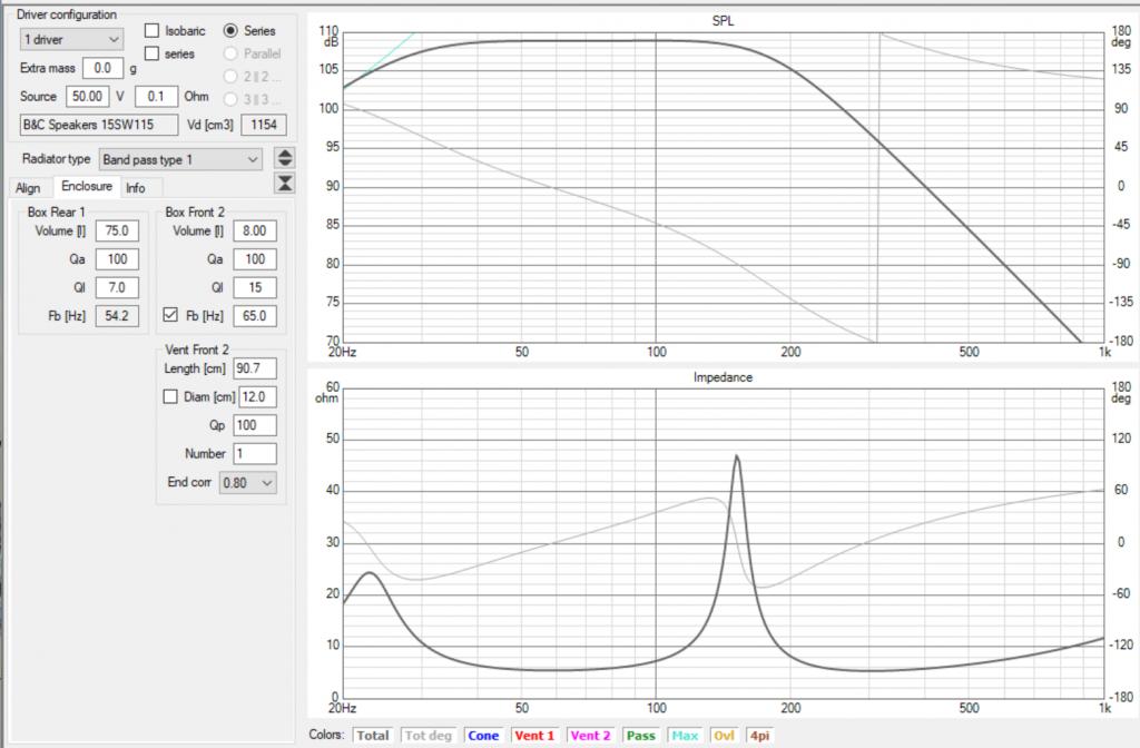

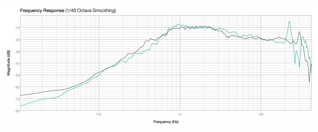

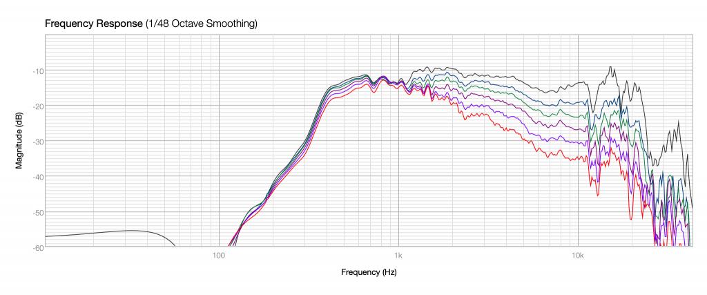

          They call it subwoofer, but look at response... A doublet might give more freedom with eq
          MX means motocross to me
            How one uses a tool is always the key...
            Your point about the simple box mounted response is well known... and a very typical characteristic of professional drivers, due to their very high BL product and low Qts, which are intrinsic to the goal of high sensitivity in this class. But there are other "darker" methods less well known...
Name:	15SW115 75L F3 25Hz 50VRMS.jpg
            which can bend the driver's performance to one's goals...

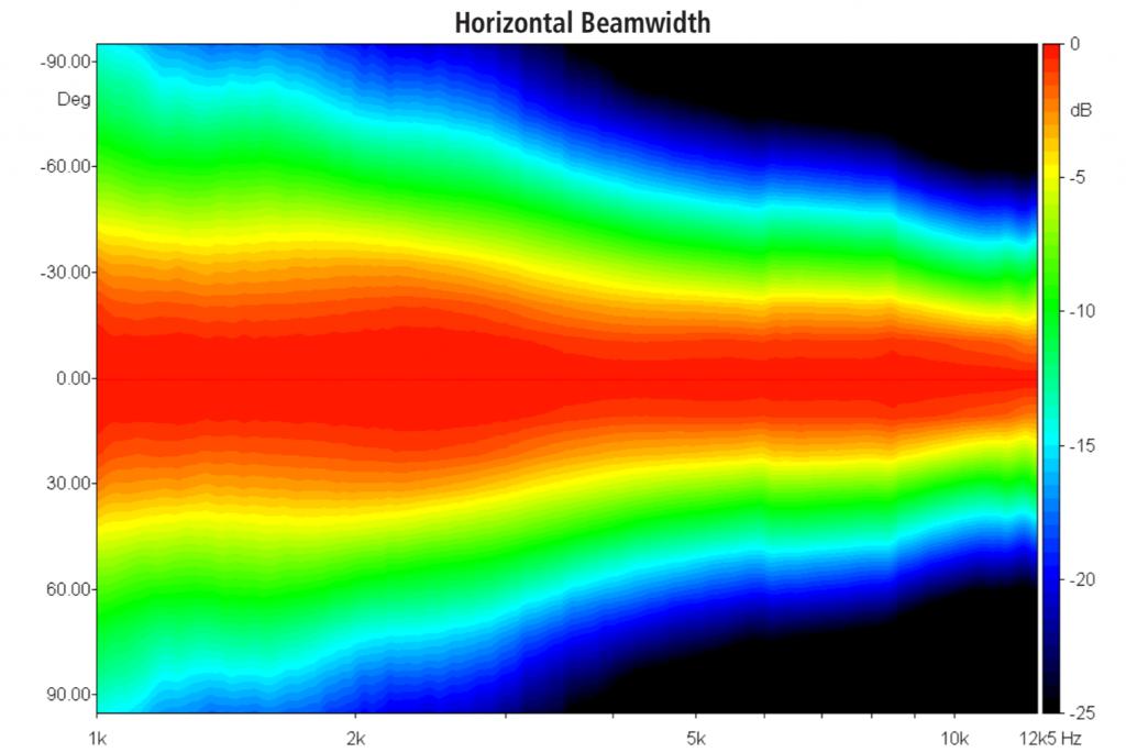

              One might learn by further study of authoritative source material- chapter six of Gedlee's book is a relatively accessible treatment including the contrast between the goals of horns and waveguides, and at it's conclusion postulates an (achievable) target condition for the relatively ideal condition of a polar pattern with smooth and consistent angular variation...
Name:	Fig 6-22 Smooth Polar.jpg

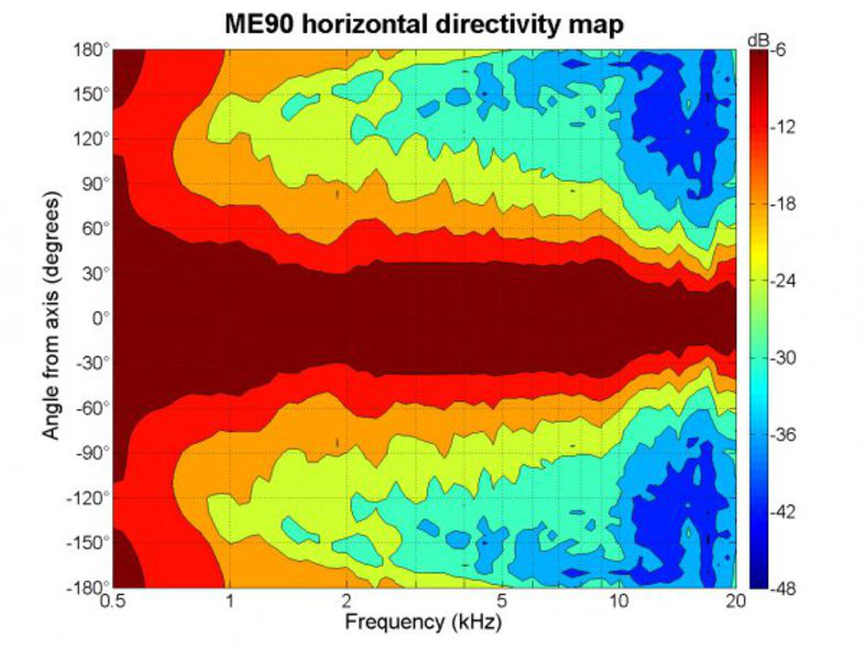

              How close to some devices achieve this characteristic?
              ME90 from B&C
Name:	ME90-DN990TN Pattern.png

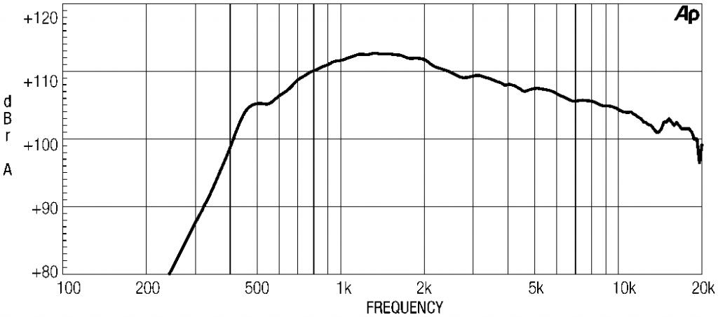

                  This is one of the better waveguide/driver combo's for a more constant result (..even if the driver itself was a bit "wobbly" on the low-end), from Brandon/Augerpro:
                  ..value-wise this combo is hard to beat for several reasons:
                  This Test Bench examines the first compression driver in the company’s new three model line from Peerless by Tymphany, the DFM-2535R00-08.
                  -I *think* the non-uniform "dip" off-axis between about 1.4 and 2.7 kHz is the result of the measurement condition of not being on a baffle for this waveguide.

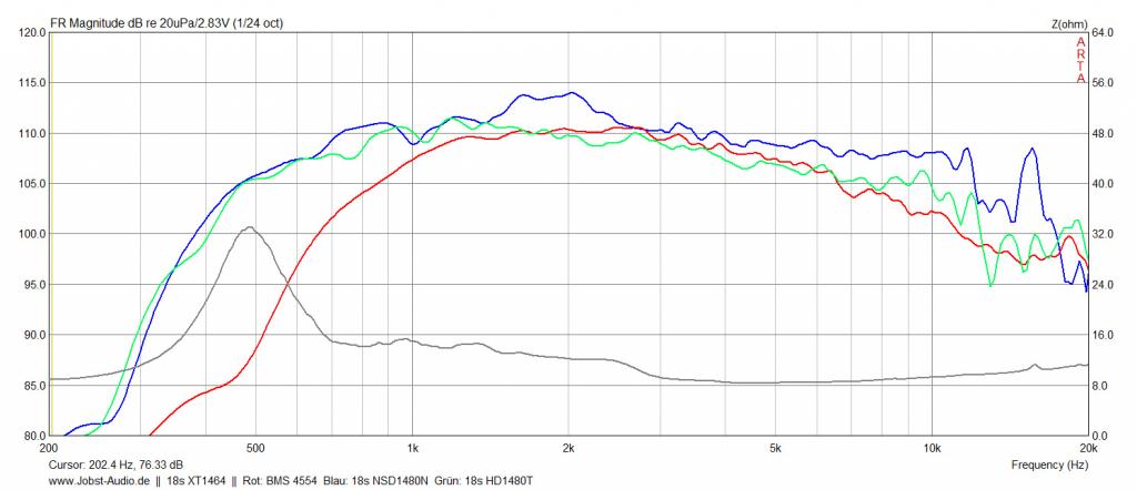

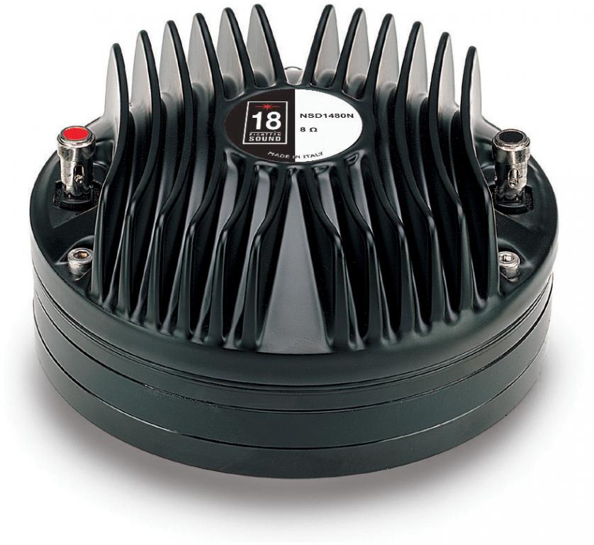

                                          Another 1.4" alternative from 18 Sound
                                          The ND3T and NDS3T are both quite interesting looking drivers, but so is the NSD1480N, with the nitride diaphragm coating for increased stiffness (raising the cut off frequency by about 25%).
                                          They are not easy to locate for retail sales, and not inexpensive, unless one is comparing to the likes of a ScanSpeak 7140 or similar premium tweeter.

                                          If the distortion performance is remotely similar to Kimmo's results for their premium 1" driver, the NSD1095, then this part should be interesting... very interesting!

                                            I agree this is a very interesting part- though after a full review of their offerings, I believe the NSD1480 would offer even further benefits in performance, though at a 25% higher price, and with fewer distributors carrying it.
                                            Kimmo has tested the smaller 1095 driver with excellent performance results, for those applications only needing a 1" driver. There is one experiment I have in mind for that configuration now... to test an unusual crossover configuration with low phase distortion and low group delay.

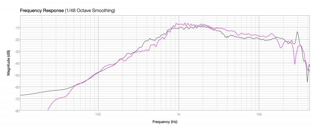

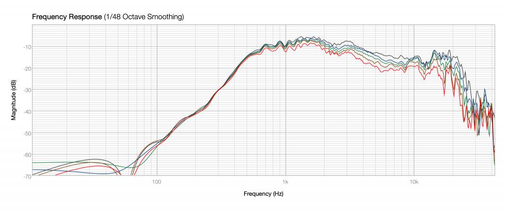

                                                  Testing continues
                                                  While the performance of the DE990TN so far seems fairly satisfactory, especially in regards to distortion....
Name:	990+ME90 0Deg Disto.jpg
                                                  However, though the Faital LTH142 horn may be similar in appearance to the 18 Sound XT1464, the measured results do not meet expectations...
Name:	KTH142-DN990TN_PolarSet FIxed.jpg
                                                  Whereas the ME90 performed as expected...
Name:	ME90 - 60dB-DN990TN-Update.jpg

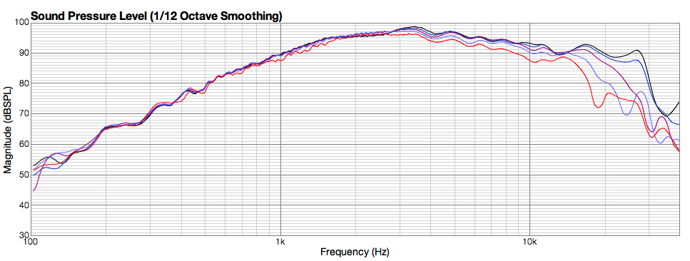

                                                        Note these measurements, all done by a 3rd party on the XT1464 for three drivers which individually are often considered to be fairly high performance....

                                                            One thing becoming clear is that the only test which is valid is the exact combination one is considering- evaluating a compression driver by itself is not possible.
                                                            Some interesting trends are emerging with well known brands... as well as some new comers.
                                                            Eminence SST1 with Peerless DFM2535 driver...
Name:	SST1 DMF2535.jpg
                                                            18 Sound XT1086 with Peerless DFM2535 driver
                                                            SDX10 woofer, XBL2 technology (higher sensitivity with long throw)

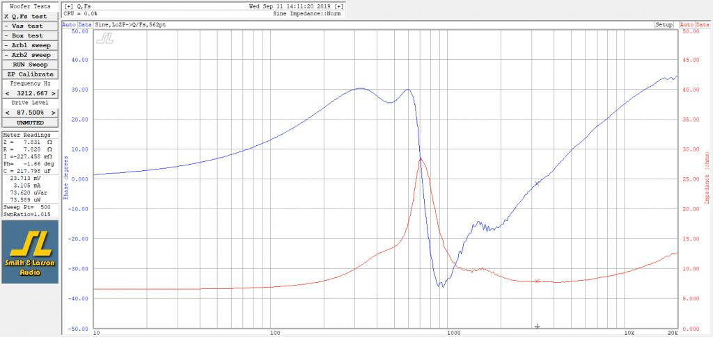

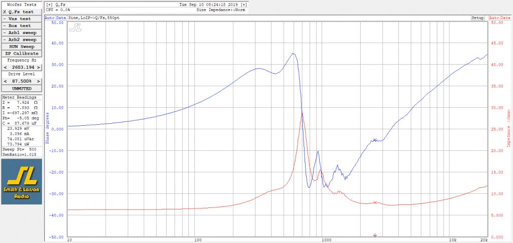

                                                            Interesting is to compare impedance curves of the same driver type on different design horns... the SST1 is something of a constant directivity diffraction horn...
                                                            While the XT1086 is a controlled directivity ellipsoid waveguide horn, quite popular with many builders, and for good reason...
                                                            Jonmarsh is too busy for this testing, but he had some interesting ideas for what he called an "Arvo Pärt Pro"... undoubtedly they would benefit from some dark side influence, though.

                                                                      More components arriving...
                                                                      Since the last update, additional parts for testing in large and small system have arrived, including the 18 Sound XT1464 horns, and the 18 Sound NSD1095 1" throat compression drivers, which Kimmo has tested with such excellent results.
                                                                      Note the key physical characteristics... they are shiny... and black.
