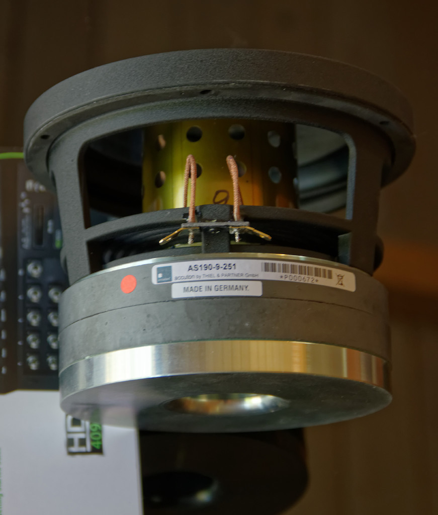

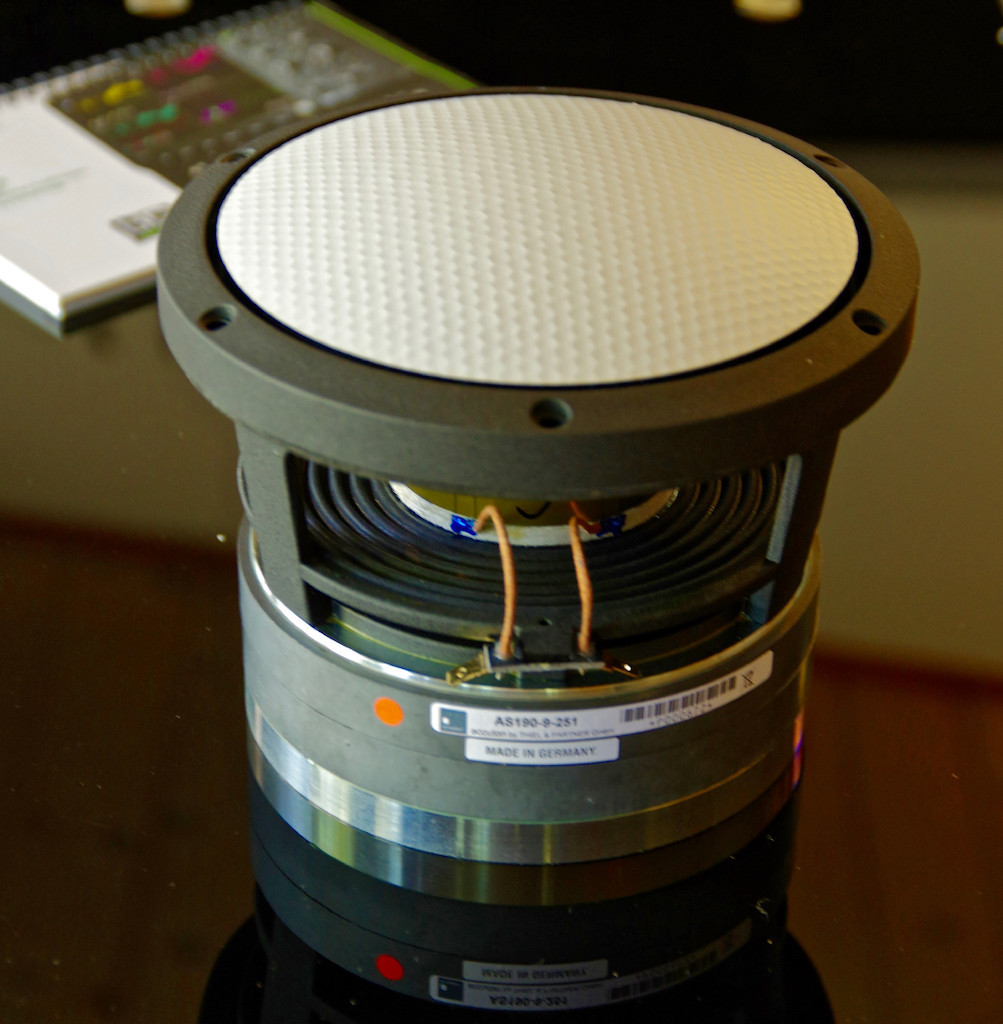

    The AS-190's arrived today as expected- boy, that was a heavy box! The magnets on these things look more like something you'd see on a 12" or even 15" sub driver.
    The main spider is where you would expect it- it's a flat spider, looks like it should be fairly high linearity.
    Behind the main diaphragm, which is driving by the large titanium voice coil, is a sort of inverted surround, attached at the edges, and seems to offer pretty good throw and centering also. you can just see it a bit looking at the upper right...
    The pole piece vent is huge, following in the tradition of the other cell drivers, which attempt to lower the backside obscuring due to the magnet structure. OTOH, I'd say one would want to rebate this driver pretty much flush with the edge of the baffle, and take some care in relieving the inside mount on a thick baffle. I'm thinking the ideal thing might be two layers of Panzer Holz, then very little relief would be needed and it should be quite stout.

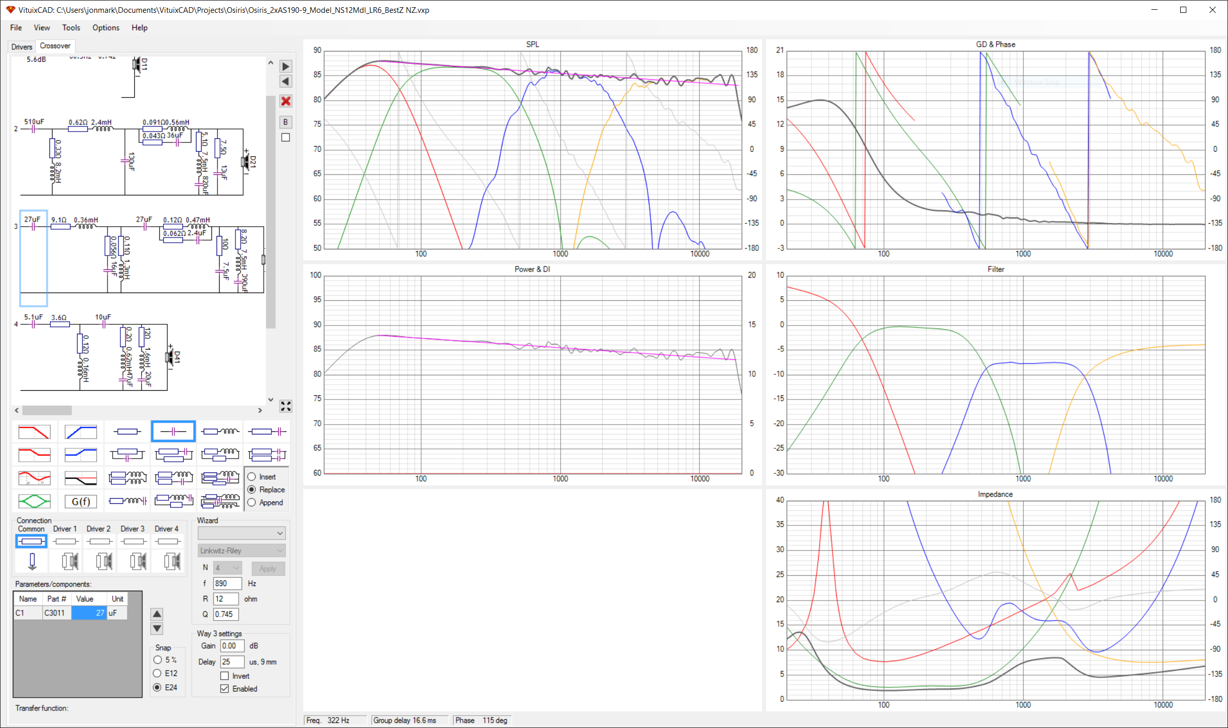

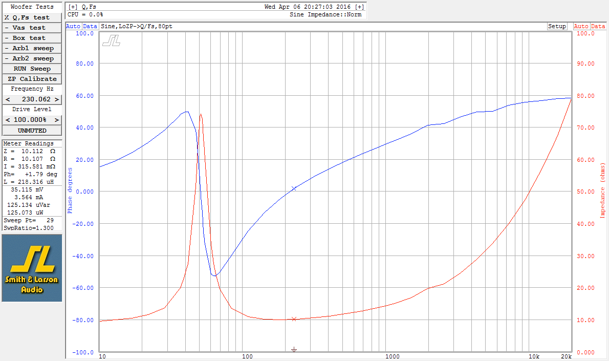

        It's almost 9 tonight... I've measured the impedance of the driver, and actually looked at the labels...
        Hmm hmm, that's the AS190-9-251, NOT the AS190-4-252 I had sworn I was ordering, with pleasure when I used the pull down box to select 4 ohm instead of 9 ohm...
        That's the screw up.
        Ok, so I start thinking a bit... hmmm, the 9 ohm driver is 85dB for 2.83VRMS; two in parallel will be 6dB more sensitive than one- and have 3 dB more output capability. So, 91 dB instead of 89 dB for the 4 ohm driver, and maybe even a smidge easier to drive.... plus that 3 dB more output.
        What's the old saying? If some is good, more is better, and too much is just enough?
        Is that the serendipity?
        So, I have enough drivers to test and debug one cabinet, making one mid bass test enclosure if I use two drivers. Might even be able to shoe horn them in side by side, as they are really 7.5" woofers, not 8" woofers. The end product would look a bit weird, but I think there may be a way to make it work OK. would look like dual headlights on a Toyota FJ cruiser, I suppose. Even mounted that way, the piston range across the cone diameters for omnidirectional output is about 400Hz, which works for the planned crossover.
        Sounds like rationalization to me, and that I don't want to let these drivers out of my hands and send them back to Madisound. I checked Madisound's site, and they show either version being a special order item now, 4 week lead time.
        But then that leaves me needing to cough up nearly another $2K. For another pair. Ouch. That's painful. Very painful. But then I have an Apple dividend payment that will be coming up in the middle of May. Should cover most of that.
        Patience, young Padawan... there is a reason for everything... even if it is NOT unfolding as I have forseen!

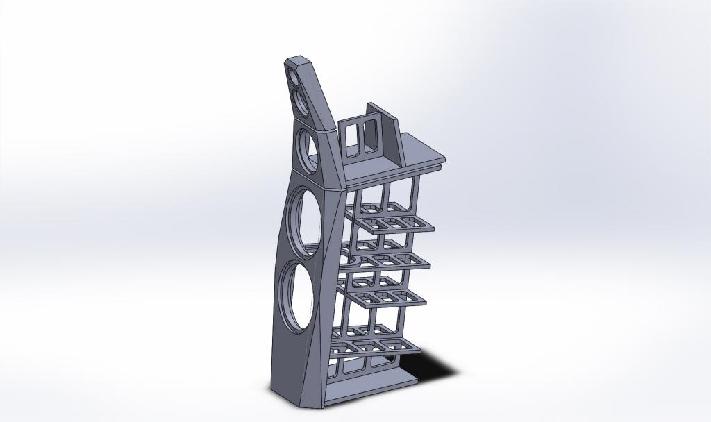

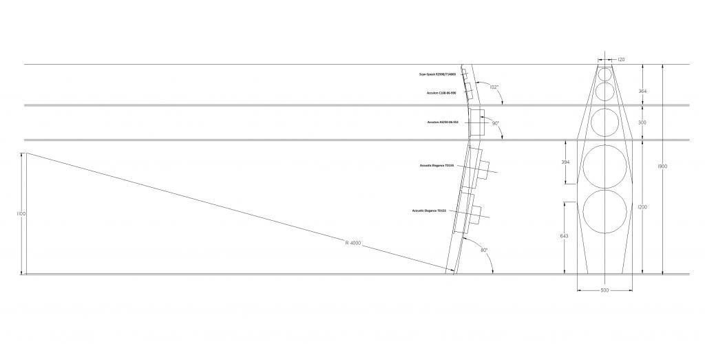

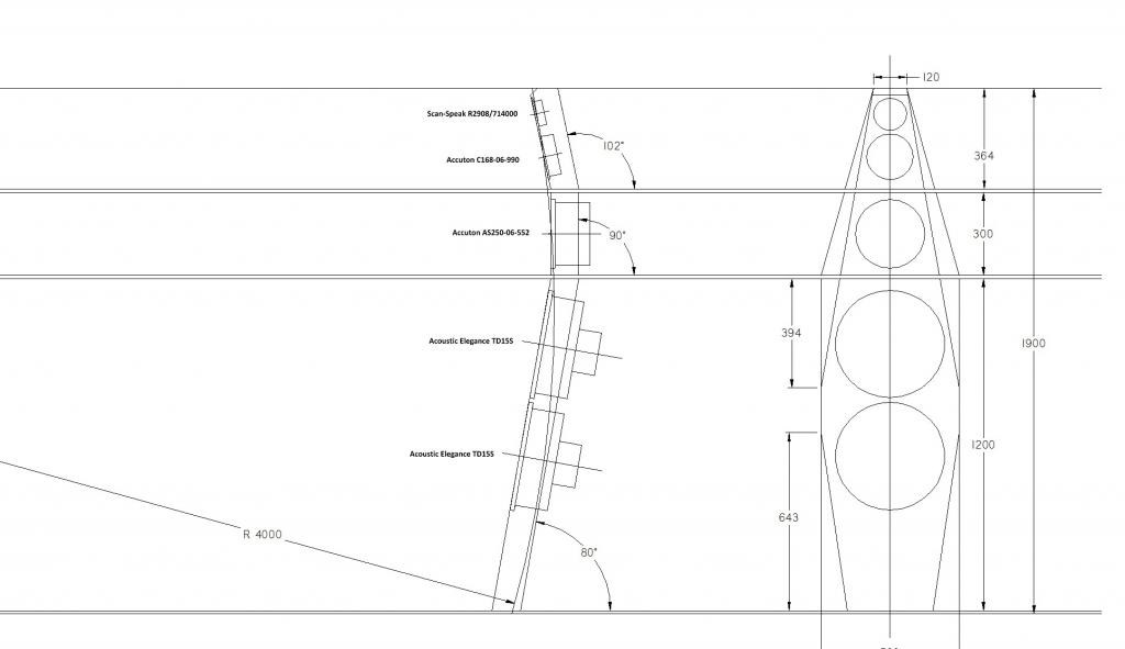

          In advance to a potential weekend of modelling the "big" version of these, see below for a theoretical Baffle layout. I have tried to align the acoustic center's exactly, but have ended up a little short of perfection... will have to correct electrically in crossovers. Just as a reference, acoustic center's deviate from perfect time alignment (theoretically) by 1.5mm, 0.5mm, 8mm top down. I haven't worried about the subwoofers as we can fairly easily alter these with the DS8.0 Amplifier...
Name:	MIC #2 Final Dimensional Layout.jpg
            Have you evaluated to make them a bit lower, perhaps 170 instead of 190, and instead go wider and/or deeper to get the wanted volume?
            How would that affect the timing, and the look? Maybe it's just me, but it seems a bit odd to have a couple of speakers that is actually higher than myself...
            • meb46
              • Jul 2010
              • 398
              TEK - I had a play around with heights etc... but ended up on these based on a couple of factors...
              1. I want the volume of the main Subwoofer cabinets to up towards 300L, which drives all dimensions to maximum possible without getting ridiculous - this requires in excess of 650mm deep, more like 700mm, which means this is a big enclosure. Overall, the aesthetic ratios during modelling look about right in my eyes.
              2. I am taking into account the build process and panel thicknesses of 25mm which create limitations to the height of the mid cabinet and upper. Not to mention the 25L required for the upper bass cabinet coupled with somewhere to put the passive crossover into.
              3. Lastly... I like the look of the current models and I think building on the aesthetics has merit... and I don't mind a speaker the same height as me

                  • 2140
                  [ATTACH=CONFIG]25569[/ATTACH]
                  Mike ...... do you have a bigger version of this that you could send me, it's hard to see the dimensions in this picture.
                  • meb46
                    • Jul 2010
                    • 398
                    Steve - See attached, this should be a little better...
Name:	MIC #2 Final Dimensional Layout - Large.jpg

                      Details missing as follows:
                      Width - 500mm
                      Spacers for Floor and between cabinets - 12mm (These will be Aluminum Plate). I am contemplating making the bottom plate 20mm Aluminum Plate to give myself more meat to thread in the feet.
                      Baffle - 100mm (Thinking either 4 layers of Horizontal Natural LBL Bamboo, or a custom lay-up of Horizontal and Vertical Bamboo runs)
                      Thickness and top Cabinet Slope - TBD based on volume calculations
                      The very top chamfer is incorrect, but will get ironed out in Solid-works
                        • 2140
                        That works ....... that's becoming a big beast.
                          Meb46:
                          This is actually happening? You are going to build these?
                          Are you going to do the building yourself? What finish are you thinking about?
                          (This is just so cool :-)

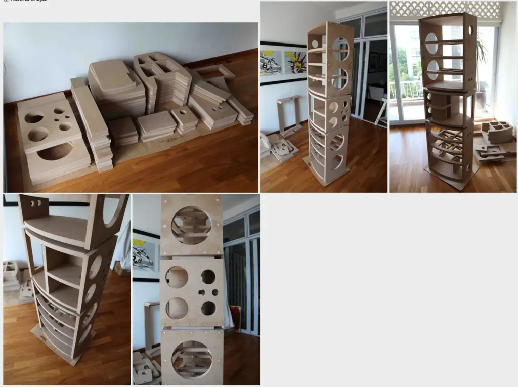

                            Oh yes, this is actually happening... remember, Mike is the only other builder of the Isiris, which were done using a vendor in Singapore for CNC work. But now he has his own CNC platform...
                            Remember, Mike had his own build thread....
                            And a very complicated MDF braced build:
                            He had some challenges with the finishing, but all's well that ends well...
                            Last edited by theSven; 21 February 2023, 19:18 Tuesday. Reason: Updated URLs for htguide
                              Yes, I remember the MIC build. Great project.
                              I did not remember the matrix construction. Very nice!
                              Looking forward to following this build!

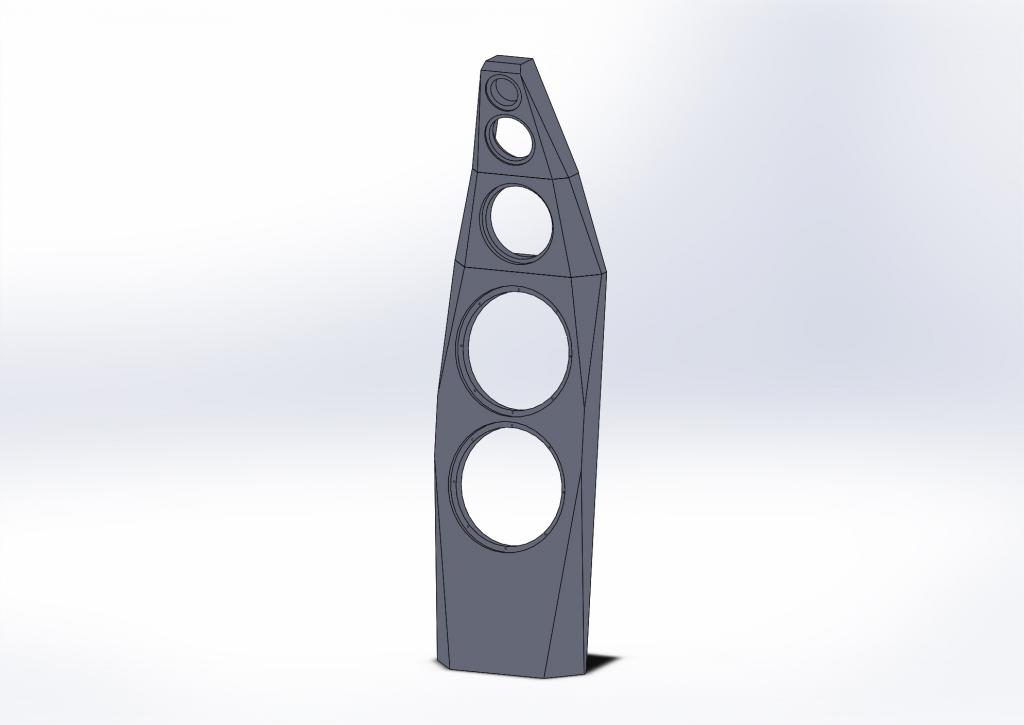

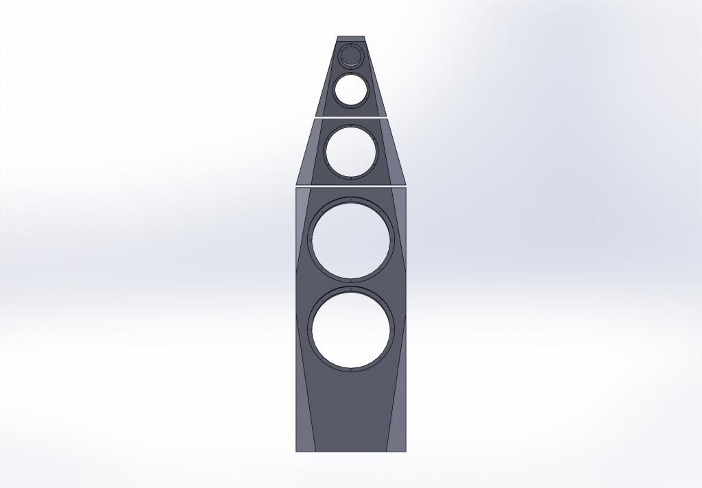

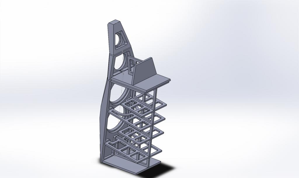

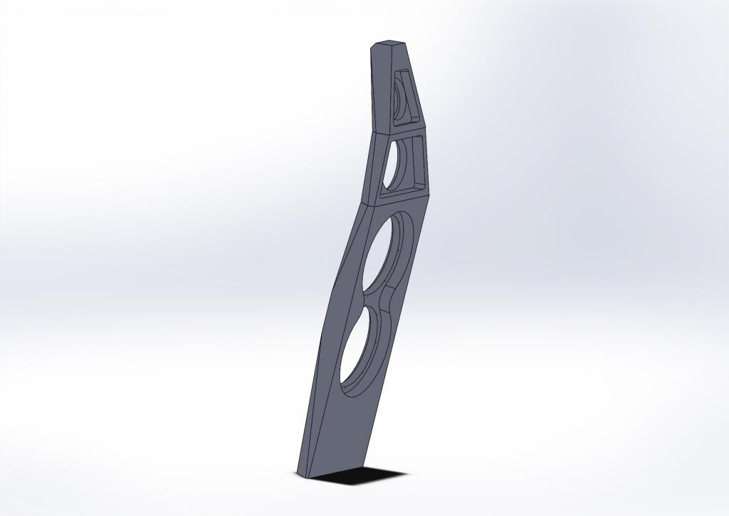

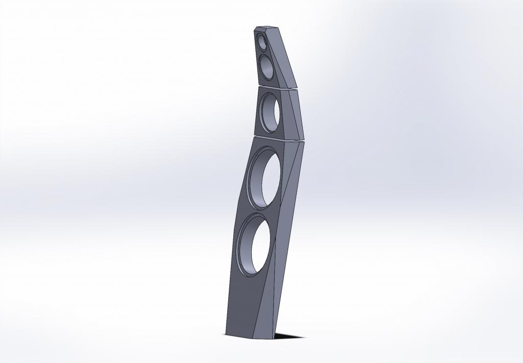

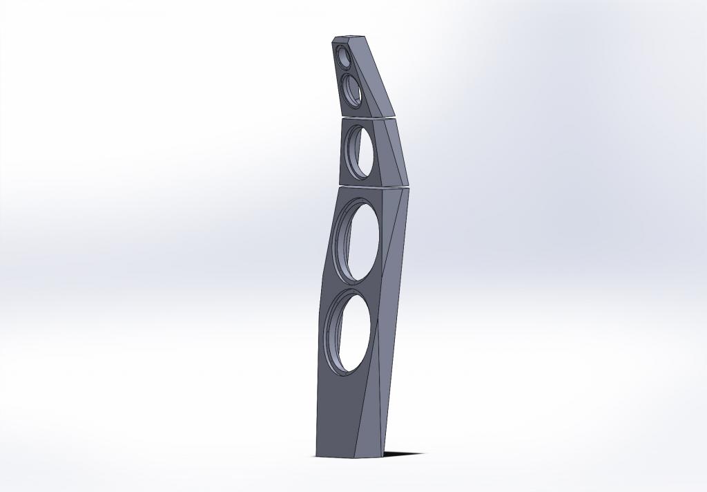

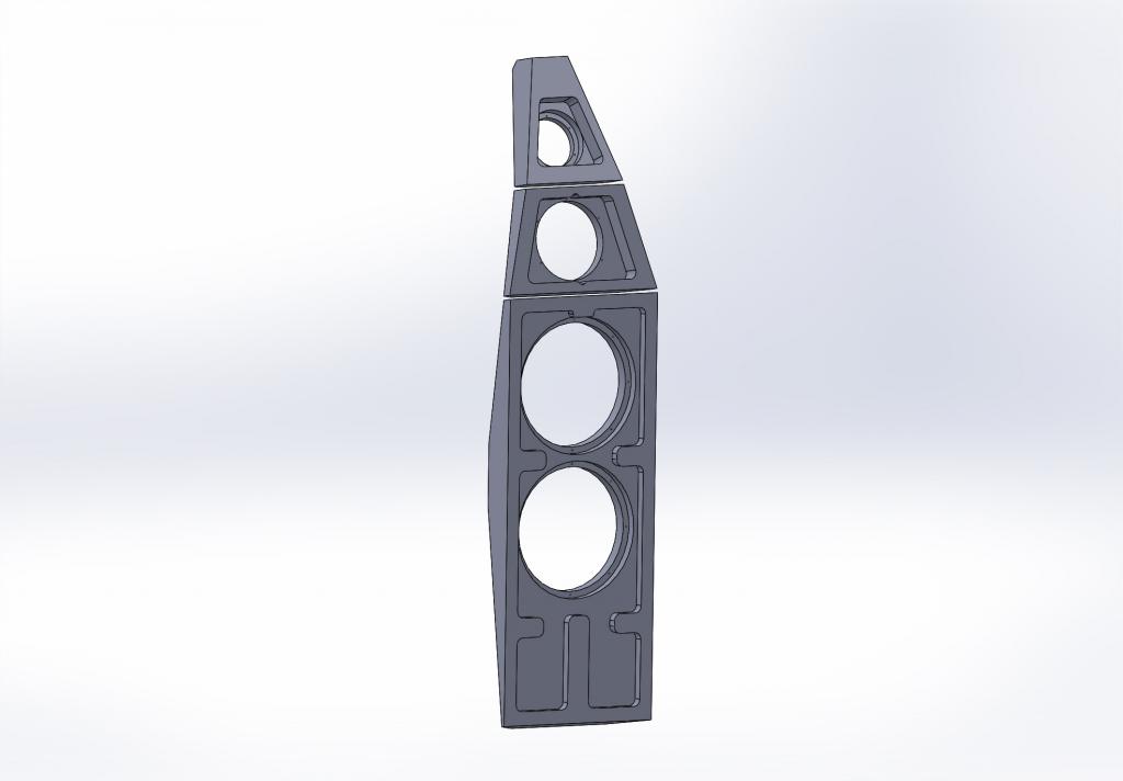

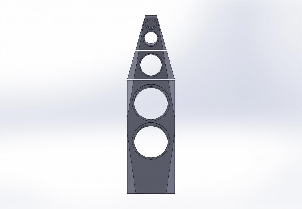

                                                              And so the late nights on Solid-works begins...
                                                              A few "in-progress" changes, but things are taking shape slowly. The top and mid cabinet chamfers didn't quite eventuate as planned... but still look good. This time on the rear of the baffles I am opting to machine clean perpendicular surfaces edges and not chamfer/tapered - The flared ones used in MIC #1 simply added hours to the machining time... this time its simpler, and still gives plenty of breathing room behind each of the drivers.
Name:	MIC#2 Baffles - Front.jpg
ID:	861668Click image for larger version
Name:	MIC#2 Baffles - Rear.jpg
ID:	861669Click image for larger version
Name:	MIC#2 Baffles - Side.jpg

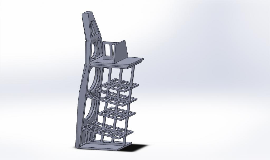

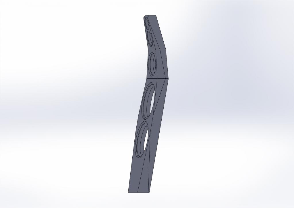

                                                                    • meb46
                                                                      • Jul 2010
                                                                      • 398
                                                                      Slight amendment in the profiles... Still have the rear surfaces to modify and also the Screw/Boss fitting on the driver mounting surfaces.
ID:	861673Click image for larger version

                                                                          So, considering voicing issues and the use of 2 AS190-9-251, I went back to VituixCAD and prepared a concept engineering update. Using the dual AS190, the net sensitivity is increased by about 2dB and the impedance can be a skosh higher in the mid bass section (that isn't seen here, as VituixCAD just connects the active powered NS12-513-4A in parallel with the passive part of the system, regarding impedance). This is just a proof of life, no expectation to be a final design, but it I don't see any big obstacles once I have new measured data.
                                                                          Next step is building the temporary mid bass acoustical test enclosures for evaluation. Parts are here, but have a pretty booked weekend already with Class D stuff and the Minvervas!

                                                                            Front Baffles nearing a first draft completion... couple of points to note:
                                                                            1. All Cabinets will have a single vertical brace connecting the rear panel to the front Baffle/Top/Bottom
                                                                            2. The Subwoofer Cabinet will have two horizontal braces connecting the sides, front Baffle and Vertical Brace, plus two smaller horizontal braces just behind each of the woofers that don't touch the Front Baffle... does all depend on volume depletion before finalizing
                                                                            3. The C168 is primarily vented through the back of the speaker where on a traditional driver design would be the magnet. This means I can limit the chamfer/flare required in the back of the Baffle
                                                                            4. I will most likely add a slight chamfer/flare to each of the driver mounts on the rear of the baffle, but this will be done separately to the models as I need to gauge the "meat" left in the Baffles after machining
ID:	861689Click image for larger version
ID:	861690Click image for larger version
                                                                              • 571
                                                                              Mike,
                                                                              Curious, will you have a brace between the two subs where the baffle is the thinnest?
                                                                              -Scott
                                                                              • meb46
                                                                                • Jul 2010
                                                                                • 398
                                                                                Scott, there is a horizontal brace that attaches to the two fingers at the sides in that area... Not directly to the thin part. One point to note, although it looks thin, remember the basic reference geometries, those are 15" Woofers, and what looks thin is still actually quite sizeable cross section. I will have another look at that area, but I think we are good. It's also going to made out of Horizontal Natural LBL Bamboo... Which should cover strength concerns...
                                                                                Starting on the bracing at the moment... Should have some first hits in a week or so... One big factor is the size requirement of the amplifier going into the sub cabinet. At the moment without bracing it's about 300L... And I don't want to loose much due to the plate amplifier...

                                                                                      Photos of the "Unobtainium" will have to wait today... instead some updates on the Enclosure models. Subwoofer Cabinet is nearing completion and currently has no allowance for an Active Plate Amp. This may end up being altered, or I may just keep the amplifiers separate to ensure I don't consume box volume - still to be decided.
                                                                                      Subwoofer Cabinet uses two larger braces to tie the Baffles into the main vertical brace. Section between woofers has been checked and confirmed plenty of "meat". I do not think this will be an area of weakness.
                                                                                      Bass Cabinet has a single vertical brace and doesn't tie into the front Baffle. This shouldn't be a problem as the sides are all 25mm and the front baffle 300mm high, so again, plenty of "meat" to epoxy the sides to the baffle and ensure minimal vibration.
                                                                                      Top Cabinet dimensions and angles in progress over the weekend!
Name:	Internal Bracing.jpg
ID:	861755Click image for larger version
Name:	Internal Bracing 2.jpg
ID:	861756Click image for larger version
Name:	Internal Bracing 3.jpg
                                                                                      • cochinada
                                                                                        • May 2014
                                                                                        • 661
                                                                                        Don't mean to criticize but rather give some constructive opinion: don't you think the vertical brace is a little 'hollow'? It's just my intuition but perhaps the holes should be smaller to give it more consistency.
                                                                                        Joaquim
                                                                                        DIY 4 way speakers.
                                                                                        DIY subwoofers.
                                                                                        Zaph ZD3C.
                                                                                          • 16172
                                                                                          Interesting question- certainly would be my thought if they were made of MDF. With LBL, things are a bit different. And perhaps there is some desire for weight control?
                                                                                          My inclination for the vertical front to back would be KISS, and that could be a near solid sheet of BB ply.
                                                                                          You have to work with LBL a bit to really appreciate how strong the good stuff is- it's like working with Maple. A piece of 3/4" MDF that I can easily snap across my knee in LBL would simply do so much damage to my knee that I'd have to see an Ortho guy afterwards... And the LBL would only be mildly annoyed, certainly wouldn't be broken...
                                                                                            • 2140
                                                                                            [ATTACH=CONFIG]25723[/ATTACH][ATTACH=CONFIG]25724[/ATTACH][ATTACH=CONFIG]25725[/ATTACH]
                                                                                            Drawings are looking good Mike ...... what software are you using?
