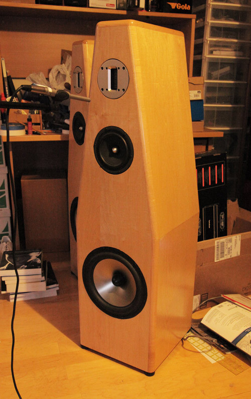

    Here's my 3 ways I adopted for cheap and finished up. driver list:
    crossover:
    meniscus audio model crossover attached
    I don't have anything to measure these with ops:
    I'm buying a tascam US122 mk2 + emm-6 mic and setting up REW so I can measure stuff in the future, or maybe I'll get the Dayton omnimic kit, I'm not sure yet.
    but I've heard what a speaker should sound like and the midbass is severely screwed up on these.. a pretty big suck out. What I want is to abandon the concept of a 3 way design, and I want to abandon these cabinets (they were basically thrown in for free so don't fret... they have a lot of design flaws)
    I want to move to a 2 way passive crossover with active subs
    parts express is having a sale on sub cabinets
    http://www.parts-express.com/pe/show...number=302-843 x2
    I'm going to run ALL of this sealed. For sub amps I don't know what i want to use... I'm thinking about the new Peavy DSP amps which I assume can do some higher low pass filters?
    I will then have a new model crossover developed that I can crossover lower since I'll have a PROPER distance between the tweeter and midrange in the Dayton cabinets
    any thoughts on what amp to get? or how viable this is? thanks

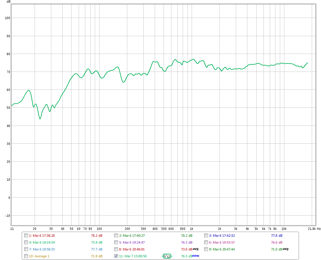

                    Try measuring a little further back, on axis with the tweeter, and without any boundaries nearby. Do you have any bass traps or thick insulation laying around? If so, pile it up about 1' tall(or up to the woofer) between the mid and speaker, it'll help with floor bounce cancellation.
                      FYI, 2.5ft^3 is optimum for a ported enclosure, so leave it sealed. A sub enclosure behind your mid will help it's low end.

                        Edit: Also did the mid woofer IN phase and it improved... woofer response (starting right at 350hz!) takes a big dump though

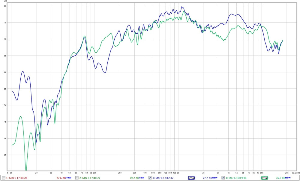

                            Here it is with a bunch of 1" sonic barrier foam from parts express piled up to the woofer. also pointed directly at the tweeter and measuring a foot and a half away

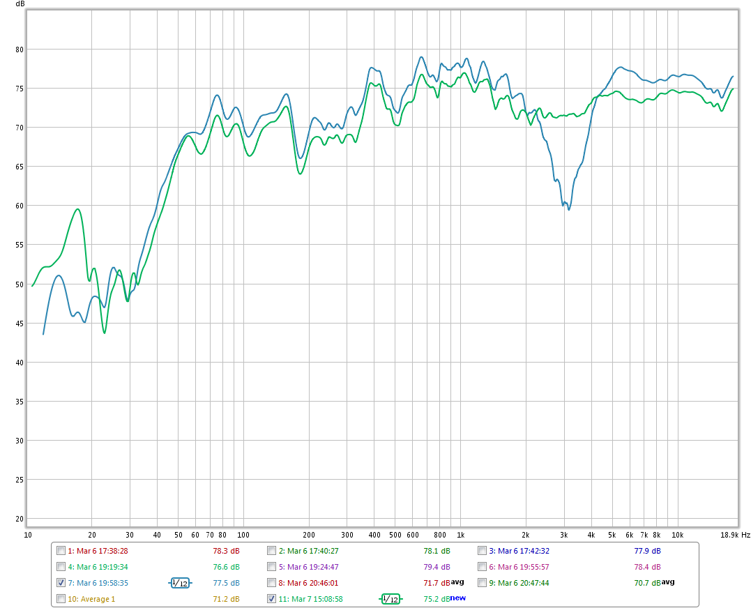

                              Now invert the tweeter.
                              • omegaslast
                                • Feb 2011
                                • 12
                                Wow.. why did that get it so close to flat?! :E
                                Here's a comparison
                                If I stuffed polyfill into the woofer chamber would it increase the volume of the woofer or no? Right now all it has is some very light fiber glass from meniscus... from 350hz down its the only thing that goes out of the +/- 3db. I forgot to mention this but the woofer cabinet is only 1.5 cu ft... I'm guessing I want it to act larger than that?
