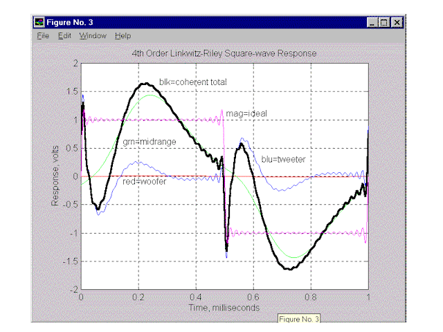

                                                                                "Energy storage" is simply a matter of the transfer function, i.e. the frequency response of the filter. It's identical whether you do it with small caps in a high-impedance active circuit or with big caps in a low-impedance passive circuit.
                                                                                Linkwitz-Riley lowpass plus highpass circuits give an allpass sum which cannot accurately reproduce a square wave.
                                                                                    Well, - nothing can reproduce the square wave accurately. The L-R approach is good enough in this regard. We are only concerned with below 20 kHz here, so a slow slewing square wave is fine, as long as the settling is well behaved and your graph shows that.
